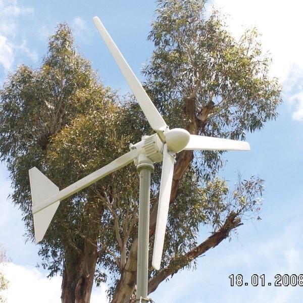

Hi, has any one played with one of these chinese wind gens. I've purchased one off ebay to see what they like. It seems to spin very slow for the quoted 24 volt charging ( manual says 400 rpm) yet the blade pitch is very shallow. When I run the machine into a 48 volt load, it appears to be a lot better ( starting up, charging at lower speeds, spins more consistanly with the wind speed etc)

it probably works better at 48v becouse it dosnt see the load until it reatches the load voltage.
when connected to 24v batteries load it will load quickly and therefor stall the gen.
my neighbour has a similar unit from china only worked for a short while then the controler stopped working. the mill seems fine but.
the blades look ok, are they pvc?
the neighbours are pvc and do work quite well
the gens seem to be ok although i have read in this site someware the bearings can fail or slip easly probably worth replacing with fully sealed quality ones and locktight into place.
i havnt stripped on apart but you could probably mod the unit with stronger magnets also keep away from trees and wind obstacles as much as possable

The blades are fibreglass coated timber. I've resanded them, taking the rough casting edges off and repainted them.
The bearings have already been replaced also as part of some the work done on the machine after reading elsewhere that they fail early.
The gen only in the test position before it goes into its final higher location. Its easier at the moment get it up and down for adjustments, testing etc. as the final location is going to most likely be 60' in the air. (if the unit comes upto scratch)
Currently using a Tristar TS60 shumt regulator and a 3 phase diode bridge after testing the orginal supplied regulator and found it to be very ordinary in performce and also seeing some of your members also discarding it.
One of the tests that I done was to measure the OC DC voltage in about 5ms of wind and it measured at 120 volts.
You probally right about the magnets. When I had the gen apart for the bearings, the magnets didn't appear to be any of these good neo's etc, they looked to me is if they are ceramic or similar ?
IF anyone any info or thoughs on these units, please post a reply.

Back with some results. This was taken with the wind speed around 4.5 ms (wind speed measured with a hand held aneometer and power measured using a electronic DC load)
volts Amps Watts
25 0.1 2.5
30 0.5 6
35 0.5 17.5
40 0.8 32
45 2.0 90
50 2.5 125
55 2.5 137.5
60 2.2 132
65 1.2 78
70 0.6 42
75 0.15 11.25
80 0.1 8
interesting readings when the generator is meant to be a 24 volt unit.
Regards Bergen

Well, your "electronic DC load" does not mimic a 24V battery, does it now .
BTW, the wattage in the second measurement should read 15.

I might suggest that a mill in the wind is a very difficult test apparatus.
I assume that the electronic test load is basically a variable voltage clamp, like a variable battery. The load presents no load up to the set voltage.
The plot indicates blade stalling at the 24V level. Are you sure the mill is not designed for 48V? The open cct voltage of 120V is a giveaway to suggest a design for around 48V.
I am not fully familiar with this wind mill.
I have seem packaging for other chinese mills and it would be easy to get the wrong voltage unit.
There would be no point in replacing the rotor magnets unless you could utilize the higher voltage. The cut in voltage would effectively be even lower. It is difficult to rewire this type of generator.
Do you have the option of changing the system voltage to 48V?
cheers, Gordon.

Thanks for the comments. The generator was sold to me as a 24 volt unit, and it come with a 24 volt regulator, but when it was temp installed, it was haveing trouble charging a 24 volt battery.
Then I changed regulator (after seeing some forum members having faulty units and looking inside the unit it looked very ordinary in design), it still had the same problem.
The electronic load unit was set up as a battery eliminator (as per Gordons comments) except the unit was set at each of the voltage steps (ie 30 volts = a 30 volt battery) to find the gens best output at a given wind speed.
48 volt is no good to me at the moment, due to the way the rest of the system is set up.
This morning I've pulled the unit down and seeing if I can get the windings out to see if a rewire is possible.
Thankyou All

Also from my last post, I've managed to get the windings out (after a little work to the houseing) and it can be wired for 24 or 48 volts.
It looks as if it can also be wired for 12 volts with a little modification to the windings.
Still investigating and testing at the moment.
