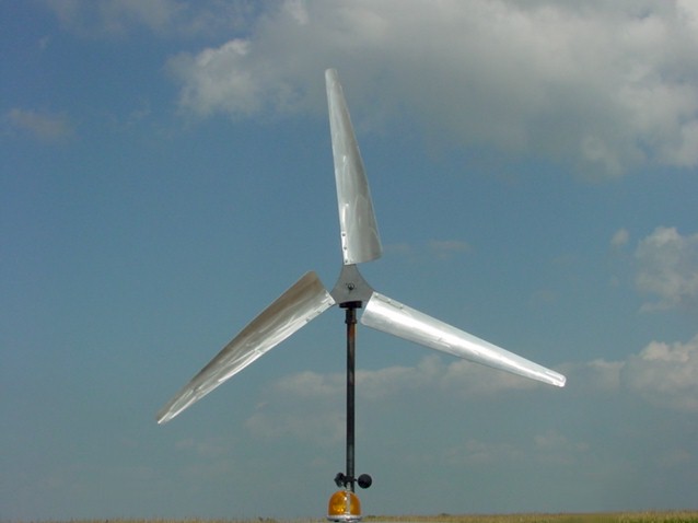

The generator, from a rough guess, seems to follow the voltage and wattage profile of Ginlong's GL-PMG-1000 model. The magnets are not as angled as the picture makes them appear. I took a motor apart and they are at the same angle - about 11 degrees.
I have my eye on an 8.5' rotor from TLGWindPower.com. I have a picture of it here
I have to figure out how I am going to put together a 30' guyed-tower and talk to my neighbors. The last part may be a problem.
