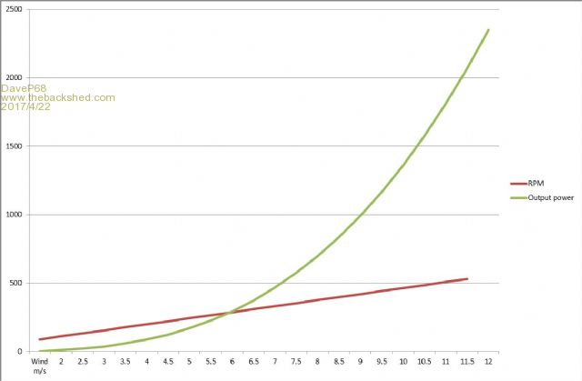

I have an idea along the lines of, what ever PMA is used they have very predictable electrical characteristics (When load matched). I other words if you let say an F&P stator operates as a constant current output device, then the voltage & RPM values will remain proportional as they go up & down.
This is a big clue as to how these "Wind Power Grid Tie Inverters" are able remain in control over wide input voltage range (30 to 540 VDC in this case).
The only variable left is the power curve of the wind turbine blades over their operating RPM range (cut in to peak RPM).
Refer to the graph below of a projected power curve from 3 m diameter blades in 2 -12 m/s wind speed. The corresponding RPM range is 80 - 530 which will be proportional to the PMA output voltage.
This fits perfectly with an F&P stator(s) operating with an output voltage range of 80 to 530 VDC. Believe me I know the exact configuration that will match this voltage range very closely using 3 stators on 1 shaft to get up to 2.4 kW peak.
The "Wind Power Grid Tie Inverters" have 40 point programmable, linearly extrapolated power curve, via inverter display, to match the output of a specific wind turbine.

Posted: 08:15pm 21 Apr 2017
David,
You are quite right, the great unknown is the actual turbine (diameter, pitch, number of blades). That, and the characteristics of the PM alternator produce something with very fixed and repeatable curve, but an initially unknown curve, especially for a completely home brew combination.
A "magic box" might be able to optimize loading similar to a solar perturb and observe algorithm. But if the wind is gusting, it really has no hope of following the action, and may go into a speed surging instability.
That is the problem with any feedback system. It says oh sh*t !!! and then applies too much correction, then has to recover. Then repeats.
A feed forward system says o/k we are seeing 4.35 m/sec at this instant and we will pull XX.X watts out of the machine at that exact wind speed, because that is what my lookup table says it can do.
That may be slightly less than is possible, or the blades may slightly stall. But its going to be a stable condition.
A small anemometer can accelerate and decelerate very quickly, much faster than the rpm of the main rotor. So the power output can be very rapidly modulated to follow fast gusts and lulls, without the main rotor rpm having to change.
So you generate a table of numbers to match your green curve exactly. Wind speed versus output watts. And it can be made absolutely any shape, with as many correction points as you wish to have.

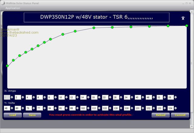

Have a look at 'Hugh Piggott's' site, and 'Kitestrings' posts on Fieldines.
Both have tamed the Midnite MPPT, and the Tristar MPPT, controllers for their particular Wind Turbines, and have given their MPPT points settings to us all for duplication.
There settings are interesting and could be used on a self made arrangement, but boy it would need to be bullet proof.!

Darnned if I can find Hugh Piggott's MPPT settings. I know it was on his last website, as Morningstar sent him a MPPT controller to test, and I feel sure Hugh published his settings for his big Wind Turbines, but where?
Searching quickly on 'Fieldlines' on what I can recall....
Stuff from... 'Flux', 'Chris Olson' and 'Kitestrings'.
http://www.fieldlines.com/index.php/topic,148468.msg1031191.html#msg1031191
http://www.fieldlines.com/index.php/topic,148063.msg1026343.html#msg1026343
http://www.fieldlines.com/index.php/topic,145104.msg984085.html#msg984085
The below is Chris Olsen post on the Midnite Classic settings.
http://www.fieldlines.com/index.php/topic,147278.msg1016449.html#msg1016449
