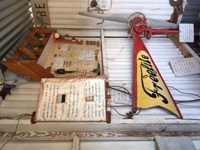

Sorry I can't help, but thought I would post a picture of one I saw on my last trip into South Australia. It is in a shed/museum in the abandoned town of Beltana in outback South Australia.
Hope someone can help.

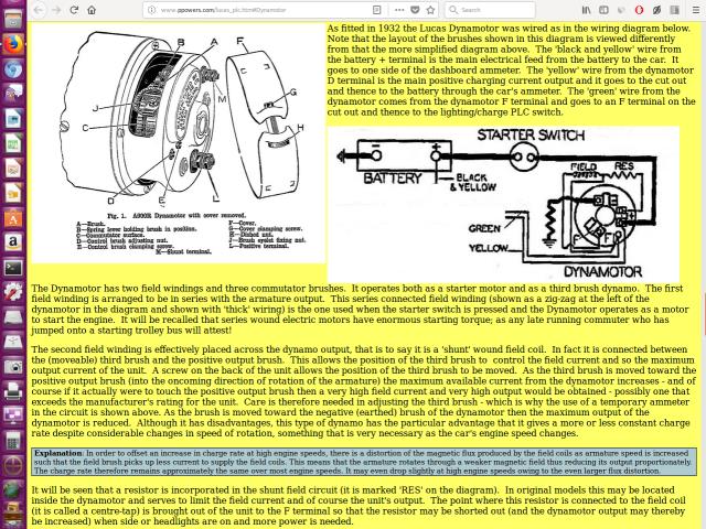

Lucas A900R Dynamotor
about 1/2 way down the page has some info on how it works by a guy who has one on his
1932 Morris Cowley.... you may be able to track him down and contact him for more info?- try his homepage?

Its a weird beast, its both a starter motor AND an generator in the one unit...
Dont know about later models but the wiring diagram I found is a weird setup- its a constant voltage, constant current output apparently- with an internal field resistor inside, and an external one- usually fitted to the headlight switch(probably the one on the outside of his case) that basically increases the current output when the headlights were turned on....
I didnt find it at first as I was searching for generators, and lucas list this as a dynomotor, apparently bosche and several other companies made versions of it- and more surprisingly they are still used in some volvo marine motors as well (suppose its cheaper than a seperate magneto charging circuit if you are going to put in a starter moor, might as well use it for charging too if its only light loads light running lights and the like for small boats

Not many would have come across these before Madness, the A900R is a strange beast indeed- its not a standard dynamo aka generator, its both a starter motor and an generator in the one unit. They had a combination field winding, part of which is dual duty for both functions. It apparently doesnt use a regulator in its standard configuration, with basically only two output levels- low and high amps out, set by changing resistance in the field windings. Add in the three brush system they normally had, and many auto sparkies (even the old schoolers) would be struggling to figure out how it works, I'm still not exactly sure myself as there is very little literature about them around (and I been in the field for thirty years, did some of my apprenticeship playing with gennies, but they were pretty rare even back then lol)
Add on this has probably been modified for use as a wind genny to boot and i's a big ask, any autoelec could probably nut it out eventually, they arent that complicated, but as a paying job would be $$$
If they know its history as a combination dynamo/startermotor (hence the dynamotor tag) it would be a lot quicker to decipher its workings- for many that didnt know its original use would spend a lot of time trying to figure out what and why they had the extra heavier windings in there etc, add in no original regulator (that may have been modified in its new role as a wind genny) and you have a real cludge of a beast lol

Ahha, those springs are just the tensioner for the carbon brushes, they do provide some current path but most of the current actually goes through the rectangular brush holder that holds the brush in place ie spring with brush holder on left
I was thinking of the resisters that they had (usually one internally and one externally) look a bit like a piece of fencing wire in a coiled spring like this

When used as a dynamotor there was originally one inside that connected to the + brush and went to one of the field windings, and another on the outside that went from the F connector to the headlight switch- these may have been removed in the conversion to a wind genny, dont know (I doubt the internal one would have been 'accidentally' removed, although the external one is a different matter- it just connected to the + battery connection and could have been disconnected/lost during the years)
They may have been removed during the conversion as they reduced the charging output, they may have just ran it flat out at all times, there still has to be some kind of external field reg tho, even if it is just a wind activated switch on the tail as some had, as it would otherwise draw field current from the battery when there was no wind and flatten it
Problem is I only have very limited info to draw on for them as a dynamotor, and only 'if I ran the zoo' ideas on what they could have done as a wind genny, they werent the most common beast around in their original role (only a handful of early cars and vans seemed to use them) and altho they 'look' like a generator, internally they are quite different (kinda like a generator and a starter motor all mushed up in the one case, some bits working in both roles, some bits only as a starter, others only as as a genny, add in all the stuff I have found suggests they only had a very primitive regulation system (pretty much low or high current output, at fixed rates).
