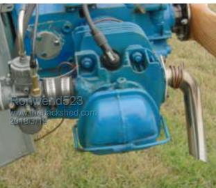

Ok I'll try clarify some points. I have no room for a mag on the rear of the 1/2 VW engine. I am running a standard VW distributer which will run for some time on a small battery but when the battery is low it would need a charge up on the ground. There is no starter on the engine. It is prop started. I have thought of the small lawn mower alternator which is basically a permanent magnet motor. I'm not sure of how I could put a pulley on the back side of my prop hub. I have experimented with a 3" squirrel cage fan housing, attaching small brush type motor( not sure what it is) to it and blew air from a shop vac backwards thru it. It produces about 11.5 volts at unknown amps into a 12v lithium battery. Now my thoughts with something like this setup is to run a 2.5" flex hose inside the engine area to the front behind the prop, catching the prop wash and spinning the squirrel cage mounted inside the cabin area. No drag created on the plane. The charge would go to a charge control and to the battery keeping it topped off with charge. This plane is a Home Built design but the engine is up to the builders discretion as long as it is of a certain HP for the model being built.

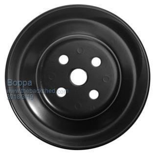

Stupid question, is the prop on the crank pulley end of the motor or the flywheel end?
either way there should still be access to the shaft, surely some system could be rigged up to get a pulley onto that shaft, or even mount something like that little permanent magnet alternator directly to the shaft with a custom made adapter?
