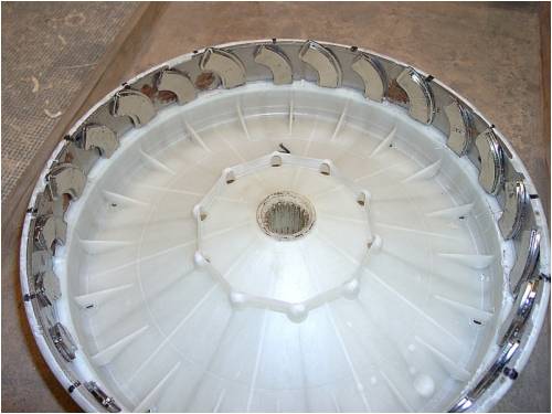

I just wanted to post and tell everyone about the F&P I've been working on, since I have not heard of this being done before. I have rewired my motor to 7 phase 2 pole and used my old hub, but replaced the magnets with hard drive magnets piled 2 high, and placed in the 48 magnet new hub pattern. they stick right onto the laminations on the hub(I have not glued them on yet). These hard drive magnets are far stronger than original F&P magnets. I just left them whole(N&S on each face) and placed them on end onto the laminations, this makes a slight skew, as the magnets are curved. It seems to work great. there is no cogging and I am able to power a 1.5A bulb and a 1.5A fan easily by just turning with my finger. I have yet to permanently place the magnets since I want to do some testing for placement and power output, etc.
I must say it took a while to take apart all those old hard drives.

I would be happy to post a few pics. Anything in particular you want to see? I will assume the magnet placement on the hub is what you are after. Check back in a day or two.
spiral
Joined: 06/05/2008
Location:
Posts: 12
Posted: 08:38pm 07 May 2008
Here are a few images of the magnet hub. I placed the magnets with the hub on the shaft so I could see where to line up the magnets so they were in phase with each stator coil, and used a brass
rod to position them. I hooked this up and it spun at about 250 RPM without anything(glue) holding the magnets in place. They didn't move a bit. At this point I need to get a larger ammeter to do a bit more testing. I may have to build a piclog now. By the way thanks for the site and all the info. I love to tinker with DIY energy
projects. I felt like I won the lottery when I found a F&P machine here in the states, they are not easy to come by here.

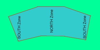

I've just tested some hard drive magnets and found on the flat face that faces the stator, They are not all one magnetic pole. Mine has one pole in the middle with the other at each end. Are yours the same as mine? I suspect so.
HDD Magnets
If so this magnetic configuration will not work as both magnetic poles are adjacent any one stator pole pole at the same time. It will have magnetic attraction to the stator laminations but will not cause the flux to flow through the coil and this is what induces the current to flow.
I can't think of a way of using these magnets unless they can be cut. I'll leave that for you to explore.

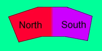

I have tested some magnets from the voice coil actuator of a hard disk drive, that look very similar to the ones you have used and they all have a north / south through the thickness orientation at one and the opposite polarity at the other.
The ones I tested had curved inner and outer edges. They were not flatenned like Gills' picture.
The ones I have would work. .. .. Gordon.
edit.. One thing I have noticed on your layout. The magnets are not a very good shape to suit the F&P rotor. I expect that the output waveform may be a little strange.Edited by GWatPE 2008-05-10

The magnets I have all have the north/south poles on the same face. They do work. My testing has just begun, but I

That they have "north/south poles on the same face" is not the problem as such, it is where these are located on the face that I see as the problem. I think Gordon says his has the poles at each end. I am surprised as I have several HDD magnet types here and they do not.
For those considering a similar modification, it may pay to check by sprinkling some iron powder or fine iron filings above the intended magnet and seeing if you get the twin arrangement I have identified.
If this happens, better go look for spiral and Gordon's single type like I am.

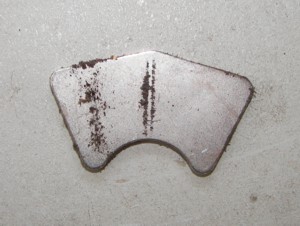

I use a needle to find the pole of the magnet. Filings tend to stick to where the field is concentrated. My method is hold the magnet in one hand and the needle in the other. Hold the needle at an end. Move the other end of the needle over the magnet surface of interest. The needle will align to the magnetic field.
The hard drive magnet shows a distinct null between the two poles. The needle will jump from pole to pole. The needle tends to centre in the area I have shown on the picture marked N and S
I think you will find that the line the filings make is not a pole. .. .. Gordon.

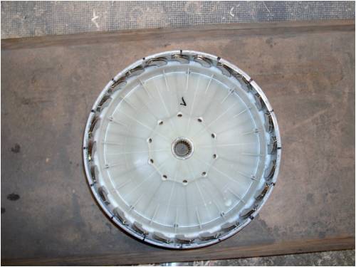

I set up a makeshift testing station today, with some adjustable belt configurations, and added some loads to check output. What I had laying around were 3 floodlights that are 12V 18Watt, and 1 fan 12v 1.58A. The F&P spun at 200 RPM and with all three lights hooked up I got 12.25V and 4A. The lights were at full brightness. I then added the fan and with all 4 working together I got 9.5V and 4.5A. The lights were a bit dimmer with this setup, but all 4 were working fine.
I don't really know what RPM is an average but 200 seemed
like a good place to start.
Do you guys have any testing tips that might help beyond this point. I have a charge controller for some solar panels that logs amp hours but I don't know if it can divert the load or if it only shorts it. I would hate to ruin it.
I tried to set up my multimeter and hook it up to the computer(It has a program called meterview, that is essentially a scope) and I was able to get it to log voltage, but then my computers battery died and needed recharging, so I didnt get very far. I also dont know how to hook it up to get a proper reading. Do I isolate one of the phases? Perhaps you folks could help with that.
All the hard drive magnets I came across have a N/S pole on each face, with the center being the dividing line.
I would still like to try to skew the magnets a bit more
to eliminate any overlapping of the poles, but they had a natural tendency to position themselves where they are in the photo so there they sit.
I do not know what a regular F&P output is so I dont know if this arrangement is better or worse than usual, but I am pleased enough so far. I can charge batteries with that.

I did a little more testing, and got slightly better output, but not much. With the three lights hooked up I got 16V and 5A at 200RPM, so about 80watts. It sounds like this is around half what normal output is. Not what I was wishing for but it does work.
I tried some different magnet configurations but the one in the picture gives the best output so far. I did notice that my air gap is quite large compared to the factory hub, and will try to either add another magnet or build out the laminations with another layer.
