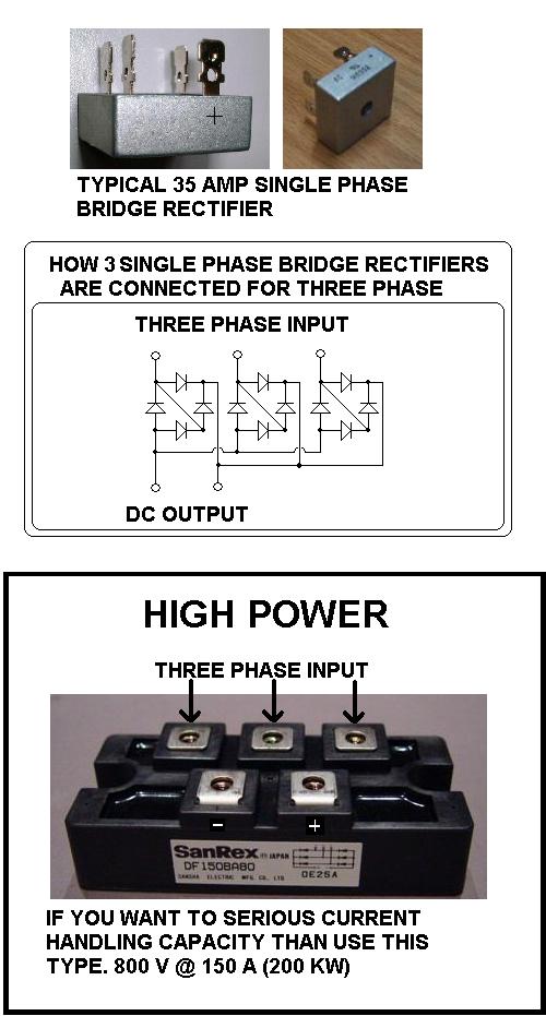

I am wondering why you are planning to wire your stator for two poles? I enjoy poly-phase alternators and can help you make the proper connections to rectify them. I can also help with dump load circuits. But first I drew up a diagram showing how to hook diodes up to form a rectifier. I recommend using diodes like the ones shown. You can easily take some aluminium bars and drill and tap them so that you can screw the diodes into it. The aluminium acts like a heatsink and also allows you to add more wire connections up to it. Be sure to keep the diodes on separate pieces of aluminium because the exterior metal casing of the diodes are conductive. A high current homemade bridge made with the diodes shown will take tons of abuse and last a long time. It is also cheaper and self satisfying.
You can find these diodes at: http://www.surplussales.com/semiconductors/diodes-3.html

As you show some excellenct drawing of the diodes which is good and help other to understand the system and also very much simpler many metal workshop use Mig welding ,plamsa cutter all use diode setup as you shown and many diode can be brought from welding repair shop as sparepart or find one at scrapmetal yards as some of mig welder thrown out for newer model

Dude if you want the rectifiers just go to jaycar or dicksmith and buy some 35A rectifiers for 5 bucks. No big deal.

Finnaly a picture of where I mounted the bridge rectifiers.
http://www.members.optusnet.com.au/~taara/mill2a.JPG
