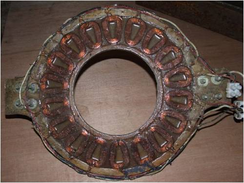

just a small bit to add...
when i spin up the axial alt by hand you can feel a very slight resistance when its wired in delta...if you spin it up with one connection open and then touch it to make the full delta you can see a slight spark...i,m pretty sure these are the so called parasitic currents delta can allow
probabely only a few watts but enough to make me go back to star (what it was origionaly designed for )....

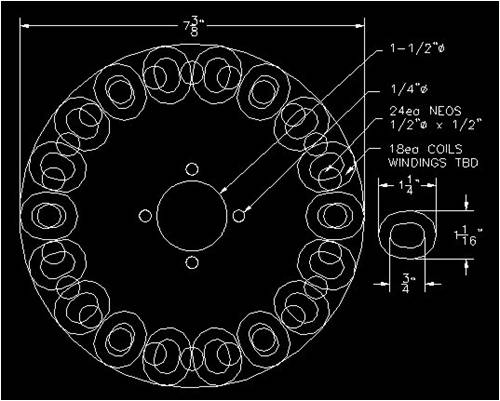

I'm sorry Bob, but we appear to differ again.
Begin long tedious ..... whatever..
It is obvious that you have the theory well in hand, for classical alternators, but the practical asect of axials is just not there.
With the dual axial a lot of effort is used to shape the field, involving large quantities of heavy steel to provide return paths for the flux...in fact it can be empirically measured when coil testing, just how much difference air gap spacing can effect the field concentration. With a twin disk axial, there is no discernible change in EMF regardless of the distance one places the coil from the magnet face.
This indicates a field of relatively even intensity from one magnet to the other, of uniform strength, and matching the magnets shape. Testing with a single disk, shows the complete opposite, and that the induced EMF in the coils is very much dependent on the distance from the magnet face. This means in a thick coil, all sorts of things are happening.... but it is the coils shape in both instances that dictate the waveform. If we wind the coil to suit, it seems to come out very close to perfect.
I used round coils with round magnets. By changing the coil's hole diameter, I could induce the square shapes or peaky shapes or as perfect a sine as I could tell. If the hole size reasonably matches the magnet width, it seems to be a so close to perfect sine wave as to not matter. It IS the coil geometry that dictates the wave shape. The field shape is a given for the design, from there it is simple coil manipulation which changes the wave from square to peaked.
The comment was brought about by Nials observation. It is not mine. I can hook my axial up as star or delta on the test bench, and spin it by hand and it spins down very slowly in either combination, star or delta. It generates voltages in excess of 50v with a hand spin, and has a R of somewhere near .7R..(published here somewhere I have forgotten exactly now). and in delta is only about .23 or thereabouts. There is no discernible drag which in your numbers is "To put some figures on it. If the alternator is generating 30V, third harmonic is 20% and winding resistance is 0.5 ohm then the circulating current will be 30x0.2/0.5 = 12A. And that is just one phase." I think I would notice 50x.2/.23=43A...for just one phase....it would spin like a brick. This just does not happen in the real world of dual axials.
It IS the coil geometry that will dictate the wave shape. The field is very consistent and well shaped with virtually no leakage... so it is the coils shape and hole size that will determine the wave.... period. If you wish to argue this, then build one and find out yourself. It is not hard. I have done it and seen it as have many others.
If you use rectangular magnets and oval shaped coils,(as Hugh Piggott does) then it gets messy, and it is much harder to get a true sine wave, and you can wind for square if your keen. Hugh is a strict Star person (father of the modern axial flux), so does not bother with waveform..... (he also burns up stators in his larger machines like the Nirvana, so Delta loses are not at fault..... but high R star is.) I suspect Nialls is of the Hugh design with rectangle magnets and oval coils.
The hand placed coils in the axial are prone to be improperly centred and aligned as well. It is not an exact business. As a consequence. non-symmetry is almost a given unless your very careful. If non-symmetrical, then the phase angles are incorrect, and roughly 120 degrees is about what we get... you can guess the rest..... for an axial it is symmetry and geometry that dictates the wave shape and phase angle. We are stuck with the field shape and have to work within it's constraints. Another problem with rectangular magnets, is that most have to wind the coils ovoid, or triangular(ish) to fit the inside of the coils into the diameter as it diminishes towards the center, and this means the geometry of the coils does not match the geometry of the field... here you should get wave distortion.... but it does get surprisingly close to sine.. ( not as good as the circular ones though)
Once you start to generate above cut in, the harmonics start. The non-linear qualities of the diodes produce hash on a royal scale.. here is where the harmonics get very noticeable, and Delta starts to become less efficient. As we increase more power, the wave gets flattened by the batteries low internal resistance, and we get crest factor exactly like when we rectify and use big capacitors on the input to offline PWM's.... we get harmonics and square waves aplenty. It is interesting to watch on the scope as this takes hold.... but this is not what Niall was talking about . His was unloaded....
Interestingly, delta wound machines start to really overtake the star versions once star starts to falter from too much R, star works well for slow rpm (higher volts per turn here) and then Delta pours on the power with it's lower resistance windings.... with or without circulating currents.. it will still win in the high power stakes.
This "Note that an ironless alternator will suffer from exactly the same problem. The cause here is not magnetic BH curves, there is no iron, but that the voltage generated is not a sine wave. The voltage induced in any coil has a waveform that is EXACTLY like the magnetic flux density at that particular position. No attempt is made in these ironless alternators to shape the flux, it would be almost impossible in any case. Hence the voltage induced ends up looking like a square-ish wave, with third harmonic levels of possibly 20-30%. This will cause considerable circulating currents."
This is just idle speculation without based on wrong assumptions and is just not supported by my mill or experience I'm sorry. It is easy to manipulate the wave shape to whatever we want, and the whole point of the dual axial is to shape the flux, and put it where we want it. Dinges has done countless FEMM simulations for folks and some for me which have been backed up in practice for those cases he has done for me.(these mostly involving gap distance, and magnet spacing for least leakage etc)
Bottom line. If you get the geometry right, you will be able to replicate a sine wave.
This line is just plain wrong.
"The summary is, NEVER use delta connection in a wind generator alternator."
There are devotees all over the globe that have done motor conversions in particular, who have empirically derived their best winding combinations of their 3 phase motors. A lot of these seem to favour Delta as the best winding for their application and best power output. In other cases, star delta switching is the norm. You are probably approaching it from an engineering problem perspective, and ignoring some of the variables as insignificant, or didn't think of them..... The globe has thousands of defunct windmill projects designed by bright engineers after the oil crisis in the late seventies... and millions of dollars wasted, and dreams of free power dashed. The only thing important to understand is matching the load, and engineers seem to gloss over it and pay it scant regard. Most of those machines never looked like living up to their expectations (poor load matching), and a few were just not strong enough.
Or is it that you think that all the people with star -delta switching schemes are simple, and can't see the resultant differences in real time as they switch between the two systems?? I would think it would be obvious if you were right.... or that the folks running delta are just too dumb to move the wires over to star??
Have a think about it, people do what works best.... and Delta works best for some people in their circumstance... You must match the load... number one rule.
Eg. When one of my blades broke, I simply went from 3 blades to 2 blades.... and from star to delta. why??....yes I know I'm an idiot, but, 2 blades lack the torque to drive the alternator out of stall.... so no power gets generated in star at all (virtually nil anyway), but by switching to delta, the cut in rose to a point where the blades could support the alternator (pulled out of stall), and the mill could once again fully charge my electric car up every day (still not fixed, waiting for the wood to cure a bit more)... and needed a bit of line resistance to soften the alternator (too electrically stiff and had to rematch the load)
So this statement "I reckon this must be the single greatest loss in a windmill alternator." is just demonstrably wrong on so many levels.
Apart from load matching being the first order killer, the second biggest loss is the stator itself if charging batteries. This loss will destroy any stator if the furling fails.... end of story. Strangely, now I think back on it all, I have yet to hear of a Delta wound axial burning out... it is always the star wound types...their higher resistance finally gets them.
If you wonder why, then reconcile a linear wind speed with and squared alternator output to a cubed power input.... driving a static load of very low impedance..... so where do you think the real losses are?.... Remember this, my mill sees 100watts of wind at 5mph, and 18000 watts (yes 18 thousand) of wind at 30 mph. Out of that we just need to match the blades to the wind and the wind to the blades. At 5mph, I won't reach cutin so no power, at 30mph, I will struggle to furl properly, and pump 2kw into the batteries. Delta would do better at the top end, and would likely get 4kw into the batteries if they could take it as R is only 1/3 of star.... by furling, we deliberately mismatch the system and lose some 14kw.... delta loses??? who cares... we need to do what works to match the load. The best match is if we can use star down at low power, and delta in the high power region... and if the wind wasn't so fickle, this would work brilliantly instead of just well.
..........oztules

the alt is one of hughs square mags oval coils...
in my case its definately bottom of the garden mechanics
winding coils is weirdly hypnotic and its easy to get an extra turn or two in there (i.e. the dog barks.. you get an itchy nose etc.)
plus the first ones usually come out a little bit bigger (you get better as you go along) ..its hard to align coils .. i tried printing out cad templets for as much as i could but soldering heavy wires ,enthusiasm etc can move things around a little ...
as regards hughs design,s theres a danger of not factoring in the human element (like above) as well as the machine......people are tempted to let machines run in occasional storms just to watch the ammeter hit the top..i cant understand that ..a lot of burn outs seem to happen in freak weather
on his last course here watching the way hugh approachs building a machine ,setting up furling , air gap ,possible weaknesess down the road , good pratice etc was an eye opener in itself , never mind the machine ...all this with 16 pairs of hands playing with power tools with gay abandon...
i can only speak for my own take on hughs design ..i provided the personal touchs .....delta accepted
at first i thought i had only nipped the bearings with an extra flat (maybe a bit less) on the castle nut (the resistance like i said was that slight ) only for i noticed the slight spark i,d probabely have ignored it
it had been running in delta a couple of months previously and seemed fine (in hindsight with a slightly different growl) but now i just dont like the idea of a little extra drag (however small) in a machine that has early cut in as one of its main characteristics ..so star it is
i,m curious.... these harmonics , can they make it down the power line to the electronics ?
its all good food for thought ... Edited by niall1 2009-08-16

....an earlier learning curb included a 24 to 18 coil 3 phase (if memory serves)..2 simple single phase alts and one serpentine 3 phase )........basic stuff and yes they were pretty crude..... but then you try to move on a bit and hopefully improve ...the precise wave forms (precise measurement etc..).. arnt so important to me but still of great interest

one of the first axial single phase alts was trully awfull ..... it had 14 mags per rotor , 7 coils that had far to many turns...its own mother couldnt love it...no research.....just unbridled enthusiasm
yet when 3 sets of 2 were individually rectified into a 24v batt it could put out bursts of of 300w , yes it was a bruser but i like to think it could have fought its corner against some of the commercial 2 meter 3 phase machines ..
i bought one of these ,it was just a source of embarassment... so i took it down
the 24 mag stator ..3 phase 6 coils per phase (its been a while since i looked at it )..doubtless the wave forms were interesting i have no idea...... but you got a lot of copper in there for your buck.. ..
the magnets were small though 48 in total and slightly the wrong size...all i could afford at the time ..a learning curb nonetheless
the theory is interesting ...but charging a battery was the ultimate goal ...the end justified the means if you like... apologys to all (especially peter) for the rant ...
ps ..a better pic from fieldlines
i,m not the sharpest tool in the box....but i can sortof understand a picture.....as regards your question this post is basic but the only answer i have ........ Edited by niall1 2009-08-21
