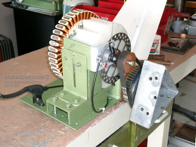

Found this ,,,
Those were the days ,,full of enthusiasm, I think the ribbed belt came loose in a gale and shut me up for some time after that event. also smashed the blades ...
But, who knows ,? I may get back into it again ,one day??

It looks like you have a disc brake off of a small motorcycle or something I have several things never put one full of together yet though one day one day I will

Yes, was a bicycle front wheel disc brake complete with the little caliber .. worked a trick ,on the bench , but I guess with the fairly big 2mtr.dia plastic blades ,a bit over whelming ,dunno? you can't tell 60 feet up on a howling night of gale force winds ,lol.
Just one of many hair-brain contraptions this mad Aussie has dreamed up -we,ll blame the rum !!!

Some really nice fabrication work I have three or four of those type direct drive washing machine motors and haven't done anything with them I even have a tower never put it up either
