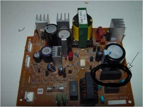

Posted: 03:10am 07 Jul 2008

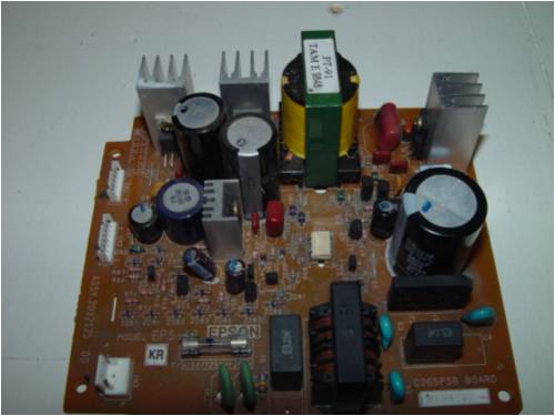

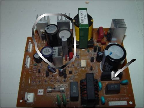

Heres some pics
I ran over to the local radioshack earlier today. The sales associates are as helpfull as a block of wood on a rainy day I rather order the stuff online and pay for shipping then frequent that store again.
Robb
Joined: 01/08/2007
Posts: 221
Posted: 04:04am 07 Jul 2008
Theres a bridge rectifier with the arrow and there will be diodes that you may be able to use in the circle.
That big bridge is way overkill but you'v got it so use use it.
Oh is that a blowen fuse on that board? I hope the bridge isn't shot. Edited by Robb 2008-07-08

Posted: 04:07am 07 Jul 2008
The rectifier is that flat rectangular plastic block, with the circle around it and arrow pointing to it. Close to the large electrolytic capacitor. Verify that it has 4 legs, 2 marked with '~', one with '+' and one with '-'.
Now, if you can scrounge an old PC powersupply, in there (again close to the one or two large electrolytic capacitors) you'll find a rectifier too.
As far as Radio Shack goes: Gee... You're the first one I've heard say such things about that store with its large inventory of electronics parts and knowledgeable sales persons. By now you likely know more about electronics than the staff...
BTW, before you toss those PCBs in the garbage, at least remove the aluminium cooling fins and the associated 3-legged components, which likely are FETs, rectifiers and/or voltage regulators. Remove the fuse and the white thingy in the middle (with 6 legs, an optocoupler) too while you're at it. It may come in handy in the future if you decide to play around more with electronics.

Posted: 04:32am 07 Jul 2008
Sweet 1 rectifier down :)

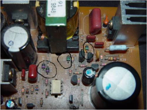

Ok... How to find suitable diodes on your PCB...
First, if you can, make a good close-up photo of the brown circuit board, especially the left-middle part with all the many small components. You're looking for tiny glass components with two leads. Likely, the circuit board will be marked (in white lettering) with text as 'D102', 'D302', etc. The 'D' indicates diodes here.
The glass diodes may be printed with *very* fine lettering, for example '1N914' or '1N4148'. Others have colour bands (for example, yellow-brown-yellow-grey = 1N4148). These would be fine for your application. But, basically, any old diodes you'll find in there should work (provided it's not a zener diode, marked 'ZD...').
If you can't find them with the above explanation or the help of Robb, post another good detailed picture and maybe we can hunt some suitable diodes down.

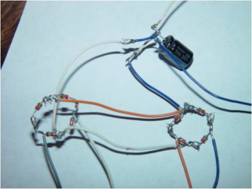

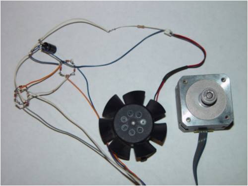

Anyway, that's the reason I'd suggest trying to find a rectifier if you can; basically because it's easier. But, there's no reason diodes won't work. In fact, I just recalled that a few years ago, long before I found these discussion forums, I made something just like it: a stepper with rectifier (and voltage regulator). The rectifiers were made out of plain diodes (1N4148 in my case). Lousy picture can be found here:
http://www.anotherpower.com/gallery/dinges/stepper_generator _resized
The 8 diodes are so small you won't be able to see them in this bad picture. But, it works, and should work for you too.

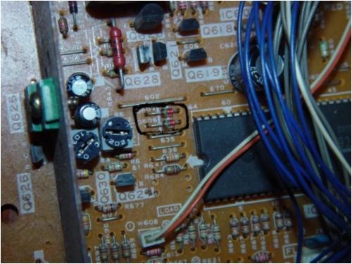

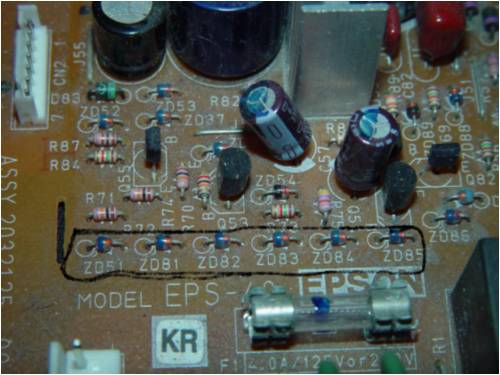

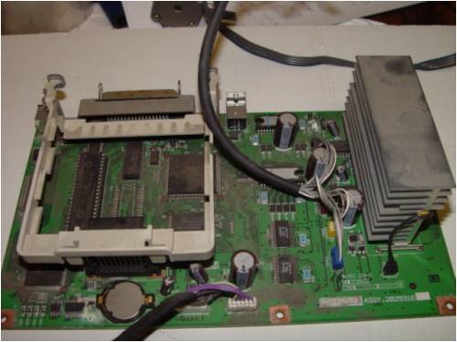

Posted: 07:05am 07 Jul 2008
I hope those are diodes but I seem to have a problem. Theres 3 purple striped and 3 teal striped ones. Can they be mixed and matched?
I take it those are the zener diodes?
this is from an old vcr that i just took apart. Unfortunately there dont seem to be any rectifiers but there are more then 8 of those diodes.
btw are the strip an indicator of where the arrows point?Edited by jeen 2008-07-08

Posted: 04:55pm 07 Jul 2008
The 3 purple and teal (just learned a new word) diodes in your first picture should work fine, even when used mixed. Not much of an issue in your particular application.
The 6 zener diodes in your next picture shouldn't be used, just as other zener diodes in that same image. Zener diodes are used for voltage stabilization/regulation, not rectification.
The last picture from the VCR, with the two (or eight) green diodes should work fine too. BTW, if you look carefully at the white print under those diodes, you'll see the symbol of a diode: a triangle with a line at the tip. Notice how that line is at the same side as the black and/or green band around the diode.
I'm 100% convinced that there is a normal rectifier (4-legged one) in that VCR too, just as in the powersupply of the printer. Have a closer look at the circuit board where the 220/110 V power enters and where the fuse is. Near the fuse should be a large capacitor and in that vicinity there should be a rectifier too. Just to give a hint on where you should be looking.

Posted: 09:06pm 07 Jul 2008
No luck on the rectifier from the vcr power board. There are 4 huge diodes wired next to the transformer though.
Might be more of a learning experience and fun for me to build the 2 rectifiers :)
