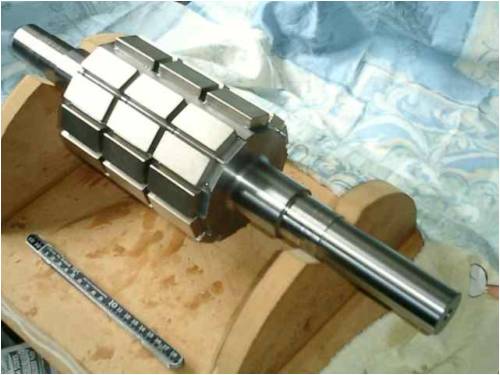

After the first small motor conversions (none are yet flying) I decided to tackle a larger project. About a year ago I finally acquired an old 10 hp motor to be converted to a permanent magnet (PM) generator. Work has been progressing slowly but steadily. Initially I intended to just make a new PM rotor for it but later decided to do a full conversion: a new rotor and a rewind.
This is so far the largest motorconversion I undertook. It will likely be the final one too. Larger conversions are frought with too many problems. A 5 or 7.5 hp motor is the nicest size, I think. 10 hp is just a tad too large (for me). And to think that Zubbly was considering doing a 25 hp conversion... (me shudders). This is also my first conversion where I use the 'JacquesM' method of decogging, as opposed to the usual helix-method. Hopefully the theory and calculations were correct, otherwise I'll end up with a 20 kg magnetic paperweight.

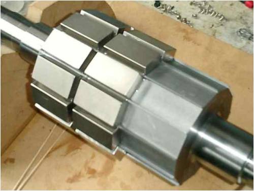

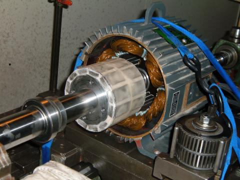

The progress so far: the coils in the stator have been removed (sept. 2007). A new rotor has been turned and milled (finished in march 2008).
At the moment I'm glueing the magnets on. 36 pieces of N42 2"x1"x.5". A scary job. Sometimes things look nice on paper (or the CAD screen), till you finally hold the workpiece in your hand in real life and see and feel how large and heavy it really is. The photos don't do justice to it.

I particularly like the little ridges too. In fact, if it weren't for them, wrestling the magnets in place as they sliver around on a coating of epoxy would be practically impossible. The downside is it takes a fair amount of machining (milling).

I still intend to mount a temperature sensor in the stator (don't know how yet, haven't considered these issues much so far) and I'd like to have a way to tell RPMs. Maybe an optical through-beam photoswitch and vane inside the motorhousing ? Don't know yet. But it would be handy in the case of star/delta switching. My 3hp conversion doesn't seem to have much problem running in delta (unlike the 130 W conversion, which shows quite a bit of torque ripple when wired to delta (and without an electrical load). I figure delta should be possible, despite the risk of circulating currents, which I think can be removed by carefully rewinding (identical number of turns in all phases).
You're right about the original plan to keep the stockwindings. It was originally a 4 pole and I intended to just build a new rotor with the Jam method. Then afterwards do another motor conversion with rotor and rewind. Zubbly's disease made me decide to do a rewind immediately on this motor. Unfortunately he passed away before work really started. I'd have loved to show it off to him and hear his criticisms.

All magnets have been installed. Next step is to add some glass cloth around the magnets and cast the rotor in epoxy.
