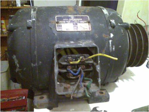

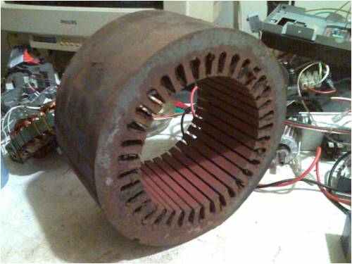

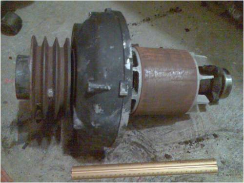

This is the A.E.I. Engineering motor I am working on. It was a dual delta and wye setup. 1435rpm, 7.5 horses and 10.8 amps.

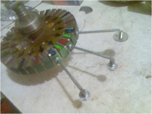

This is the removed rotor...the 30cm ruler is a good scale indicator.

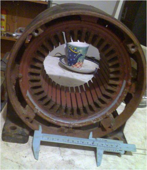

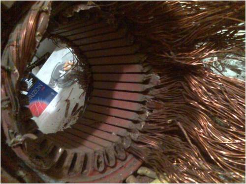

Removing the old wire was very much a pain. The insulation was deteriorated and flaking in parts, so I removed it all. Wood was actually used to peg the wire into the stator slot...bigger pain. You can see here the second layer of wire shielded from the first with some insulation.
All the wire gone after a full day of work...lots of coffee breaks...the calipers are set at 110mm, which is the length of the stator slots. The inner diameter of the stator is around 140mm.

I did think of burning or using flame to make life easier, but did not want to destroy the insulation between the laminations.
I am suffering "writer's block" as to how many poles would be ideal on the stator in relation to the desired number of phases...treating each of the three configurations individually is not a problem regarding this.
I mentioned the idea of having four poles on the rotor with huge ceramic magnets or eight poles with smaller magnets.

I'm curious: how many poles did that motor have originally (or, what was its RPM) ? There seems to be very little backing iron so I'm guessing at an 8-pole, perhaps a 6-pole. (edit: my mistake, after re-reading your post I see it's 1435 RPM, thus 4-pole. Strange. Would have expected much more backing iron)
The rotor is stubbier (shorter and larger diameter) than my 10 hp conversion (which was originally a 4 pole motor). So your motor seems to be more suited for conversion to a slow-running generator than mine.
Designing a generator for just one purpose (wind) is difficult enough as it is, frought with compromises. Building a generator that would be suitable for 3 different drivers would be even harder and need even more compromises.
I don't think I'd use ceramics, as they're much larger than NdFeB magnets and weaker. I agree with your analysis of the temperature sensitiveness of NdFeB magnets. It's the one thing I dislike about the magnets I'm using in the 10 hp conversion, they're standard temperature grade (I originally bought them a few years ago to build an axial flux). Next time I would buy different magnets:
- H, UH or SH temperature grades
- not nickel coated but epoxy coated (better adhesion when glueing them to the rotor)
- with countersunk holes for attachment/locating while glueing them.
Such magnets are for sale over here: (http://web.telia.com/~u41124251/Block.htm (not affiliated, just a satisfied customer)
Next time I will definitely try to purchase magnets with the above characteristics or have them custom-made in China if need be.
It's good you didn't toss the stator in the fire. Motor rewind shops use temperature controlled ovens (within strict temperature limits) to 'roast' the varnish over a several hour span. Too high temperatures can damage the laminations and distort the motor house. The consequence would be higher stator losses. In fact, sometimes it's required that a rewinding company performs a stator-loss test after burning out the coils, to verify that performance of the stator hasn't been degradated by the session in the oven.
Without knowing exactly what you want to do with this motor/generator it's hard to give advice on pole numbers. 12 pole should be technically doable though, I think. For anyone to be able to help you, you'd need to supply at least the intended system voltage and cut-in RPM.
I don't see any reason for using a 4-phase arrangement (which is in reality 2-phase, with a phase shift of 180 deg. between 2 of the 4 phases). 3-phase is normal, I can't think of any reason to deviate from this.
And yes, removing the copper out of the stator takes the better part of a day or two. Not my idea of fun. Edited by Dinges 2008-07-13

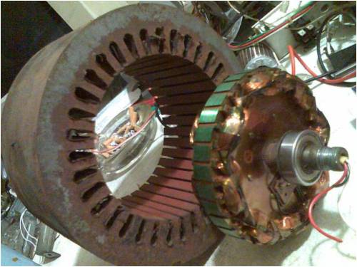

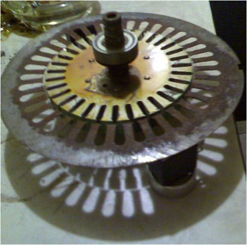

I have removed the stator from the casing as I need to clean and reseal the laminations. I suspected the lams were not in great condition and affected to varying degrees by rust and general deterioration. I am going for a flexible high temp primer of some description that is not relatively conductive to reseal them. Here is a pic of the stator removed from the case...
What I like about this stator is that there is nothing touching the outer periphery of the laminations and they are not welded together. The lams are clamped together and suspended in the air with no contact to anything along the depth of the stator. The only blemish is a small notch that I will use to align them back into a complete stator. I removed the case from the stator with a hacksaw blade...wish I had an angle grinder
I am in the process of separating each lamination with a one ended razor blade...I only have about 70 more to go before I finish
A painful job time wise and patience is needed not to distort the laminations when separating them from each other.

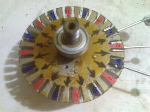

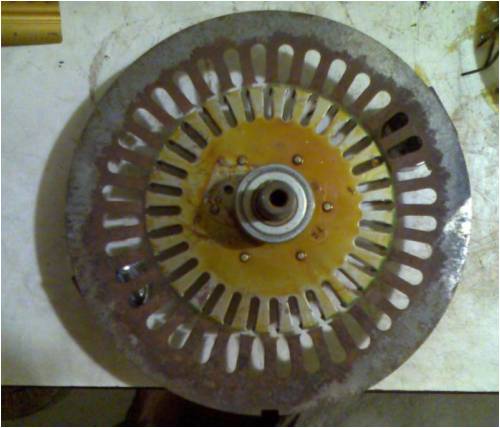

The next picture shows that I think I have resolved my main issue...finding a rotor to fit inside the stator. I have several old ceiling fans in the back shed and I toyed with the idea of fitting a square peg in a round hole...
As luck would have it, as I was separating the laminations to be cleaned, I realised that I may be able to fit something inside the inner diameter of one of the rings...a rotor from a ceiling fan...
the air gap is 2mm between stator and rotor. I am not really happy with this large air gap, but it will have to do, as that is all I have got laying around. What I have noticed from playing around with my ceramic magnets, that if two alike poles (e.g. N/N) are sandwiched between a stack of laminations, magnetic "power" is increased to one end. So I think that the air gap should be okay with the "teeth" of the rotor enhancing magnetic magik towards the stator "teeth".
I plan to use several more of these rotors with an alternate stacking of stator, rotor, stator rotor etcetera.
I think 25 laminations from the stator will fit each rotor and once I have removed the copper wire from the rotor, I believe some nice magnets will fit in the slots.
I am leaning towards plain neodymium magnets as i believe that heat will not be problem with the unit.
Once I have raised some more rotors, I will then find a means of getting a shaft together to hold my multi-layered pancake assembly together. I might even use the shafts already attached...I have not got to that point yet.

You certainly are giving it a shake. If magnet costs are a problem, you look like you could fit the ceiling fan laminates all onto a shaft, use some sliprings and a voltage regulator and wind a rotor to replace the magnets. You can then control the output.

*UPDATE*

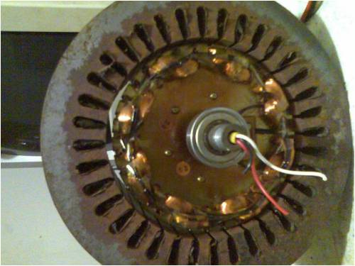

I finished removing all the wire from the rotor of the ceiling fan. Those laminates are really soft and had to take care not to warp/bend them. I do suspect that I may have to remove the lams from the shaft, as during the manufacture of these, the lams were distorted and won't be so great at high RPM. I still do not know at this moment what is my final specs as far as output is concerned, but I am aiming towards a low RPM setup. Oh well.
Below are two photos of the rotor and stator design I plan to use...the last one has a ruler at top left and you can see the scale of 1 inch.
...how I am going to arrange poles on the stator is my next step, remembering that I plan to insert magnets ($$$) into the rotor slots and wind the stator with wire.
Not all the teeth on the rotor and stator line up opposite each other...I counted four that do with one at each 90 degree interval...I am still trying to figure out what this means. The adjacent teeth progressively become more separate until they realign again at the next 90 degree interval. I think the top view photo shows this. I hope some of you gurus might tell me what is great and not-so-great about the possibilities with the teeth alignment. Remember I plan to have each rotor tooth as a magnetic pole. CheersEdited by CraziestOzzy 2008-07-19

Just to clear up in my head what arrangement I think is best for the available rotor, I dismantled some hard drives and salvaged the magnets, broke them in half and slotted them into the rotor slots in the planned scheme sumwhere in the back of my head.
I tested the magnetic strength with my high-tech measuring tool, a long metal bolt. I attached three bolts to the teeth of the rotor where the magnetic strength was strongest, which happened to be where two alike poles were sandwiched in between a rotor tooth. I had just inserted my precisely machined neo magnets...
The black arrows show where I will place the larger magnets.
I threw some heavier bolts on the ends of these long ones and was very happy with the depth and strength of magnetism. Ideal for reaching into the stator slots where I will have the copper wire.
The tiny neo magnets although butchered and very unhappy, are amazingly strong and sniff out the laminations on the rotor like flies on sh*t ...can't wait to get some bigger ones and smash a few against my fingers.
next picture shows what I plan on doing to my rotor...I will somehow remove each tooth on the rotor (marked with a faint black square on photo) and insert snugly fitting neo magnets. The ends of the rotor teeth will mechanically hold them in place (with the help of some glue and a retaining ring either side of the rotor to stop them jumping sideways...
Once the magnets will be in place, the poles will be arranged like they are in the photo. I hope to try and figure out an ideal setup for a low RPM generator with a 36 slot stator. Any help and bullets will be very very very much appreciated....cheers again Edited by CraziestOzzy 2008-07-19
