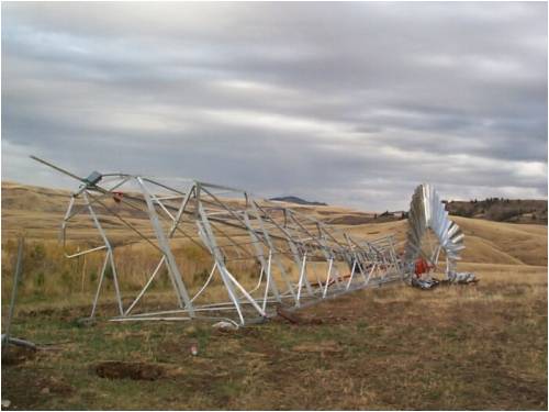

Jacobs is the king of power generation windmills, and his views certainly need to be taken into account, but as with everything to do with power from wind, there are no hard and fast rules... except "nothing describes the power of a mill more than the swept area"... after that it is open slather.
If you are using an alternator that you build, three blades is the best to design around.
If you are forced to use some other alternator, then it may well be that you find a different combination of diameter and blade count works better.
I think it was FandPwithPVC who found that 4 or 5 blades were better for his purposes, and outperformed his three blade arrangement for his F&P in his circumstances.

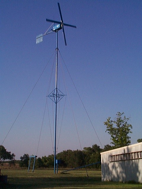

Breezy 5.5 (http://www.prairieturbines.com/) found that after extensive testing 4 blades did what they were after driving a 60hz alternator from a 60rpm blade set.

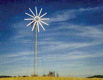

On the extreme end of things, Claus Nybroe from Windmission http://www.windmission.dk/index.htm found that for his particular combination of induction generator:rpm:diam, that lots was better and achieved a quite high rotor efficiency.
Windmission:
"In the theoretical windmill literature the maximum obtainable rotor efficiency is 0.6 . This is called the Betz efficiency, named after the man who calculated it on the basis of a rotor with an "infinite" number of blades.
The rotor efficiency is also named Cp, and in real life the highest obtainable Cp values are around 0.5.
The 12 bladed Windflower rotor, for example, operates with a measured maximum Cp value of 0.47, which is very good. "
His blades are as about as good as it gets, they are very quiet (250rpm I think) with good startup torque to drive a high ratio gearbox... a nice combination and a .47cp
So it is not all black and white, and this should be in the back of your mind at all times when making hard and fast decisions. Different alternators require different drive characteristics.

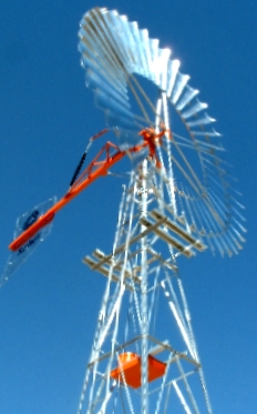

Turbex with a zillion blades works very well with a cp of .35 from memory. I think the South Africans did a bit better than Jacobs managed with the same type of setup.
http://www.turbex.co.za/Documents/Generator.html
5000 watts worth looks like this (18' rotor) Nice and slow (48rpm or so) and quiet.
and they go up to 20000watts. Not too shabby eh?
Of course, sometimes the blade number is not the most important detail to sweat over and some of the finer points need to be addressed:
(http://bob.gudgel.org/)
In general, 3 is the magic number... but with wind, not much is set in concrete.....it all depends on the alternator setup.
messy really ...isn't it?
..........oztulesEdited by oztules 2008-07-25
