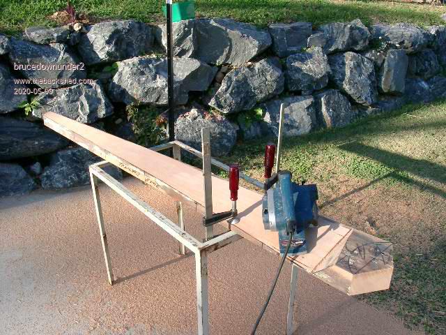

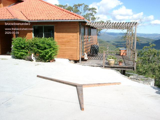

Hi Bryan .
Good to see you back bashing wood again !!.
I've been wanting someone's unfinished windmill project ,but no takers ,so far -sort of want to hang something up on the tower to look at -- I'm sort of finished in the "building" section ,nowadays !.
Nice to hear of your project ,reminds me of yesteryear ...
Will be watching for your final outcome.
