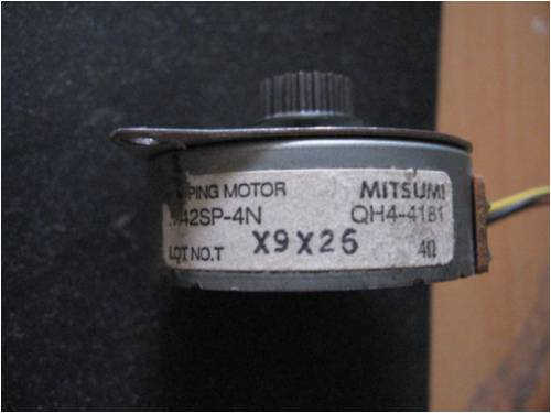

hear are some picures of my motor .. I got it out of a cannon BJC-256sp printer which broke down.
for more photos please go to the link at the bottom of this post(they were too large to post in this forum). I captured all the labelling and text on the outside of the motor in these photos.
dinges: "are you sure you've connected the right wires of the stepper?".
yes i think so. One way of connecting them didnt work at all so I tried the other way and I got the tiniest amount of light out of the LED. I think the motor should give me more energy than this. The RPM is approximately 252.http://flickr.com/photos/9937638@N02/

Ok, those pictures help some (mostly to verify that what you have is *really* a stepper in the first place).
Run these tests:
1) short all the wires of the stepper motor together; does it become harder to spin ? (it should, as the generator now becomes loaded)
2) remove the rectifier bridge; measure with a digitial multimeter (DMM) set to AC-range (20-200V) what the output voltage is when you give it a spin.
3) wire a LED straight to the output wires of the stepper motor and give it a spin. First use a slow spin, progressively faster if the LED doesn't light up. If you're using all your might turning the shaft and it still doesn't light... then either the LED is broken, the stepper motor is or it's simply not useful for this application.
  Quote  However i did find out that the votage is 1.2v I had connected a rectifier diode and that reduced the voltage be 0.5 volts. Is that still low for a stepper motor?
The steppers I've played with put out plenty of volts (but only at very limited current, hence limited power). The first time I found this out was before I found these online websites on windgennies and was messing around by myself. Was testing a lot of motors using the tongue-test (didn't have a DMM within reach). Most DC motors needed a lot of RPM to barely make you feel a tingle on the tongue. So when I tested the first stepper this way I had a slight surprize, to the point I nearly bit off my tongue due to the high voltage.
Just the other day I had 2 more steppers from an old printer; one put out 7.5V @ 300 RPM. It had no trouble lighting up a white LED (at approx. 3.5V)
No worries, we'll get your problem sorted out. Run the above 3 tests and we'll know a lot more.

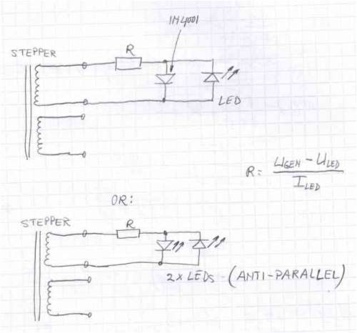

If not, there are ways to wire it up without the external rectifier that would still make it work. The external rectifier in this case drops quite a bit of voltage (~1.5V). Normally this isn't much of a problem but in your case, with such low output voltages, there's nearly nothing left at the output of the rectifier (or diode, in your case). So we'll have to try to get rid of the rectifier.
I'd say, give the other stepper a test. If it doesn't perform better we'll have to make do with what you have now. 180 RPM should be an achievable goal with those PVC blades, and I'm sure we can get a few LEDs to light even without a rectifier .

In any toy project where no energy storage was involved, I would only use a DC brush motor as a generator. There are plenty in the 1-5W power range. These could come from junked video or tape plyers. Just connect up the led with a series resistor and place across the motor. The direction of blade rotation determins which way to connect the led.
At the low power and voltage levels, it is pointless to add diodes and have to spin faster than needed.
In an AC output machine, I would use 2 LED's back to back and a resistor across only 1 winding. No need to complicate with more phases.
try the tape load motor on a VCR.
