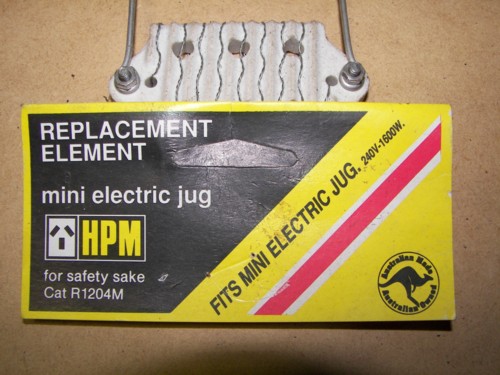

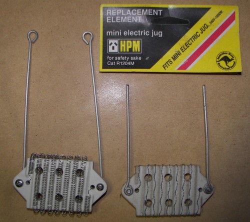

Here's the element type in question with one of my spares. This is as per the instruction and 4 of these are the dump load of a 12Volt 300Watt wind turbine.
This pic clearly shows the element is 240Volt 1,600Watts as purchased and for bare immersion in water.
You young fellows have been spoilt by electric kettles that turn themselves off. In my day we had to clean up the mess when the jug boiled over.
Cheers Gill _Cairns, FNQ

dear Gill thank you for calling me youngster, but as a 67 year old youngster I learn to heat water in the old kettle over a "Primus" heater, I would like to know if the elements have to be connected in parallel [ the elements I have are the same as in the photo 240 volts 1600 watts] do I have to use a diode and if i have which thanks agaian to both of you I have been learning a lot.

Just an observation, when I pumped 5kw into the icecream container, I got mountains of bubbles from the boiling water, but also got a green ooze and froth from the electrolysis on the copper alligator clips (jumper leads) holding the coils.
If it were AC then I don't see a problem (taking and putting at say 50hz on each electrode... so neutral, but with DC, my clips would have not lasted too long at high voltage high current (over 140v@over 35A). At lower voltages this may not be as severe as fast, but would sooner or later make itself apparent I think.... maybe?

Yes, off the top of my head, I expect you will have 4 in parallel though the modified wire length for each may be twice that of the 12 volt example. I have deliberately avoided working out your element arrangement preferring you to do it for yourself.
No diode will be needed if the heating element is wired as a substitute for the factory load in the shunt regulator.

the electrolysis occurs if the element is not insulated. Remember the elements are originally designed for AC. If you use DC, and uninsulated then current will also flow through the water as well as the wire. One end of the wire will be disolved and the other will be plated. I would use Au, or Pt, but would need a lot HaHa.
Either use AC, or insulate the wire for best lifetime of the wire.
