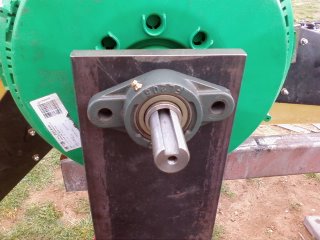

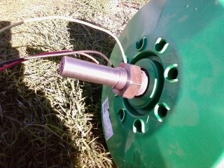

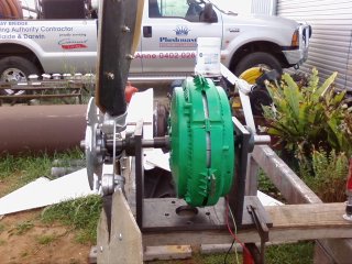

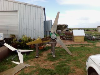

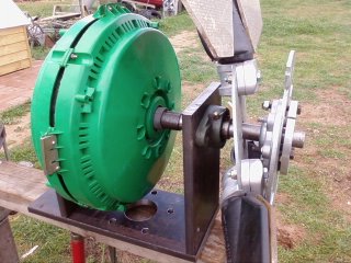

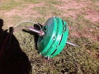

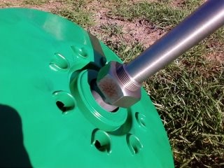

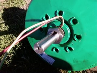

Have started work on the seely i got from Dennis Latham and decided with my engineer freind Wayne that the seely's green shroud was not strong enough to take the pressures of wind mill blades turning or violent changes in direction so made the decision that the stator would be the turning part. To do this we turned out a shaft from solid stock, milled a key way along it to carry the 3 phase wires, turned a large thread either side of the shaft where the seely wil sit and fitted 2 very large nuts to hold the unit tightly in place. We wll fold up some 10mm flat bar into a u shape, fit a 2 bolt fl205 each end to take the full weight of the unit on the shaft and fit the titan fan hub into the end of the shaft to take the blades. Trying to put pictures up but cant work out how to turn a jpeg file to a rar or zip file any ideas?

Nice progress on the F&p and the Seeley. My friend Phil that has posted about his efforts is also using an industrial 5 blade position hub. It's fully adjustable and looks like it could take massive forces. Being just 20 minutes from each other we can compare our progress.
I like your idea with the Seeley,you must be installing slip rings and brushes ?.
I've thought of a different approach, having a large dia blade set , this on it's 'stand-alone" hub and axle. Then belt drive to a shaft that "dogs" into those 6 holes around the green cover. The dog clutch is free floating and will have rubber sleeves to take any alignment differences.
Geared pulleys of the timing belt drive types in cars can be used and that way you can change the ratio's.
I've stripped a Seeley,but it's on the back burner at present while I take advantage of seasonal westerly winds and do further testing on the F&P and rigging.

Hi Bruce, yes i am using slip rings and looked at the strength of the green shroud, Wayne my engineer freind said the shrouds strength is also in the orange fan that goes around it in the air conditioner. He feels that the removal of the orange fan surround leaves the shroud with just screws holding it together, basically its all a complete setup, and the only strength is in the outer ring the rest is just a cover to protect from moisture in the evap air conds. So the setup we have come up with puts absolute minimum pressure on the shroud, the fl205 bearings take all the weight from front to back leaving the shroud only to be held in a non rotating position. I spoke to dennis last night and we spoke about rewiring of the seely and i came to the conclusion to try the unit ( a 1500 watt x 24 v )as is in star. and use that info to build on. This unit will be pushed by 3 x 1200mm x 300mm chord x 100 mm tip fibre glass blades that i cut to size yesterday this will give .720 sq mts of blade surface area and should at least get it turning to get some results, i still cant work out how to convert jpeg files to zip or rar files to post on the site.

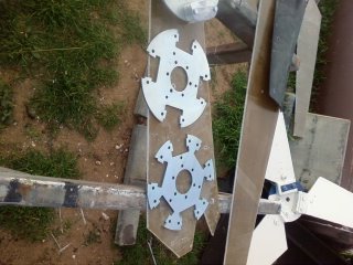

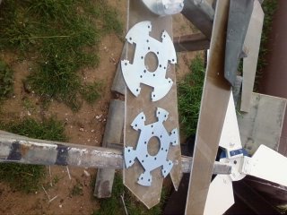

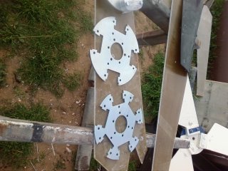

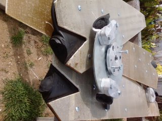

Thanks Gill, should have spotted that one so here goesWell i seem to have got the pictures up, you can see that the Titan Fan Blades hub is very versatile, we can use 2,3,4,5,6,7,8 up tp 12 blades and the taper lock is the same for all sizes and fits any 25mm sline including the F & P. I use the the black fan stubbs and fit my blades to them with coach bolts and nylock nuts. The hub allows any degree of attack that you want and can be changed in less than 3 minutes all up plus the time it takes to bring down the windmill. Now here is something real gooder! i have at the moment an 8 blader titan exactly as it comes out of the factory and it is putting out 25.5 volts and 5 amps in a strong wind, its turning well not good enough to say that as is its all i need but a good experiment

I see your pictures go across the screen, and I bet your asking yourself how to fix it so they go down the screen. After you upload each picture, move your curser to the end of the line and hit the Enter key. You should be able to edit your post and do it, just click between each bit of picture code and hit Enter to add a line.
Your pictures are well sized, very good.

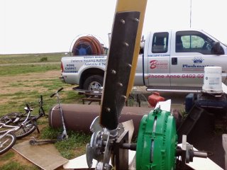

Hi guys,i have taken a few photos of my seeley project, have made the shaft,blades and total retainer unit only need to do the sliprings this week.
The black rear blade stubs,taperlock and retaining plate all come from Titan Fans in Adelaide at a cost of $83.00. The shaft cost $100.00 and the blades were cut from a retired submarine battery box at a cost of $50.00. The seeley was $45.00 from Dennis and all i need to makeup are the sliprings and furling tail.Friday will see the unit up on its neww pole.

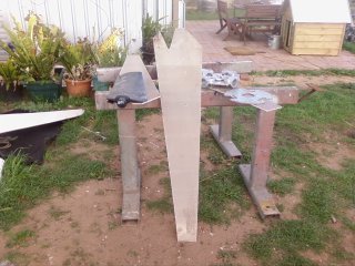

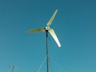

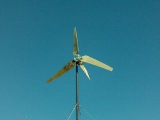

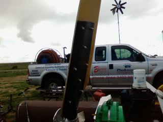

Well got the new test fibreglass blades up last night, unbalanced no cleaning of the leading or trailing edges just up there raw and they went off their faces, a bit of a wobble but i can see these types of blades have a lot more than potential they actually work extremely well. The best part is they only took a total of two hours to make and cost $50.00 but i
got more than the three blades in this photo i got a total of ten blades from it!, i see that as very resonable well to me anyway. Any one interested in the fibreglass boxes they are made from you can buy them from Machinery Warehouse in Wingfield Adeliade.
I made thes test blades fro friend and have put 4 aside for the seeley project ( see previous post ) i may even try them in a 6 or 8 configuration but i think i will need to shorten and sharpen to get gooder results. saw the blokes about the sliprings this morning. I am getting really excited about this project, i must have a big grin on my face cause my wife is giving me those google eyes oh oh i have to go that job just came in !

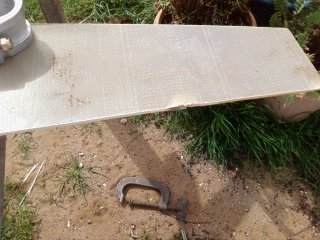

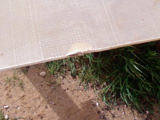

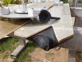

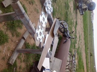

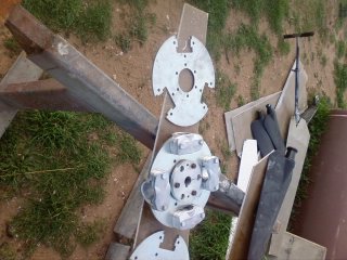

Have done some destruction testing on these new fibreglass blades i have made from the battery boxes,
i shortened the distance from the hub to the pole and arranged things so that the blades would strike
the pole. Had a major wind last night and in previous tests with wood and plastic blades they all broke some
where along the centre part of the blade. But to my surprise this did not happen,the chord retaining blocks snapped and the fibreglass blades remained intact
with just bruising to the blades, this tells us of the strength of the blade itself but does not make a failure of the chord retainer blocks as they were
never intended to put up with that amount of stress, that is total destruction type stress. Here are a few pictures,
also i have noticed that the three blade hub is a lot thinner than the 4,6,8+ hubs so in a running unit i would double the thickness to stop possible flexing.
