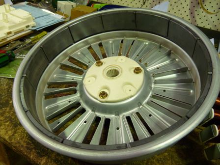

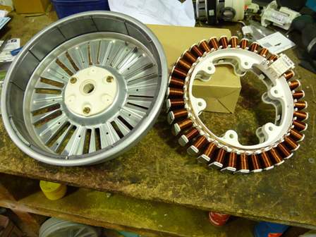

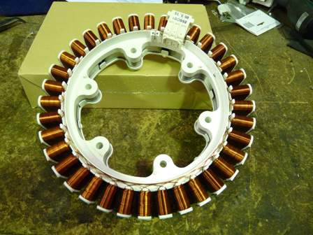

LG Front loader has a similar setup to the F&P and I thought it might be useful for wind power. I have not gone into the details yet as they are hard to find. What I do know is it is designed to spin the entire washing machine bowl and 10kg of clothes. So it must be strong, maybe too strong.
Good thing is it is made of steel mostly. I can get these Brand new as a set for $53 plus postage, but I don't have the time or skills to start from scratch. Anybody interested in trying them out.
Attached are 3 photo's hopefully.

What about bearings & shaft?Edited by Robb 2008-09-13

Bearings will be a shelf item, shaft I will get a price, but I think with the centre plastic bit being bolt in, those with the tools and skills could make or modify their own shaft to suit.

Gee, $50 for stator and rotor --are you sure ??? F&P are much more...
The "bolt-in " rotor mount looks great ,machine fit a shaft ,easy.. The stator looks a bit light compared with the F&P (wire and laminations ) .. but the steel backed rotor might be great ..

I held the Whirpool stator, and it use 36 coils in a star configuration, and between each star point is a ugly 30ohms and naturaly 15ohms by 12 coils
