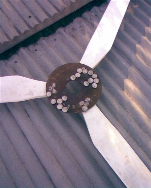

This is pic of one rotor the magnetes used to be arranged around the edge of the disk

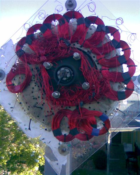

This pic is whats left of the stator a reminder of just how energy 500 watts actually is

G'day WF,
I guess it's a bit hard to sell now?
Seems like it was a prototype and never intended for 25 years of continuous service. Possibly for checking that configuration. I think we can now safely say it's not suited as a full scale production model.
As a total rebuild is the only option, your open to all variety of configurations now. Looks like you've lost a magnet or two during the party.
Now the real fun starts. Good luck.
Cheers Gill _Cairns, FNQ

Wind Friend,
Some things to consider.
1. The magnet spacing between magnets on your disk need to be around a magnet apart. (1/2 magnet minimum)
2. Use a 3:4 coil magnet ratio...
3. use 3 phase not single phase (not 18 mags and 18 series coils... 1ph.
4.Make the coils inner size no less than 3/4 of your magnet diameter.
5.The air-gap (distance from front plate magnet face to rear plate magnet face should not exceed twice the thickness of the magnets, ideally for 3mm mags, that would be a very difficult 4.5mm... which would give s satator thickness of only 2mm....(allowing for mechanical space between mags and stator.. not very practical. Better to have less magnets, and double the thickness.
6. Keep the winding resistance down to an absolute minimum
7. Try for a cut in of at least 8-10 mph, this will help to keep resistance down.
8. Use a blade calculator to find the best size and cutin for your power requirements here:
9. Any magnet wire combination will produce something, but to get the best out of your efforts, these simple rules will go a long way to being more successful.
10 E=IR. For every ohm of resistance, you lose a volt at 1A. for 2.4R, you lose 2.4v per amp... so at 4 amps you lose 10v in the stator x 4amps = 40watts.... so keep resistance low, more mags, less turns, thicker wire , small air gap.
The stator you show would be difficult to get decent efficiency out of at any but low power, as the air-gap must have been about 20 or more mm, which would have left little flux for the coils to see... thats why there is a mountain of turns there for only 12v..... which means more resistance and a runaway prop.
Do what ever it takes to get the resistance to an absolute minimum.... which will mean that you will have optimised the design anyway... you need more magnet so you can have a reasonable air gap. If you were to stack three on top of each other you could use a 12mm gap, which is do-able.
That stator was a disaster waiting to happen, mechanically and electrically I think.
.........oztules
Edited by oztules 2008-09-24

The coils appear to have been cable tied only to an acrylic plate. Each coil as it passes a magnet has a force placed on it that attempts to push the coils. The coils have to be bonded together to prevent any movement. The coils in your photos would have moved enough to cause binding on the magnets. This probably has nothing to do with burning out as such, but a mechanical problem.
The wire in the photo above looks thinner than 1.1mm. Are you rewinding with that wire guage?
In the first posting you mention 9x2 coils. Now you are talking about 18x1 coils.
Good luck with a rebuild. Oztules has made some useful suggestions that will help you.

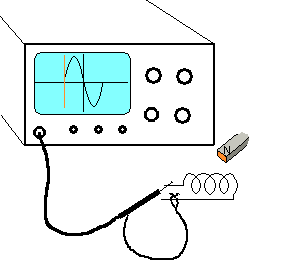

from here :talking electronics
You can see why point 4 from above does not make complete sense, as the hole should be the width of the magnet. But in the real world, we tend to wind inside the magnet diam a bit to get more turns of lesser wire length... less resistance with smaller diameter really, the induced voltage is less than ideal, but is made up by the shorter circle length.
We pull this trick to get more winding space than we would have otherwise, and so can try and get the same number of turns (plus a few extra) with a slightly larger wire diameter..... to get the resistance down.
We could of course just keep increasing the height of the coil for more turns, but this increases the air gap... and we lose flux and voltage, and so require yet more turns (like your stator above). It is all compromise, so chose the best compromise you can for the stuff you have to work with.
For point 7, the higher cut in you chose, the lower the resistance of your windings, and so closer air gaps are possible, which lowers turns, which decreases air gap etc etc. It appears that for practical purposes (stator strength, winding space etc) that 4.5mm would be the aim for your magnet depth... but not practical, so you will be forced to move away from ideal from the start.... and then it just all gets badder and badder... so to speak
..........oztulesEdited by oztules 2008-09-24
