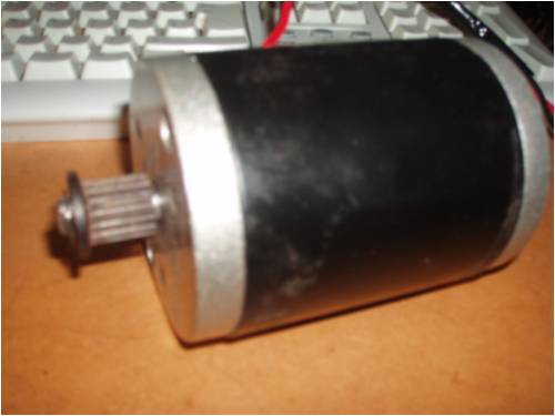

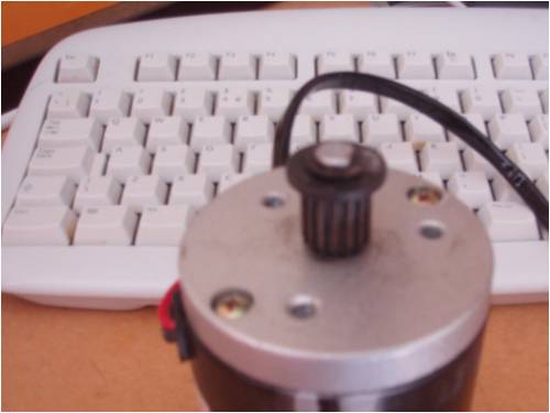

I have got a couple of little motors to mess around with (100W, 24V DC).
However when they arrived, the shaft has a gearing on it - these motors were from an electric scooter. I thought I should be able to remove the gearing as it has a circlip - but it's stuck fast! Do you think they might have epoxy resined it to the shaft? Should i just hit it with a hammer?
Failing that, and I can't remove it - what's the best way to mount the blades to this geared shaft. It isn't as simple as just using another geared coupling as this has a sort of washer as part of the gearing on the face side!
I have tried to attach photos - please bear with me and thanks for looking!
Bad photos!!

Ahh Frank - if only it was that easy just to remove the circlip and prise it off.
I think they must have stuck it or welded it to the shaft!! Grrr!
Also taken it to bits, but can't remove the shaft from the rotor. These motors are brand new, and I don't really want to goose them - if they're gonna be no good, I'll put them back on flea-bay!!

  Marcus20VT said   Ahh Frank -if only it was that easy just to remove the circlip and prise it off.
I think they must have stuck it or welded it to the shaft!! Grrr!.........
I'v had a bit to do with them. I found the the pullys where stuck on with loctite or something like that. Had to take to it with a small gas torch to get it off. I struck a few with internal faults in the armature too. Also the chineese are rather slack on commutator gap undercuting.Edited by Robb 2008-09-23

Hi everybody, I am a newbie to The Back Shed and have enjoyed reading through all the forums. I have picked up quite a few good points and so far have made 4 small wind generators with single blade and 3 blade props.
Hi Marcus20VT
In answer to your problem, get hold of a small puller and it will come off with a little effort. I have the same motor which is out of a gopher or scooter. I had the same problem removing the gear so I went into the local motorcycle shop and they lent me a small puller which did the job. Hope this helps.

AARRRGGGGHHHHHHH!!! - Still having trouble with this - have broken my mates gear puller trying to get it off
Surely I don't have to get a blowtorch or grinder to it - what would the heat do to the internal wiring?

Posted: 09:58pm 27 Sep 2008
Time to bring in the cavalry.... get the grinder out.
.........oztules

  oztules said   Time to bring in the cavalry.... get the grinder out.
.........oztules
Hi oztules good call,Marcus grind it off
