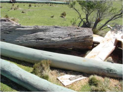

So we selected a decent sized Macracarpa log which looks like this:

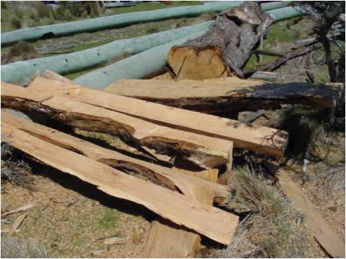

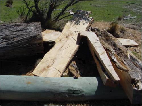

We hacked into it with Jamies 28" chainsaw and fashioned some very very rough planks,and lots of offcuts too:
You can see an offcut slab left behind as well as these offcuts:
Unfortunately I didn't take pics of the manufacture of the 10X2 planks we cut from the slabs using the chainsaw jig method to make square planks, that method can be found here: making chainsaw blades and then the same jig method with a few angles to cut the blades out. As it turned out we were in a hurry to get some power flowing at his place, so the camera was nowhere to be found....Usually he has too much power, ...but suddenly everything was out and we didn't want the Batteries to suffer too much

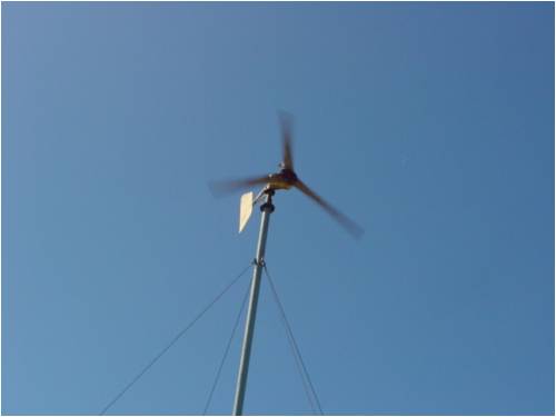

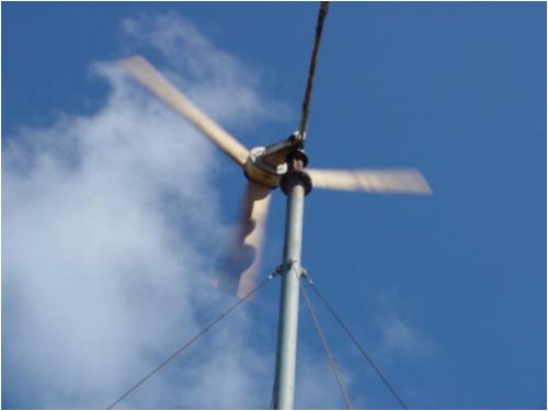

But here they are flying again, I went back up there today to take pics of them, So now we have fixed the injector pump on the Lister, and built , balanced and installed the blades...... of course the sun is shining brilliantly and the solar is putting out 1KW instead of a few hundered watts, the mill steadily putting out another KW. or more..... and the dump load working overtime again...... sigh.... it never rains but it pours.
(and more happy neighbours too)

Lol Peter and nice work once again Oz Thank god for the good ole crappy U.S you have that tree.
http://www.cypress-sawmill.co.nz/macrocarpa_specs.htm
oztules
Joined: 26/07/2007
Posts: 1686
Posted: 07:34pm 04 Oct 2008
That looks like the critter Vawtman. Seems pretty good stuff for blades. Talked to Ron about it a long time ago, and always wanted to try it.... here was the opportunity
