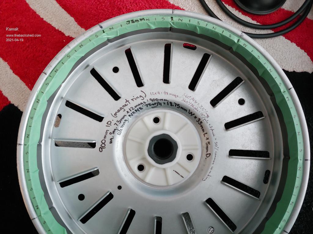

The most important design consideration (the most obvious and undocumented) when rebuilding the rotor with new magnets, is that all the coil/poles within any one phase leg see the exact same magnetic polarity (and transition from/to +-, polarity phase change), at the exact same time. This is where hysteresis, magnet spacing, and speed of rotation should get consideration.
Kamak
Joined: 13/04/2021
Posts: 150
Posted: 07:36pm 18 Apr 2021

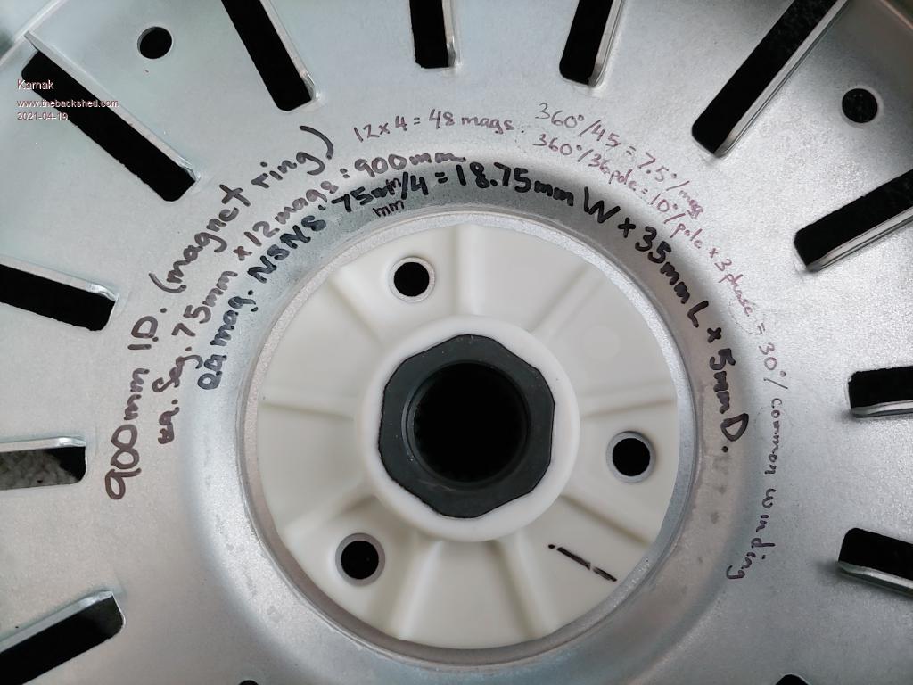

Stock Samsung P/N: 09CA49132 Stator
900mm ID. Mag ring
75mm W x 35mm L x 5mm Thk mag bricks
12 mag bricks
4 poles per mag brick NSNS
75mm/4 = 18.75mm W magnets
35mm L x 18.75mm W x 5mm Thk per mag pole
48 mag poles @ 7.5deg per pole, 15deg per "like" polarity
Stock mag flux density = approx 1750/1800 Gauss
36 coil poles = 360deg/36 = 10deg per coil pole
3 phase winding XYZ = 30deg per "common" phase winding
15deg per mag pole of "like" magnet polarity
therefore the "like" magnetic pole polarities (and transitions thereof) will always aline with the "common" coil windings throughout rotation, as 15deg is an even common denominator of 30deg.
Edited 2021-04-19 06:08 by Kamak

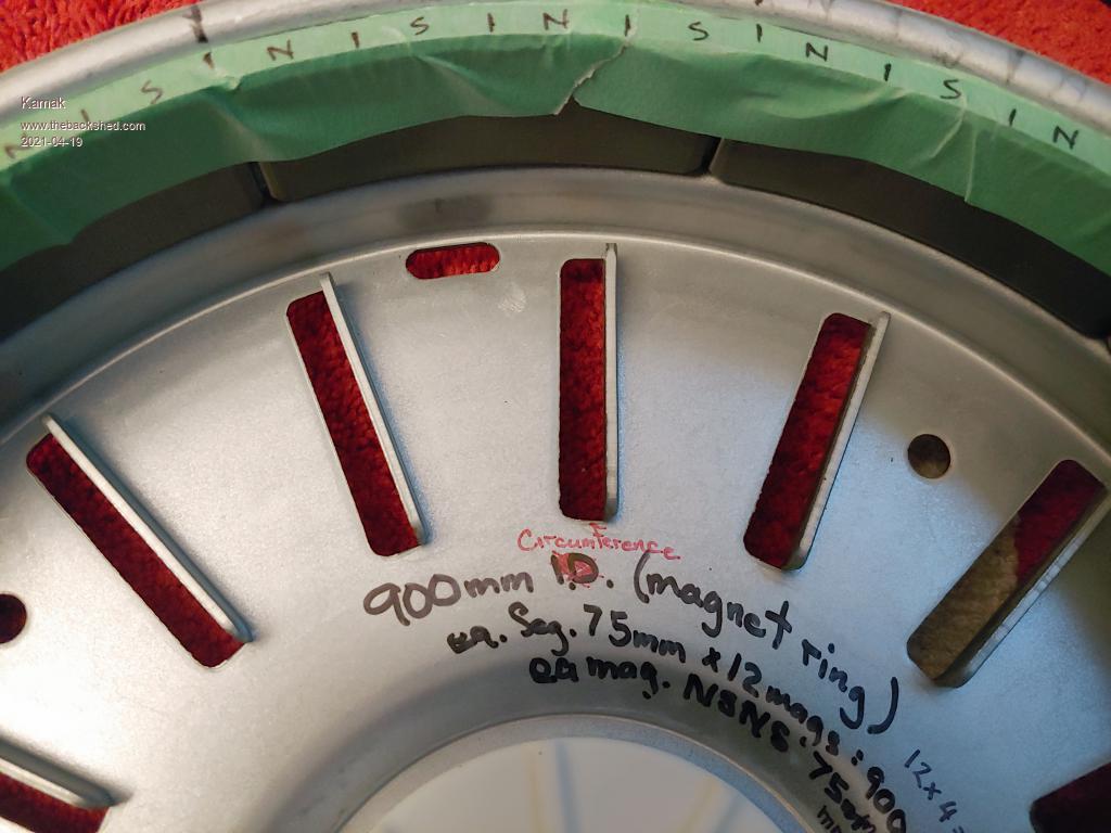

Yeah, My bad! this is a Samsung rotor. The diameter that I am referring to is the inner circumference of the rotor where the magnets are glued to, 900mm in this case. Sorry about that. I sure wish I could go back in these threads and make corrections. Seems that you can only make corrections to the last post as long as no one else has posted after you. No biggy, I will correct when and where I can, and with follow-ups.
Kamak
Joined: 13/04/2021
Posts: 150
Posted: 03:06am 19 Apr 2021
900mm [Internal Circumference]. Mag ring
12 mag bricks
