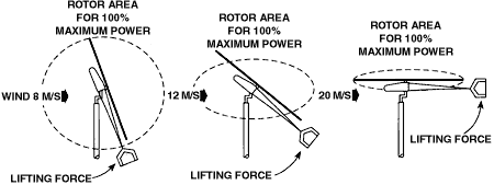

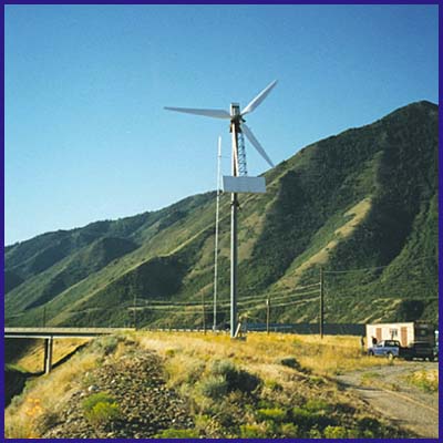

A company in Hong Kong made a range of wind turbines with furling over the top rather than to the side. The company seems to be gone now and all I have from them is a few pictures of how their wind turbines looked.
In one of these pictures you can see its size in comparison to a small building and vehicle.
I do have videos of these machines running on an old PC.
If you want a more detailed description of their turbine I can post that, it has been some years since I spoke with the manufacturer and I never forget tech info, faces maybe, but never tech food :)
I also have pictures of tail only furling where the tail is pivoted around the tail boom. It is a US design and rarely seen in the wild.

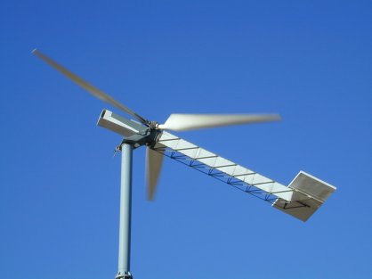

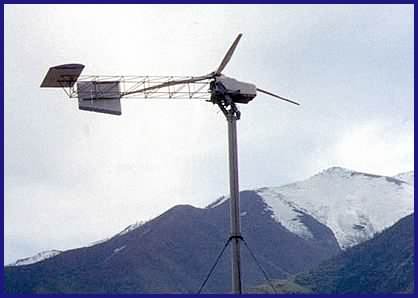

This lot use a similar system.
Soma

The wind turbine pictures I posted of the larger machine use a weight that can be lowered down inside the tail and the wind speed at which it furls controlled remotely. Clever and fool proof, if anything should ever break it means the machine will always furl early.

The machines pictured, tilt their blades up, forward and into the wind, not back. My own machines are down wind and work with the wind at all times and do not have the burden of high stress levels as with side and overhead furling.
