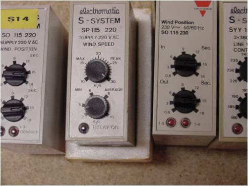

Bolty
Joined: 03/04/2008
Posts: 81
Posted: 10:14pm 14 Nov 2008
Hi SparWeb.
I don't mond admitting that Gordon was referring to my installation. I am lucky that I live quite close to Gordon, and it is very rewarding to have his help!
I am very impressed that Gordon observed this phenomenon and found it so interesting that he tried to explain it! I only saw it as magic!!!!
I had been previously wondering about the directional stability. Even when under normal load conditions,I have noticed that it is slow to follow the wind in turbulent conditions. I guess that this is partly due to the wight of the tail arm, which is a very heavy piece of square galvanized tubing measuring about 4 X 2 inches. It also has a quite flexible sheet metal tail that is both above and below the arm. Gordon has suggested that I should replace the tail with a more elegant looking single wooden tail.
I think that you are right with your explanation. You have summarized the blades characteristics very well seeing that you have not seen them. They don't have twist and the angle of attack is quite small! In fact there is some slight asymmetry in the blades. On slow rotation, you can notice that the end tip of one blade is virtually flat, where the other 2 have a slight forward attack (say 1 or 2 degrees)
I was looking at a way of increasing the low end power from this turbine. The blades are each 1.3 metres giving an overall diameter of 2.7 metres. I have contemplated fitting spacers between the hub and extending each blade out by about 400 mm, bringing the diameter to 3.5 metres and increasing the swept area by 68 %. I realize that this is an imperfect design, but I could get up to 50% more power at lower speeds. I am not after a boost to top end power, as the wind regime here rarely produces the 1KW anyway. My average power is only around 200 watts so boosting this by 50% would be worth the effort. Dual electronic braking and furling should prevent overloading in high winds!
I would welcome any opinions on this from anyone! One extra modification that I could easily do with these blade extenders, would be to slightly increase the angle of attack of each of the blades, and also eliminate the slight variation that now exists at the tips. Any thoughts?
BTW when the turbine was free spinning we were testing the ability of the turbine to furl under no load, simulating an electronic brake failure. I might add that the wind was obviously not strong enough at the time, as it did not furl! I might also add that I had SWEATING, ITCHY fingers firmly place on the manual brake switch, ready for any eventuality!
Regards!
Bolty

oztules
Joined: 26/07/2007
Posts: 1686
Posted: 11:18pm 15 Nov 2008
Dinges,
These things form the backbones of the two bigger mills down here.
I am currently rebuilding these ones which are faulty..... they have their problems I'm afraid.
..........oztules

Dinges
Joined: 04/01/2008
Location: Albania
Posts: 510
Posted: 11:01pm 16 Nov 2008
  Oztules said  So I am still waiting to see the Dingesman super yaw system.... so I can run out and copy it....
Don't hold your breath. At the rate I'm progressing lately you'd end up blue in the face (or worse) before I had something to show for. But it's reassuring to see I'm not the only one who isn't 100% satisfied with the current furling system.
Catweazle had a little run-in with some elektrickery and won't be back soon. Something about 380kV distribution lines and flying kites.
... but what do you mean by 'sinister' ?... That's my happy face!
Had to scan the passport photo for something else but thought it'd also make a nice avatar for this site. Blame the guy who made the passport photos. First batch got rejected because of the presence of a smile. But yes, I think I overdid the 'must not smile!' routine in the above one.
