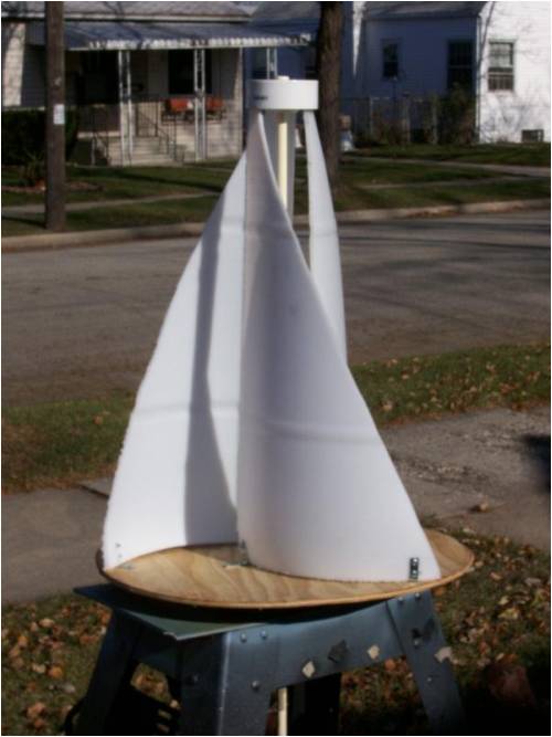

Posted: 03:27am 24 Nov 2008
This is the sail shaped Savonius type VAWT that I made as a trial. It works very good. No special shaping of the 'sails', they are simply cut direct from a 55gal white plastic drum. There are lots of mistakes in it, but surprisingly it is a very forgiving design and works well. Next is to connect a small PMM to it and make some electricity.
Dave Brown
Green Bay, WI

Posted: 11:26pm 25 Nov 2008
nice work quahogwi,it looks simple to build.
i just recived my rpm and wind guage and i am going to test my output on mine. you have a good start with your unique design, just dont stop and i am sure you will find a way to improove it.

Thanks for the compliment. I've got to admit, though, that I started off trying a different design. What I was attempting at first was to make a crude double helix type design. I first marked off the the halves of a plastic barrel at top and bottom. I numbered them 1 & 2 respectively at both ends of the barrel. Using a piece of twine I connected T(op)1 to B(ottom)2, then T2 to B1, traced a line and cut. The result, I had imagined, would have been two helical pieces which I could slide apart as the two halves of a Savonius turbine. I learned the hard way that this isn't the way to make a pair of matching helical buckets. Didn't work. Either that or my AADD took over and kept me from aligning them properly.
I remembered seeing a cloth rotor of a near conical shape. That gave me the idea to make a couple more cuts resulting in a number of triangular pieces, curved to make a belly in the "sail". A few PVC parts and a 1/2" steel tube for the axle and a plywood disk. I used ball bearings with some light oil. The result is what you see in the picture above. I haven't done any testing, but it starts is pretty low breezes. I made one earlier simply cutting a 5 gal pail in two and sliding them apart to form the typical Savonius "S", only slightly overlapped (about 10% or so). This I mounted in a simple box frame. It starts turning in much less wind than does the tri-sail one. But both do start turning in very light breezes.
I haven't done any testing but I have picked up an inexpensive bicycle speedometer/computer. With the magnet attached to the bottom of the disk and the induction coil firmly attached to the stand, and it will make a reasonable RPM gauge. As I understand it, you set the "wheel circumference" to a fictitious number of 16.66 or 166.7 or something along that order. The result is the computer calculates what it thinks is km/h, but in fact is displaying true RPM at that particular moment. I've tried it, and it works quite well. I just haven't recorded any information as yet.
