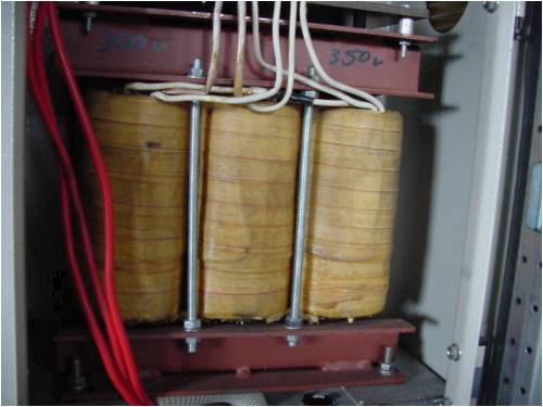

The AWP (African Wind Power) 3.6m has a single three phase transformer that looks like this (in fact is this)
It is nominally 350v input. You can use three single phase transformers instead of a dedicated one.
At 240v input it puts out around the 55v mark up to 30 amps. The mill runs around the 240v range, but unloaded goes 600+

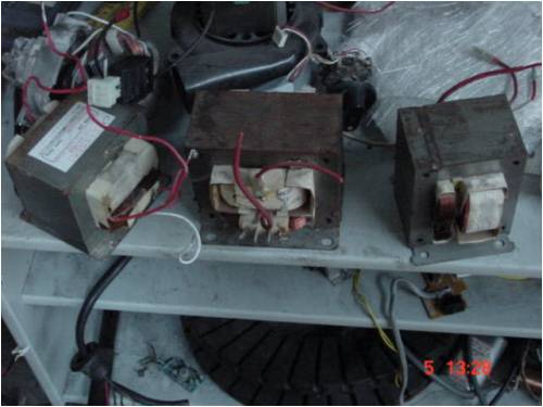

Rewinding ones from microwaves is a simple and dirt cheap way of getting the tranny's. It is most helpful to split the laminates completely and lacquer them if you want good efficiency. They are designed as a ferro-resonant transformer, so they don't care too much about core losses as they drive them deep into saturation anyway. You don't want to do that or you waste too much as heat.

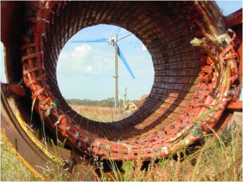

Do you mean something like this? (only weighs a ton or so)
I've seen Rons little stator. It is slightly bigger than the AWP stator. Same design.
.........oztulesEdited by oztules 2008-11-28

I hadn't thought about that 500kW genny of yours yet... I count 60 stator teeth. So a 20 pole generator would be an option.
Peter walks off to find his calculator... wonders how many 2x1x.5" magnets it would take... and what size blade...

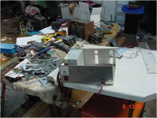

Posted: 09:34pm 27 Nov 2008
well I have 3 transformers at my disposal that I planned to try... here is a pic... http://www.cardomain.com/ride/2327820/4 at the very bottom is the transormer. I was using it to drive me HHO project, but that is on the shelf till I find a few custom parts I want for it.
The transformers are from small UPS's for home PC's. The batteries on those had died, so I pulled the Xformer and rectifiers from it. I plan to use the a VAWT turbine so rpms should be slower right? My hopes is to keep volts out of the stator to around 150-280v I don't know how frequency affects a transformer, but if 110v puts out 14.4v rectified, then 280v should be about 28-32v? But again I do not know how frequency affects a transformer although I would assume since it needs to be AC then the higher the frequency the more the xformer should xfer power from primary to secondary?
I think I am going to try the file decogging on the first F&P and the stator twisting on the second to see if one outperforms the other.
As for the battery becoming the voltage regulator, doesn't there become a point where too much voltage available to a battery is bad for it? Or will that not be a problem because the possible output from the mill is not enough to cause a problem?
