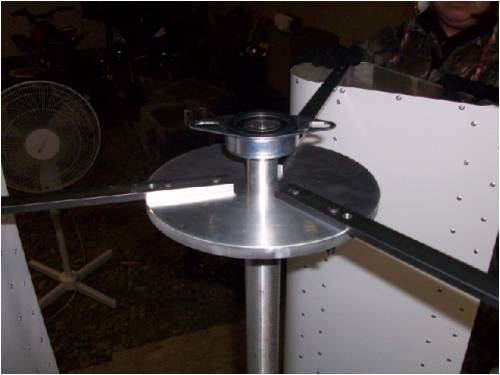

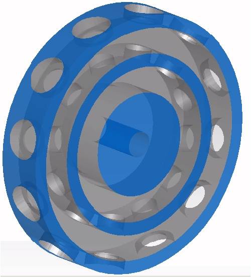

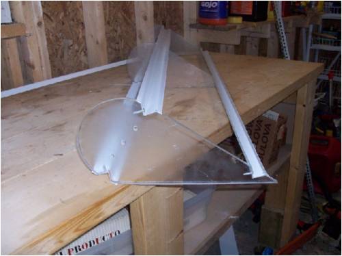

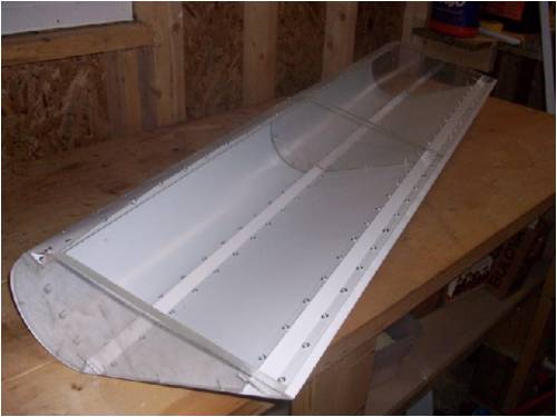

I decided to try and make a Lenz2 without using wood. The end and center pieces are polycarbonate. The braces are made of aluminum trim bent to form a channel. The wrap is also aluminum trim and it's held together with #6 sheet metal screws (1/8 pre-drilled into the poly) and about 100 rivets. Each wing weighs just under 4 pounds. Being a machinist I have access to metal and machines so I made the top and bottom hubs out of aluminum, and the arms to tie it together is 1/4" X 3/4" flat stock.
I connected an ac servo motor from a cnc lathe x axis. The blades were driven from a 19" house fan and the rpm was 34. 4.2 volts rectified. I dragged it outside into some wind. I have no idea what the wind mph was but at one point it generated 34.4 volts and was completely stable. The ratio was not quite 2 to 1 at that time. I have since changed the ratio and now I'm getting 8.4 volts inside with the fan blowing it. There is alot of torque and my thoughts are now turning to making my own stator but my questions are regarding just that. Most online stators are 8to 10 inches and made for machines with more rpm. Could I get the same thing from making a 12" to 14" stator? It has more torque. Every inch in diameter adds 3.14" to the circumference so 2 inches bigger would would have over 6" of movement across the coils. The overall of the machine is 3'(dia) 4' tall. I've had it in pretty good wind (30+ gusts) and it held together and ran very smoothly, although at that time I didn't have the generator connected. All and any input is greatly appreciated.

Glenn, I hooked up the servo and was convinced I was going to use it on a pemanent basis, until I decided to make another one to mount on the other side of the pole that will hold this one. I want both mills to be exactly the same and I can't get my hands on another one of the servo motors (unless I can convince the operator of the cnc lathe to rip the gearbox off another machine for me).
The power loss is pretty substantial using a v-belt. It didn't even want to turn until I cut alot of slots from the id towards the od to make it alot more flimsy. I tried a sprocket and chain from a 15 speed bike but that didn't last that long. I only have hand tools here at my land and did the best I could but it didn't run true enough to keep the chain at an even tension and it just fell off.

What material will you be making the rotor from?
Keep in mind that it can not be steel (or any other ferro-magnetic material) as it will short the flux of the magnets. Also, for effective use of the available magnetic material, there should be steel behind the magnets to conduct the flux from magnet to magnet. If you have a look at the links above you'll see that's what Vawtman is doing too.

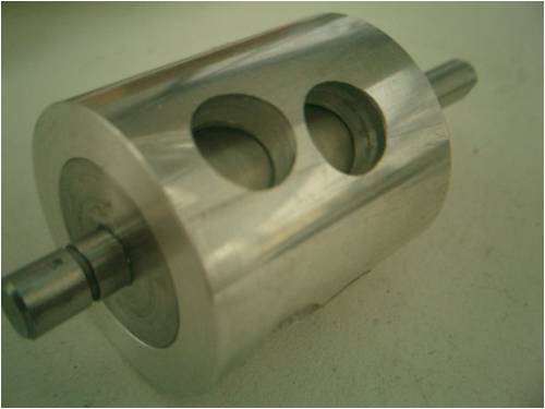

For another illustration have a look at some of the motor conversion rotors in the images below. Notice that the bottom of the magnets must be on a steel surface but that the magnets themselves must not be (completely) embedded in steel, as otherwise the flux will be shorted. Hence the aluminium sleeves you see in the pictures below.
For effective use of your magnets, you need a steel inner core for the inner ring of magnets, and an outer ring of steel over the outside of the rotor to conduct the flux of the outer ring of magnets.
Peter.Edited by Dinges 2009-01-01

1. If your magnets are 1.5" by X inches, then the most useful practical distance from the magnet faces opposing each other is about 3/4 to 7/8 of 2 times X. ie if your magnets are 1/2" thick then about 3/4 to 7/8" gap is about ideal. (winding space is just as critical as flux)
2. If your magnets are 1.5" diameter, the inner diameter of your coils needs to be no less than about 4/5 of the magnet diameter in practice. (Theory says the same size, but in the real world, the inner turns although less efficient than the 1.5" diam, cost less copper per turn,and so less resistance for reasonable gains. After this, it gets less useful going smaller)... so for 1.5" diam magnets, then 1.2" is about the smallest inner diameter to go down to.
3. You should endeavour to complete the magnet circuits as Dinges has pointed out. This means giving the flux lines an easy path to follow from the front of the magnet to the back.... but going through your air gap.... so 1/4" minimum backing behind the magnets of steel. ideally more, and if your using 14" disks, probably 5/16 will be better mechanically. This will give the back N pole of one magnet an easy path directly to the S pole of the magnet next to it. The front poles will have to travel through the air gap, but the opposing magnet will "draw" the lines from the face of the magnet opposite it to itself... and then back through it's backing plate to the magnet next to it's back on so it goes.

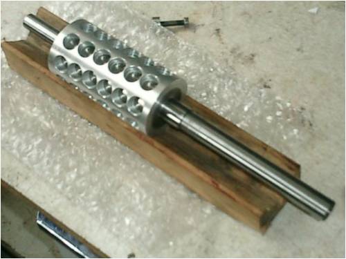

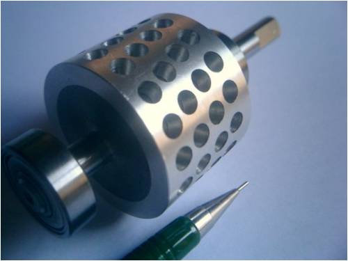

I also struggled with gearing early on and decided there had to be a better way.One day when visiting my mother in law i spotted this wheel sitting up against the house.Hmmm brain cells started arcing again
I think the 1x2x.5 mags are ideal for radial machines.You can get them cheap and they sit nice on the rotor.One other advantage of the radial is more efficient windings can be done.More coils and mags with fewer turns of thicker wire.
On mine the outer band has no mags just steel for the return path and spins with the main rotor to neglect the losses associated with neo's spinnin against stationary steel.

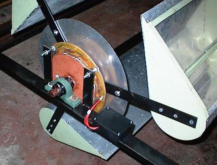

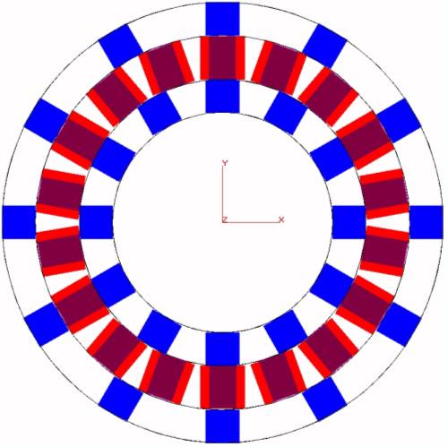

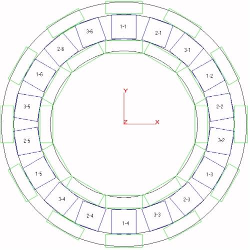

After all the information given (thanks to Oz), I have decided to re-vamp the design a bit. Please let me know if I'm on the right track. I've decided on 3/4 X 3/4 magnets. The coils will be just under 1" long and just over 1" in diameter with a 5/8" id. There will be metal rings around the outside of the mags to connect the flux and keep them from flying away. There will also be a ring inside to do the same at the other end of the magnetic field. Is this design abit better?

I suspect that this will produce a strange output waveform. This will be a very peaky waveform. This will produce high peak voltages unloaded, with a lower average than a sine wave. Any gains with the small coils will be lost with the magnetic fields. This arrangement would only become useful when the magnet dia is approx 1/20 rotor dia.
Gordon.

"Is this design abit better"...... yes, but it is not ideal.
A low speed alt will benefit from large magnet surface area, least dead space in the rotation plane, as well as all the other things I mentioned previously.
In this case, as Gordon pointed out, it will be peaky, and you have a lot of space there with no wire.
The magnet area is very small, and although you have solved the leakage problem, you have too much unused space.
I expect it will work fairly well, but for the effort involved, I think you will do much better to not re-invent the wheel and follow Ed's design. You have a beautiful lenz turbine, and Ed has matched it to the best alt he could. (and he has built many and all kinds)...
So the best advise I can give is to follow Ed on this one with this combination:
It may not be as sexy as an aluminium radial, but it will give the best results for this unit.
The radial will work nicely, but I think the resistance will be greater than Ed's axial. With alts, it is all about resistance in the windings, and how to get it to a minimum for the volts you want out at the revs you are stuck with..... one big balancing act......
So the best advice is to re-read this ed project again and then decide what to build.
Remember, there is no furling with this style of machine, so you need an efficient alternator to stop it running away in big winds..
