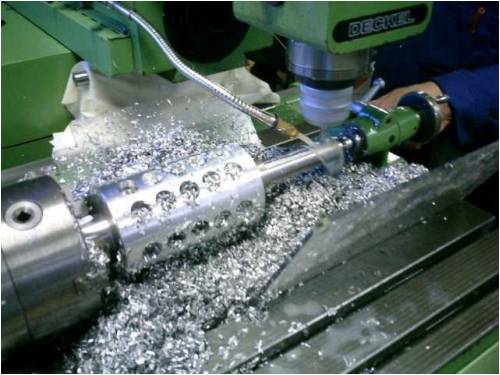

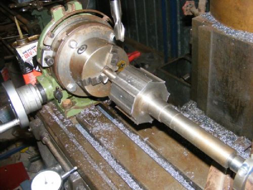

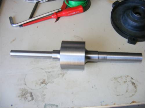

Well after dinges prompting I've decided to start on this conversion. I've machined the new rotor to spec's
Now to get the 43.75 degree angle today I spent 4 hours just to find out my division plates on my dividing head wont do the right angle.
To get the right angle I need to make a 105 hole division plate and use 96 holes and 4 turns. This is what took 4 hours to work out.
Cheers Bryan Edited by Bryan1 2009-01-07

Bryan,
I don't use your style of index head, mine is a rotary table that I would use to make the appropriate angular locations to mill from.
Rather than trying to dial up 43.75 degrees each time, perhaps just use the 360 degree graduations on the perimeter (I assume it must have for reference sake) and use these calculated positions as a reference:
"43.75, 87.5, 131.25, 175, 218.75, 262.5, 306, 349.75"
That way, if you get creepage, you will know straight away, other wise you may get a gradual error that will make this style of decogging not work too well.
Hope that helps a bit to keep the errors small/tiny.
Dinges may be able to help get a better idea on the right indexing plates.
..........oztules

Good to see work on the conversion is progressing. The rotor looks very nice.
I'm not sure what the problem is with the dividing head, I've never had problems with the fractional angles in my projects and frankly, *any* dividing head worthy of that name should be able to accomplish this .25 deg angle. But you are likely more familiar with your dividing head than I am. If it's anything like this one it should be a piece of cake.
I'm not sure what angles your dividing head *can* do. If it'd do 43.74 or 43.76 I expect it to be fine too. I'd be very surprized if the only solution to get the quarter-degree angles would be by making new division plates. Don't you have a plate where each hole represents (a fraction of) 0.25 deg? Then simply start counting holes and revolutions as you swing the handle.
Or do as Oztules say, rotate the head to 43 degree using the outer graduations. Then, add an extra 0.25 degree by counting the holes in the dividing plate (if there are 20 holes in the plate, put the lever in holes 0, 5 (.25deg), 10 (.50deg) and 15 (.75deg) respectively, after rotating to the proper integer angles (43, 87, etc. deg) first.
Look on the bright side... if you had gone with the helix method, you would have needed to mill ~100 holes with two different incremental angles. Trust me, I have done this using a dividing head (see image below), it took a lot of time and effort. By using the offset-method you only have to set 8 angles in the dividing head. So if you think machining it this way is a nightmare, consider the alternative:
Incidentally, now you also know why I'll never use the helix method again for conversions. Not because it doesn't work, but because there are other, simpler methods that require less effort. Hence my advice to you to use the offset method and not the helix method (and also because you can cram much more magnet in the same space that way).

Bryan,
After you mentioned you were going to cast the rotor in epoxy too I realized that, in that case, you may want to slightly increase airgap, so as to have a bit more room for a layer of epoxy over the magnets. If you have a look at this drawing ( http://www.thebackshed.com/Windmill/FORUM1/uploads/Dinges/20 08-11-27_101414_bryan_2hp_imperial_rotor.gif ) you'll see that airgap is 1.0mm; I think you'd want a little more airgap above the magnets for a thin layer of epoxy covering, so you may want to increase the airgap by about .3-.4 mm over what is shown in the drawing. In this case, make the depth of the grooves 4.41 + 0.3 = 4.71 mm to 4.41 + .4 = 4.81 mm.
That way you'll have 1.3 till 1.4 mm of airgap, half of which could be used by an epoxy cover over the rotor, leaving about .7mm of true airgap to prevent the rotor from rubbing the stator. It still leaves about 0.80 mm of material at the foot of the little triangular ridges that separate the magnets, so it's still machineable (in my 10hp conversion the ridges were 0.75mm wide, IIRC).
You may lose a bit of flux but I think the extra mechanical clearance will be very welcome. You can probably get away with a very thin layer of epoxy covering, as the epoxy will adhere very well to the (properly prepared and cleaned) epoxy-coated magnets.
You can also stick with the original drawings, but mechanical clearances will become pretty small if you then also go for an epoxy coating over the rotor.

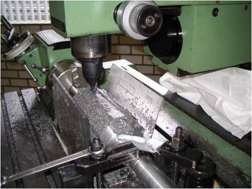

Hiya guy's,
           Well finally I got some time to back to work on the 2hp conversion and tonight I milled the rotor.
Tomorrow I'll install the magnets and epoxy them in and hopefully on monday I'll be ready to give it a decent test on my lathe.
Cheers Bryan

Looks *very* nice, Bryan!
So I assume you got the problems with the dividing-head figured out then?
Ok... now I really hope my math was right and it doesn't cog... or else I'll be reminded by you of this for years to come, no doubt.

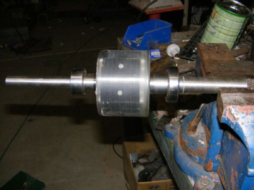

Posted: 08:55am 09 Mar 2009
Wellguys I bit da bullet and superglued those broken neo's in. I also epoxied them in so wedneday night I'll be machining the rotor and I'll put a pic up of the finished rotor. The superglue held the broken mags in place nicely and my crude but simple pole tester using a ugn5303 hall effect sensor a resistor and led worked a treat.
O'well lesson learnt about handling neo's be bloody carefull.

G'day Guy's,
             Well after bloody hours of work I finally got the 2hp all together and tomorrow I'm off to buy some vaseline to rub all over the rotor as it will make it easier to RAM up Dinges butt. To say it cogs is a bloody understatement, I set up a 300mm rule on the output shaft and it took over 100 grams at the end of the ruler to overcome the cogging. So I'm about near $200 out of pocket and over 20 hours of work down the drain.
Bryan ( who is now saving up for a trip over to dyke pusher land with a greased up rotor)

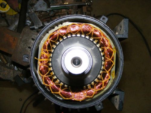

Hi Bryan
Just a thought I see you have a winding in, you have not got connected in any way ? particularly in delta as with phase shift due to displaced magnets you would get circulating currents would feel like cogging.

Posted: 09:12pm 15 Mar 2009
Sorry to hear it didn't work as planned. Though I think we can't blaim dinges on this , I made a drawing about the situation and in paper it looks just the way it should, the cogging effect of each pole should cancel each other out.
So what comes to my mind is 2 options, some machining error (unlikely?), or the broken magnet messing it up somehow, although i can't figure how it would affect it.
there is also the matter of different leakage flux on the poles, because of the one large gap on the magnets, but if it works for dinges in even a larger conversion, why it wouldn't work in here?
