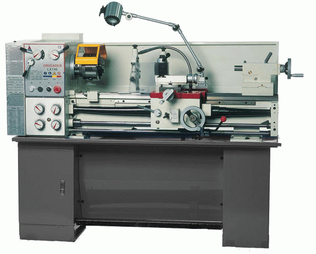

But you got me curious now, have you any pictures of your new toy?

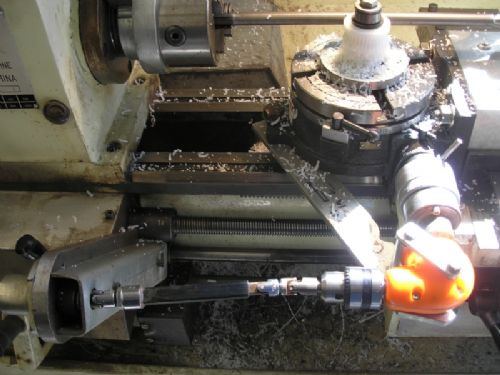

If its Chinese made, like mine, it would pay to pull it apart before using it. I found swarf stuck in the oil galleries and bearings that were below my standards. Guess I got what I paid for. After fixing all that I have a robust lathe that has been working well and trouble free these last 5 years.

Here we are Tinker, nothing terribly fancy, no digitial readouts or CNC, a basic lathe that is big enough for anything I am likely to do, maybe bigger than I was looking for but this one came for the price of a smaller one.
The only difference between this picture and mine that I can see: All one colour (no yellow or red), the light shade is a different shape, it is not called 'Crusader', mine does not have the nifty socks on the feed screw.
810mm between centres, 310mm maximum swing, 38mm spindle, 2HP(when fixed), 9 speeds (75 - 1810).

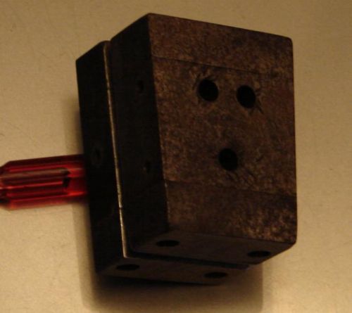

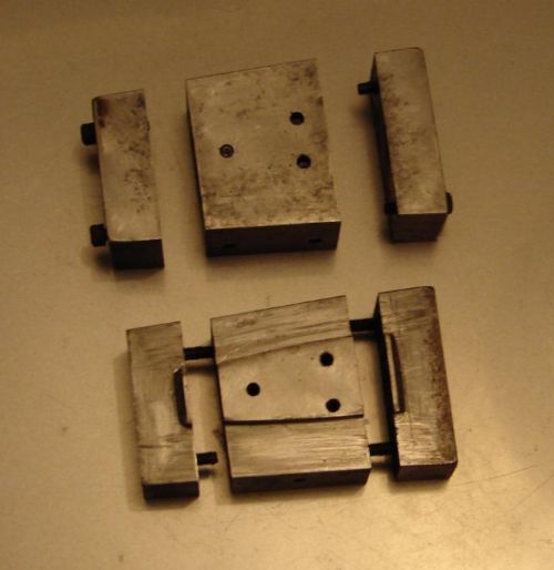

When you get it going, you will be in possession of a X-axis Z-axis milling machine. You can then (by being an animal really), build a quick change toolpost and a few holders... easier than it looks with a bit of interesting fabrication
Then you will have full control of your heights. The more holders you make, the easier life is. I have built 5. Mine takes up to 16-32mm tools... overkill.
Fun begins as soon as the new motor is installed. I can't imagine using shims.
If you don't wish to go that route, I would remachine the tool holder to larger slots (drop the bottom of the slot 3-6mm so you can shim up at least.

            Heres a simple tip to ensure you get the centre height perfect everytime. Machine say a 60 degree point in some scrap steel, get some pre-machined flatbar then measure the height to the centre. Then make a steel rising plate so the underside of the top is exactly on centre. Once thats done when ever you set a tool up just use that guage and you'll be on centre every time. Steel packing tape makes for good shims under tools, aswell as shim steel for the fine tweaking.
           Oztules has given you a great idea turning the lathe into a mill and I do have all the info here aswell as castings.
