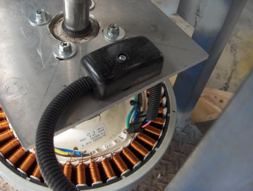

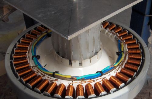

Hi Gentlemen ,
have built a Lenz 2 vertical wind gen and have found a F&P motor old 42 pole type ( 60 series I think from reading the forums ) .
I have rewired it as per the imnstructions and used some rectifiers to go from Ac to Dc output .
My question is , when I put a 50 watt quartz halogen globe ( car headlight globe ) across the pos and neg DC outputs and spun the F&P with a drill it blew the crap out of the globe very quickly ?????
After this I put the multi meter acrsoo the dc output and found that , in fact , it was putting out over 80 volts depending how fast I spun the F&P.
How will this charge my 12 volt battery bank , even with a controller this will cook the batteries super quick.
Even spun by hand I can get 12 to 13 volts without much effort.
Can some one explain how , or what , I need to do to control the voltage output ????
Many thanks in anticipation .

well done,
read this HERE and HERE
Daz

Thanks Daz,
these pages were I got all the information for the rewire and also have filed the poles for the decogging ( which has worked to a degree ) as it still has a small amount of cogging on start up , you can feel it when you turn by hand.
The main issue is the amount of voltage DC that this monster produces ???
I do not want to cook my battery bank 2 volt cells 1200 amp hours I have 6 for 12 volt.
regards .

Hi fernbrae
The faster you spin the F&P, the higher its output voltage. Your electric drill will spin the F&P much much faster than the Lenz windmill will. Depending on its size, the Lez will run between 20 and 100 RPM ( guess-timate ).
Try spinning the F&P by hand at about 60 RPM ( one revolution per second ) to see what voltage you get.

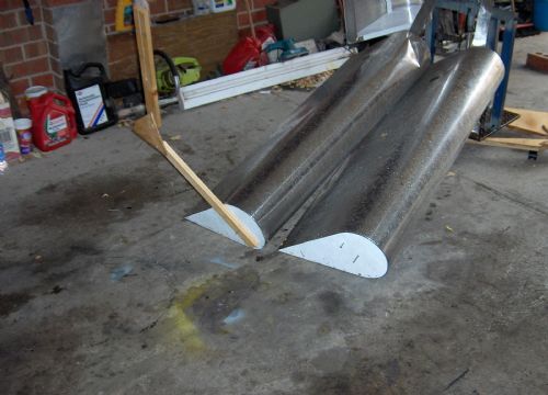

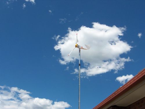

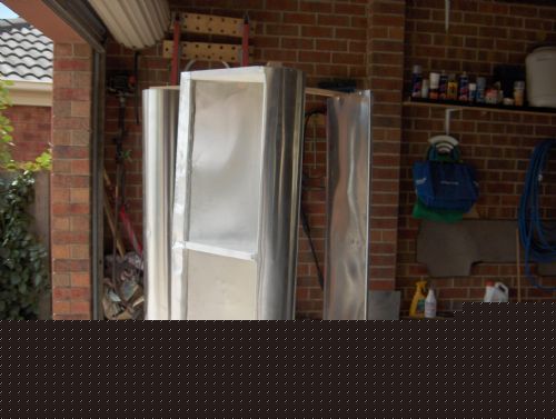

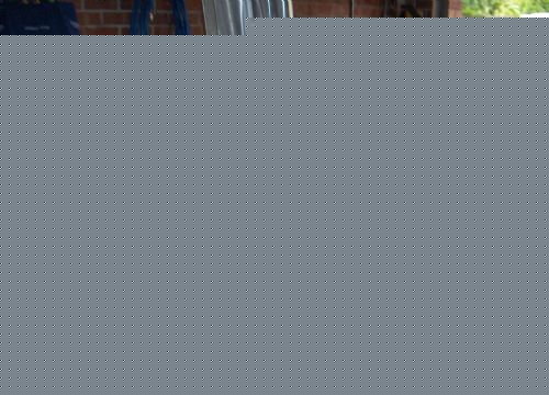

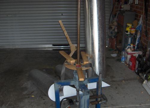

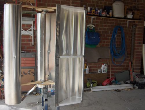

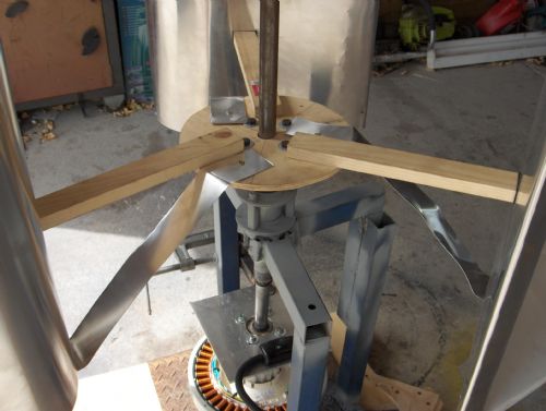

Hi Gentlemen,
sorry up loaded the chinese mill I have up already , after a remake it produces good power and traks the wind much better.
The photos are of the lenz2 that I have just made , this is just the mock up as I am awaiting the steel disks and then I can make the metal arms and weld it all together.
this will be the permanent item , hope it producs as much power as the chinese mill.

this is a bit of an unknown as yet,today I had it hooked up as it would be in a permanent situation
and it was very windy here in rowville .

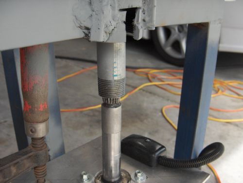

Actually we had a storm come through, prior to this the gen was running at about 20 to 30 RPM and showing abput 6.3 volts , as the storm hit the gen went crazy and as doing about 100 rpm and then in a momement it was pushed over and some what destroyed .
Alas it was a porototype and I am waiting for the matal circles to be produced and then it can be welded together and be bullit proof .
Please note these figures are taken on the ground ,not up in the air.

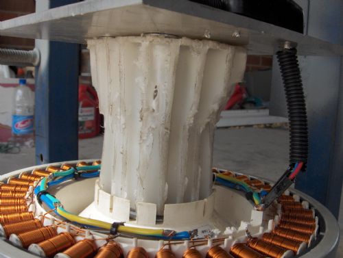

However after this happened I put the gen in the work bench and spun it up with the drill , I noticed ( with it connected to the battery bank ) that the power needed to spin it up so as it made some amperage ( only about 6 or 7 amps ) was huge .The drill nearly had a hemerage after I gave it to it to see how much it would put out , the more it produced the more the torque it required . Lots of power needed to make power.!!!
I will up load some pics to see what I mean.

Hi Greg
Sorry to hear about the mishap. Its a nice looking machine so far, will be interresting to see how it runs.
Once you get it back together, measure the output voltage and get back to us. The rewire you've done might give a lower voltage than you need for this application, but thats easily fixed with a soldering iron. Thats a 80 series stator, and you've done a very neat job on the rewire.
