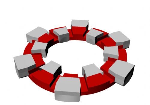

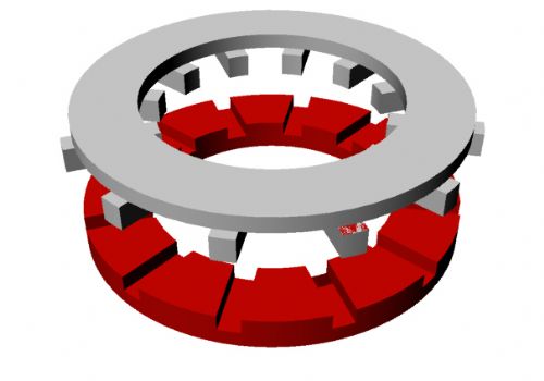

'Innovative ideas' are usually cheap or free and when it comes time to innovate ... well somebody forgot to tell the designer there had to be an economical way to fabricate the parts. With that in mind, I present a novel approach, or not so novel if one immerses oneself into older publications, on building an axial flux generator.
The first model is of the stator and magnet plates. This shows a wave wound thin stator. If my numbers are correct, I should get ~50 turns #19 AWG wire I should have twice as many 'cuts' of the flux as a 12 magnet 9 coil machine and a greater flux density. (.0359" diameter wire, slot is .345" X .25" deep and 60% fill was used.)
One question is how can it be wound. My second model should explain the top and bottom coil winding I plan on starting off lining the slot with 6mil polyethylene with a couple of straight pieces of fiberglass as used in roving or chopper guns. Then, the copper will be laid in trying to keep the lay somewhat straight When the turns get to proper fill, more glass fiber will be laid in. The coils will then be clamped with the jig shown, the top pulled, a calculated amount of resin and hardener applied and the plastic wrapped over the top and back into the clamping blocks.
After curing, the coil will be removed. A second coil will be wound in reverse and treated the same. A third coil form will be used for the center coil. The three should mate and fit flat I'm not sure how I will bond all three together. I do have some ideas. I will try to leave turns at the outside and inside as free of resin as possible for heat rejection. I will use a lot of resin saturated glass for strength.
Proposed magnets are 1" X 2" X .5". Inner circle is a 4" radius, outer circle is 6" radius. Magnets will have a layer of glass fiber (edit: finer- typo) laid on tops and sides, bonded on before placing the magnets on the rotor plates. There will be minimal epoxy used to bond and pot the magnets. A few turns of stranded glass will circle the magnets as well as a strand or two of Kevlar.
Coil length figures 61" a turn or about 304' per coil, 2.45 ohm. Total copper weight about 3.5#.

Ron, are there 12 coil legs and 24 magnets, or am counting wrong? thanks, pepa

You are correct "12 pole".

Hi wdyasq,
I suppose my AxFx machine is not wave wound, but has interleaved coils at least. I am intrigued by the amount of wire needed, 3.5 pounds. My completed stator with wire and glass filler only weighs 350g.
What expected power output and what output voltage are you hoping for? If you are planning on leaving the inner and outer turns free of resin, I am intrigued as to how this stator can then be mounted.
Gordon.
PS edit: the arrangement you have is difficult to picture. There appear to be too many magnets, but this may be the 3view. On closer inspection with the top plate reference, this will be OK. Escher would be pleased.Edited by GWatPE 2009-01-21

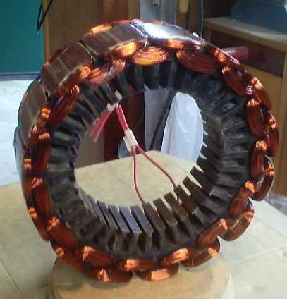

Leaving the blue phase as it is, you will have to rotate the purple phase 10 deg. CCW and the green one 10 deg. CW. Either that, or reverse the start/ending connections of the blue phase, if you want to end up with true 3phase with 120 deg. phase shift between the phases.
As you already mentioned, the idea is not new:
Your wavewound method will yield you the equivalent of 6 normal (round) coils per phase, so 18 coils for the entire generator, whereas the common axial flux has 9 coils total (3 coils per phase) in a 12/9 dual-rotor axial flux generator.
If you can build it mechanically, I think you're on to a winner. You will have much more copper (kg) in it than in a normal axial flux, which should translate to lower resistance and thus less I^2*R losses. If you can build it flatter than the normal axial fluxes too, you'll have a stronger magnetic field as well, so can get away with even less turns of copper wire, i.e. less resistance and power loss.
I think I would try to wind all the three phases in one go on a mould (with some glasscloth already in it before winding the first phase), then impregnate with epoxy, rather than your plan of winding the three phases individually and then try to mount them together, but we already discussed that.
The stator will take more effort, time and care in building (needing more and elaborate moulds), but it should be doable. And yield a superior generator.

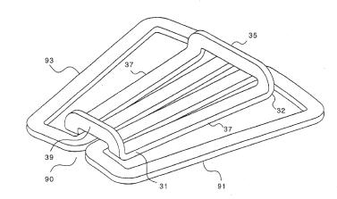

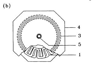

Edit: you may want to look at this patent (5.744.896) too: http://www.google.com/patents?id=iesnAAAAEBAJ&dq=5744896 Not a wavewinding, but still... the method described in this patent using discrete coils looks more easy to execute in practice.

Very nice rendering. Interesting design. What power are you aiming for, at what voltage....It would be helpful if you would provide enough information to form a useful opinion on this design (hehehe insert evil grin here...)
Ok, your stated resistance is incredibly high, and I would hope that you are aiming for a high voltage machine... otherwise I^R losses will kill this off for any useful power . In star it will be 5ohms or so. I don't fancy putting too many amps through that setup. Mine is about .6ohms, for 48v 130rpm cutin and I keep it to less than 20-30A at furling.
Without the voltage figures and expected power outputs, we can't determine how effective you will be with the cooling idea...... which brings us to the mounting as Gordon has pointed out..... how is this to be achieved?
This article on Fieldlines discusses the pro's and cons of this design.
I think that this is effectivly what you are describing.... may have to look closely:
To get useful output you need to aim for sub 1ohm resistances at 48v in either star or delta. I assume you will be going star?
If your voltage is 250v or so, then 5R is ok, if at 24v then at 240 watts you will have 10A through your 5ohms in star... so losing E=IR = 50v lost in the winding or 500watts?... in Delta, it will do considerably better r=2.5/2x10=12.5v or 125 watts lost.
Need more information.... but looks pretty sad on these figures.

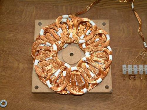

In regards to the "flattening" of the winding space for 3 ph design, this picture from Les Vincent (from Scoraig wind site) shows a radial version of the kind of layout you seem to be trying to achieve in your axial winding
this does 1kw@320rpm @70% efficiency.
or a completed one from Thomas Moore (NZ)
Perhaps Dinges, you should do this with your induction motors Edited by oztules 2009-01-21

It seems as though something else I have made has now been patented by someone else, many years afterwards. This goes in the same bucket as SplitPiConverter.
I was able to wind my coils in such a way as to keep the phase to phase resistance the same though.
Hi oztules,
I am a bit puzzled by the resistance as well. I have 187 turns per phase, and my mill produces 30VAC at 400rpm or so, giving 160mV/turn at maximum power loaded.
Hi Ron,
Your stator has 50 turns for an equivalent 6 coils with twice the wire length in the field to mine, with at least an 8mm magnet spacing. I have 22 magnets per rotor of half the size. I would equate this to your design having a similar amount of magnet, at a wider spacing. My alternator has approx double the output frequency for the same rpm. Your stator is equivalent to 600 turns at half the frequency of my AxFx alternator, with half the magnetic field strength.
I will guess here, as I am a bit tired and the numbers have become fuzzy, but I would expect approx 30-50VAC at approx 400rpm. I suspect this alternator will produce approx 500W at approx 75% efficiency. I think the 100-200W stator dissipation at full output may challenge the encapsulating resin.
I hope my estimates are wrong.
I spent the better part of a year testing coils and magnet spacings and configurations, before settling on the final design, that dinges has pointed out has now been patented by someone else, years after I built mine in 1993-4. Maybe I am just slack, and the financial renumeration aspect is too hard.
Good luck with the wave winding. Take care handling the windings once formed. partially encapsulated winding wire is easilt damaged by handling.
Gordon.

You have all given me things to think about .... and after having my ideas and ego bashed and shredded .... I will incorporate what I believe the best of the ideas are and refine.
My thought was to get as close to the Otherpower generic design as practical and see the differences.
For stator mounting my first thought is to build a hexagonal ring and wrap it with the stranded glass fiber. A very high glass to resin ratio will be held. I could then use short rods of fiberglass to secure the stator to the ring. What I want to avoid is the waste of resin I normally associate with these machines.
Some of the reasons I am using particular materials are I have them. I have about 20 pounds of #19 wire and a lot of the 1x2x1/2" magnets.
I do plan on doing some tests on a single partial coil and posting results. I am waiting to have some plates cut.

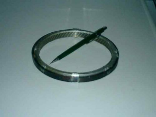

Oztules, I've actually considered doing something like this. About a year ago I checked the motors whether they had a perfectly round outer stator (no flats/slots/etc.). Only one of the 6 or so I checked was perfectly round. I'm saving that stator for exactly this purpose.

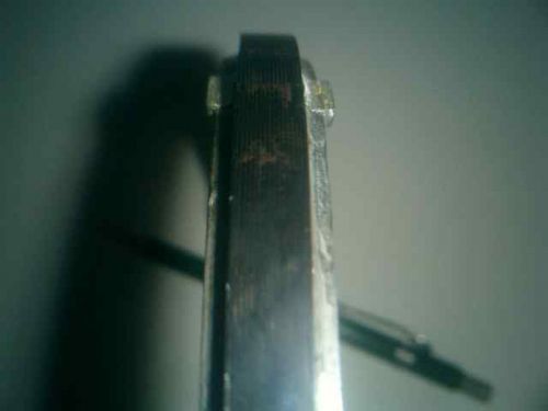

Recently I stumbled upon this rotor from an old ceiling fan:
After removing the aluminium casting bits that were in the way, I ended up with a perfectly round laminated iron core, 10mm wide, 153mm outside diameter. This should make a nice little (100W?) non-cogging iron cored radial flux generator. Likely will never happen though, as it'd only be a plaything. I'm not going to invest my time and effort building small generators, when nearly the same effort would result in an actually usable large generator. But maybe someone else has some use for this idea.

Multiple stator stacking has been done before by a few people on fieldlines. The only thing it seems to be better at is making for a smaller diameter unit. Other than that, it's all negative. (poor use of available magnets, and copper).
Unless there is a pressing need for a smaller diameter unit, better use of resources will be a single larger unit with the same magnet volume..... interesting discussion here
...........oztules
Don B
Joined: 27/09/2008
Posts: 190
Posted: 07:07am 23 Jan 2009
Hi Oztules,
Thanks for the response, and the link to the Otherpower.com forum. Actually, the photo of the multi rotor machine sent in by Powerbuoy on 26-03-06 is very similar to the mechanical construction that I had in mind.
While I take the point that large diameter single airgap machine may make more economical use of materials (and perhaps be more efficient?) than a multi-rotor machine, there are some points that should be considered before we all walk away from the multi rotor concept.
The first point relates to the number of phases that you can readily fit into a single stator. Generally, the more phase coils that you have, the wider the air gap that you will need to accommodate them, and I imagine that the 4 phases that Gordon has used would be about the practical limit. A wider air gap means a less efficient use of your magnets.
The old bugbear of audible cogging (or clogging, if you are in to tap dancing) under load will diminish as the number of phases increases, and many phases are possible with a multi-stator machine.
As a flight of fancy, a two phase 90 degree displaced wave wound stator could be produced using something similar to a double sided printed circuit board. The problem is that the copper in PC boards is in the wrong plane (bad for eddy current losses), and is ordinarily way too thin anyhow. If you could somehow get thick copper each side and photo or laser etch the winding so that an adequate area of copper could be obtained with the thickness in the axial plane, you might have the basis for a mass produced multi stator alternator. Not really a back shed project though.
At a lower flight level, it may be possible to use wave or even double spiral lap winding with copper (or aluminium) ribbon, interleaved with insulating material a la capacitors? That would at least put the conductor width in the appropriate axial plane. Or you could do the smart thing, and use a kind of Litz wire, as Gordon did.
On the Otherpower site there was some concern expressed as to the effect on flux density of having more than one air gap per pole. Some seemed to think that having two gaps would result in only half the flux density in each, or somesuch.
While I would not have expected this with multiple magnets, flux density was also of concern to me, as, should the flux vary significantly across the air gaps in a stack, then the voltages produced by the stator coils would vary, and cause problems.
I have made up a rough rig and taken some flux measurements of different air gap arrangements with magnets that I have on hand From my tests, it seems that, as long as you have the same length of magnet per air gap, the flux in a closed circuit stack of magnets and gaps remains pretty uniform (length does seem to matter, in this case).
My tests were performed with two stacks of NIB magnets that are 21mm diam, and 5mm thick. The test stack was separated from the return stack by a magnet diameter, and 2.5mm thick steel end plates were used to close the magnetic circuit. For a single 3.6mm gap in both stacks with 1 magnet either side of the gap, I measured a maximum gap flux of about 8,600 Gauss (or 0.86 Tesla, if you prefer).
With a 3 gap stack, again comprising 2 stacks with end plates as above with each magnet stack set up as 1 magnet, 3.6mm gap, 2 magnets, gap, 2 magnets, gap, 1 magnet (ie equal magnet length per gap), I measured a maximum flux in each gap of about 8,700 Gauss. The attached photo may clarify my description somewhat.
As an aside, the maximum flux measured on the face of a single magnet in air was 2,900 Gauss, so the importance of having a complete magnetic circuit to concentrate the flux is evident. With NIB magnets, I gather that 10,000 Gauss (or 1 Tesla) is about the maximum flux density that you could obtain in the best of circumstances, so I think that 8,700 Gauss in a 3.6 mm wide gap is a very useable figure.
It was also interesting to note that the maximum leakage flux measured on the other side of the 2.5 mm thick steel end plate was only about 100 Gauss, so the plates don’t need to be very thick to satisfactorily complete the magnetic circuit.
The actual end rotor disc back iron would probably need to be 5 or 6mm thick to resist significant bending due to the magnetic attraction of the pole magnet stacks, but the intermediate discs would be more or less in balance from the attraction of the gaps on either side and would not need to be so stiff (once properly centred).
While thinner steel could also be used for the intermediate disc spiders, it is clearly not necessary to close the magnetic circuit at each rotor, and may even result in greater variability of the air gap fluxes. I have not tested for this circumstance.
I do wonder about the possibility of eddy current losses in a steel intermediate rotor disc from the alternating fields set up by the stator coils. Anything conductive, such as aluminium or carbon fibre, might well have the same problem. Maybe fibre glass would be best for the intermediate rotor spiders, as the centrifugal forces in a low speed alternator at least are not huge.
Incidentally, I have an excellent book published by Springer, called Axial Flux Permanent Magnet Brushless Machines. While I don’t pretend to have absorbed more than a tiny fraction of its contents, it is certainly the most comprehensive book on the topic that I have come across.

Hi Don,
The coils in my design are in the same plane. There are not multiple layers for the phases. All the phases are effectively side, by side. The air gap is not changed by the number of phases. The airgap is still 3mm, with a 2mm coils thickness.
On another point:
The main concern I would have for multiple stators in the configuration you are suggesting is how to mount the magnets that are in the centre sections. If these magnets are half the thickness and share a common iron support plate, this may work.
The number of phases; I don't see a real problem with the way I made mine, to make 5, or 6, or 7 phases. More phases just mean more rectifiers and in my case, less turns per phase. I was able to get 748 total turns.   I chose 4 phases as I needed a certain emf at a certain rpm and only one wire size. This dictated 4phases in the available air gap. For 5phases, this would allow 150 turns per phase. There would be a reduction in output emf for the same rpm of 150/187. For 6phases, this would allow 125 turns per phase. There would be a reduction in output emf for the same rpm of 125/187. For 7phases, this would allow 112 turns per phase. There would be a reduction in output emf for the same rpm of 112/187. etc etc. If I was to make a 7phase unit, this would translate to an operating rpm of 187/112 to produce the same emf and current per phase. The output power would be increased by 7/4. This would be the same result as say a rewire for for a F&P.
Gordon.
