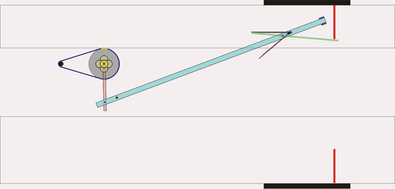

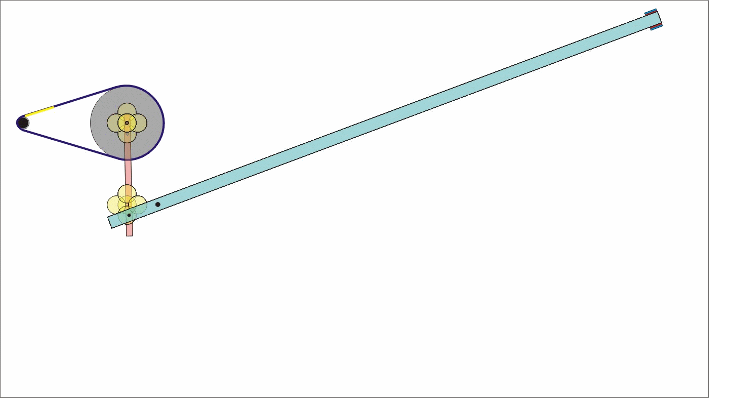

hi there guys,
John check it out i managed to show the mechanizim on how it is supposed to fly...i gusse...
the question is,..is it worth building just for fun?!?!

Hi faroun,
This is not as I imagined, but would probably still work. You may be able to use magnets as latching devices to hold the vane during the power strokes, a bit like cupboard door latches. Automatic furling if the wind is too strong with the magnets unable to hold the vane. Gravity would come into play and return the unit to the bottom of the cycle and reset the action.
I cannot see this being more than a talking point though.

True. But your frontdoor isn't connected to a generator and being loaded. The frontdoor behaves more like an unloaded windturbine in a runaway situation. It's important to distinguish between energy and power.
To the OP: Don't want to sound too harsh and rain on your parade, but this entire contraption looks silly and overcomplicated to me. I count 6 pivot points/bearings, and a belt. Not sure why you are wanting to convert linear motion into rotary motion, when it'd be much simpler to start with rotary motion in the first place. I expect it'll be noisy too, as the flap moves over twice each cycle. The repeated up and down acceleration will be hard on the mechanism as well (think 'reciprocating engine' vs. 'gasturbine').
But if you really believe in this idea then definitely go for it and build one, then report back here. Should make for an interesting story once it's finished and working.

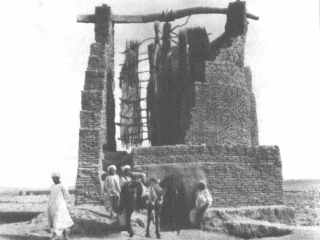

Peter, I have been to Afghanistan and I could not say for sure if that is an old picture or one that reflect current practice!
However, as far as I can tell such devices are drag machines and as far as total power goes very inefficient. As you will doubtless know efficiency and effectiveness are not quite the same thing and a big revolving door, or flapping wing, system might generate about the same power whatever the wind speed?

Converting linear motion into rotary motion (or reverse) isn't very hard to do normally. It was used in reciprocating steamengines as well. However, in that case the linear motion is longitudinal, whereas in Faroun's case it's transversal. And that case is a bit harder, requiring an extra linkage...
As to the efficiency... I was wondering how much mechanical power the VAWT pictured above could generate, and how it would compare to a modern HAWT. An inefficient contraption can still be very effective though. I bet that mill was pretty good at milling grain.Edited by Dinges 2009-02-07

like I stated at the begining, it was for the fun and for the challenge.
John, sees the faults in my design and yet he recommend to build it.
peter sees the faults but tells me it is waste of time.
it is funny to say I agree with both, because part of me thinks it is a long shot but the other side of the brain said to build it and try.
Silly maybe, but with a bit of love it might work!
thanks to the both of you and many more for your input comments, it is all about the challenge.
