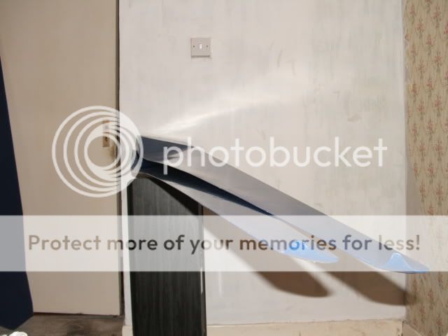

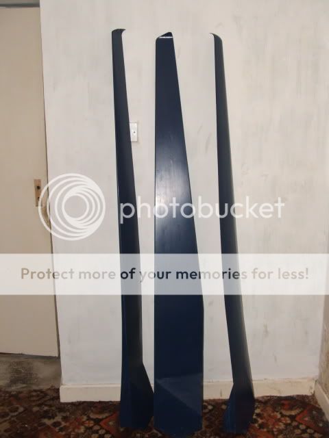

hi all
i think the winglet thing is interesting and hopefully will be trying these out later on ,(to cold at the minute) their roughly based on glider winglets (epoxied to the tips)
.these props are at my size limit so i think any add ons are worth trying
i wont be able to measure any results but less noise might be an indication ,if they have the opposite effect .....its pretty easy to knock them off , part of a winglets mission in life is to find something to break itself off on
edit... the room has since been redecorated ..
niallEdited by niall1 2009-02-13
