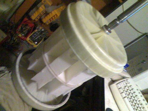

By some miracle, got myself two series 60 smart drives salvaged from F&P washing machines in the space of one week. Been searching at least a year for at least one
Anyways, crazy idea again...
Two F&P motors attached either end of unmodified washing machine shaft. One shaft is double male ended and the other shaft is double female ended. Rotors are missing on the photo but fit nicely.
The plastic/aluminium bearing housing is slightly larger than the usual DIY mods, I have extended the outer cut circumference for added strength and gives me something decent I can attach later to a base.
Stress on the shaft is balanced between all four bearings. Weakest point is where the thread of the two shafts join.
While I am tossing this idea inside my brain, anyone got links etc to other dual/triple motor designs using this F&P motor with no metal machining or making of new shaft etc required? Seen some nice photos inside this website, but nothing to wet my appetite and a web search does not amount to much in the "unmodified" dual (or more) stator design. F&P Murray's Diary does touch a little on the subject.
