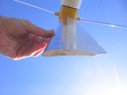

has anybody done a "fishing line" bump mod to the blades on the "NEW" a chinese 300W mill??
http://jaycar.com.au/products_uploaded/productLarge_11259.jp g
i modded the tips and sanded back to a knife edge but still would like to make a little quieter....
the fishing line mods that appear are for the old straight blades but the new chinese blades are much more curved,so i was wondering if the fishing line mod would still work?

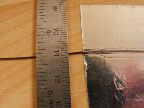

the line i tried was about .75mm , copying the fieldlines post ...
i was kindof going by the bergey blade i seen at eirbyte which had very fine ridge (at a guess it was about .2mm on a 1.5 m blade)..... surprisingly small
my prop has a wider cord so i upped it a bit
if you try a fine line its tricky to get a pronounced ridge when you tape it ...like the guy in the fieldlines
post suggested you need to run your finger nail along the line sides to kind of lift it
playing around with different thickness,s of line for a particular blade might be the only way to get some kind of result...i have lots of neibhours so noise mods are always worth trying for me

heres what i tried almost 1mm thick
the origional bergey ridge really is very small about .2mm
it just looks like a slight manufacturing fault
hope electronbaby doesent mind heres his mod
i used aluminum tape which sticks pretty well (to well as trying a slightly thicker line will be a pain in the )
somewhere around 1mm might be a good starting point ...3mm sounds big though

ok it works!!
i used as a temp test/experiment some 1.5mm multi stranded electrical wire that is round and has a pvc covering.
used some 90mm 3m tape to hold it in place
will keep a eye on it, and if all is good i will super glue some fishing line to the blades... permanantly

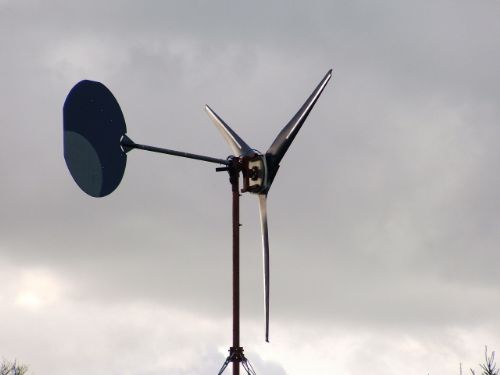

Sorry Richard, i assumed mine would be the new type as i only bought it last nov. but it has straight blades so we are running on different tracks. Am a novice with these bloody computers so wouldnt know how to put a picture on here even if i had one!
rgormley
Joined: 22/02/2006
Posts: 245
Posted: 01:20am 02 Apr 2009
look like this?
or
Edited by rgormley 2009-04-03
Posted: 01:40am 02 Apr 2009
Hi greengoblin, good to hear the blade mod has worked for you too. Its a easy fix to a common problem.

Gday Richard, sorry i never got back to you, my mill is the one in the first picture with the barn. Thanks Glen, the mod to the blades works great, dont know why or how, but dont have to! Yep those masts, especially the mounting plate leave a lot to be desired....cheers Pete.
