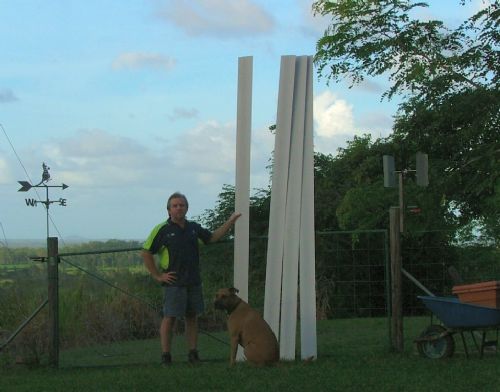

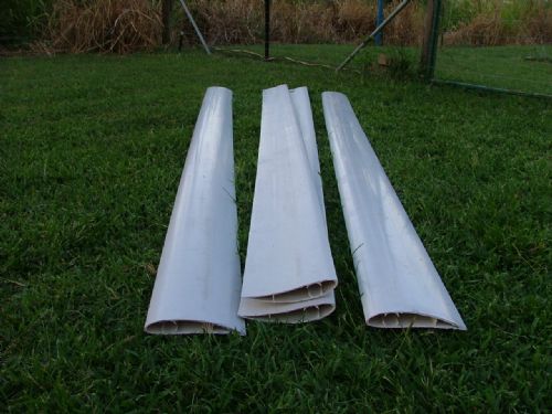

Hi guys.
Well they have arived, my sample PVC blades. Cant wait for the weekend
These will soon be available for purchase at a very good price compared to other options. They should be cheaper than those extruded fibreglass blades, and if your timber challenged like me, a lot easier to put together.
Each lengh is 3 meters and weighs 4kg. Chord is 160mm
Exciting stuff.

Looks promising Glenn , has a price been set yet ? ...Will be interesting to see the hub arrangement you design and their performance , do you require your piclog back ?
Posted: 12:00am 25 Mar 2009
Hey Phill.
No price set yet, but the idea is they will be too cheap to not consider, even for the hard core timber blade fans.
I forgot about the Piclog. Only if your finished with it, I can put another one together if I need to.

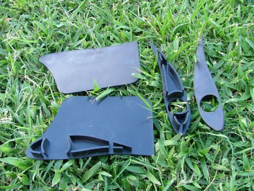

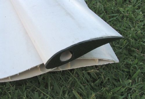

Those look really nice. I almost want a set for myself! (No I'm too far away in Canada)
Do I see a closed cell in the trailing edge? That will help torsional stiffness. The biggest part of the torsional stiffness will still be the tube down the center and the end caps.

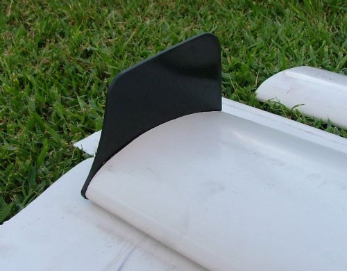

Very ambitious, adding a "plate" to the tip's end cap. I hope you have lots of spares because it will take a lot of testing to prove what works and by how much.

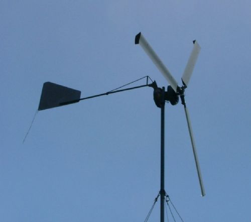

I'm going to fit a set to my dual stator windmill this weekend, 2.6m diameter. Standard 1 inch exhaust tube will fit up the middle of these blades, and for the first 400mm from center ( most stressed part of the blade ) I'll slide in a length of 22mm steel rod. The 22mm rod is a neat fit inside the exhaust tube. I'll buy these today and post some pics as it comes together. Will keep an eye on the weight as I go.

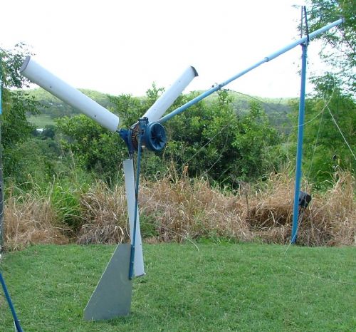

Hub mounting of a formerly available extruded alu prop: The pipe of each prop was bolted via two U-bolts directly to the hub. This allowed altering of the angle-of-attack.

Just what I was planning Dom. I'm going to use the hub I made for testing the Chinese fibreglass blades.
Makes it easy to change angle, though I think I would prefer a 3rd U-bolt for each blade.

keep an eye on the weight. Low inertia is hard to beat. My wooden blades weigh 600g each. The amount of steel and the adapters needed for the PVC ones will add up. UV protection with a decent thickness of UV block paint will add more again. I hope you can keep the weight below 1.5kg per blade.

I agree a low inertia turbine with give a small gain in a gusty location, but thats not what I wanted.
My timber blades weigh 1.2kg each, my PVC blades on the 2.6m turbine were 2.3kg each, and I had 6 of those! My Southern Cross windmill has a dozen steel blades, the whole turbine would be over 25kg. All these turbines worked perfectly well for me.
I could replace all the steel blades on my Southern Cross windmill with hand made carbon fible blades, save 10 or more kg in weight, and maybe it would pump a few more liters per day, but does that mean I should abandon the Southern Cross windmill just because its got a heavy turbine? No, because what it has works perfectly well.
Yes if I spend the time I could make a lightweight blade, but that is not what these blades were designed to do. Remember these blades were meant to be cheap, cut to length and easy to put together. We used the same profile the Windcharged turbines have used for many years, see http://www.royalfabrication.com/. The PVC used already has a good UV resistance ( I would need to contact Wes to check the exact ratings ), but yes your would still need to paint them, PVC white isn't a pretty colour.
I could have a high performance lightweight blade made, using fibreglass or carbon fibre, in a range of lengths and TSR's. But it would cost you many times what these PVC blades are worth, and you couldn't experiment with them.
These are blades for the people. If you want the best, then dont buy these, go and make your own. But if you just want a turbine thats a little heavier, a lot cheaper and easier to make, and has 80% or better of the performance, then these are a good choice.

These blades seem to lend themselves to being perfect to experiment with the Jacobs pitch control... ready made for it in fact. The 1" exhaust with the 22mm down the middle for the root area, is just perfect for the beginnings of the Jacobs pitch system..... I'm starting to feel some pangs of experiment coming on

Given that the heart of both systems is the triangular synchronizing spider which has to twist and "rise" at the same time, then the only difference is how to generate the input/output variables.
I think three big outside springs to pull the blades back in (jacobs) looks more reliable than the little single turn ones to rotate the blades back in.
Using the blades for the weights is less bits, and these blades of Glens have the "line bored" holes up the center already... most of the problems solved at this point. Line boring wooden ones for any distance seems problematic for me.
So with Glens blades, and the spider being required for both builds, the Jacobs wins hands down for simplicity...
Spider, hollowed out blades to rotate around the center spar, and 3 big springs to return it and so by default be the safety part as well.
So I think the Jacobs in this case.... purely because the blades seem to be made for this type of thing... and simplicity.
