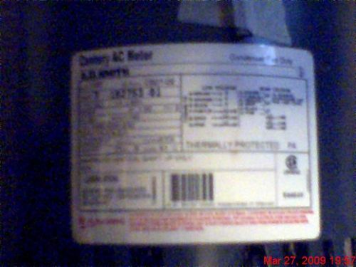

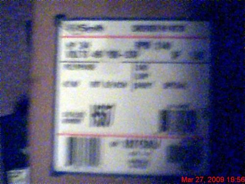

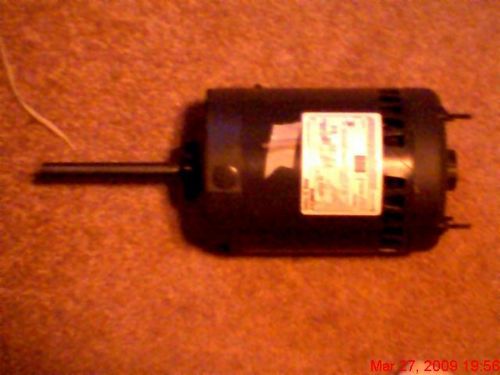

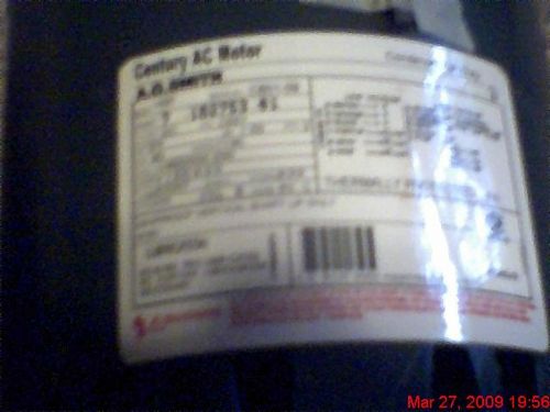

Hey I just pickup this new motor today. Its a
A.O. Smith
Condenser fan motor
3/4 Hp
460/200-230 Volt
1140 Rpm
Polyphase
Cat no: H567
Any sugestions on how to convert?
sorry about the pictures cheap camera.

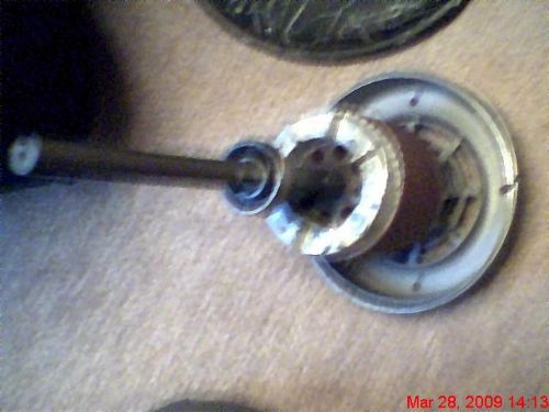

I would rate similar to the photos. The shaft is pretty puny. If you desperately feel you need to do a motor conversion, dinges may add some.
Gordon.

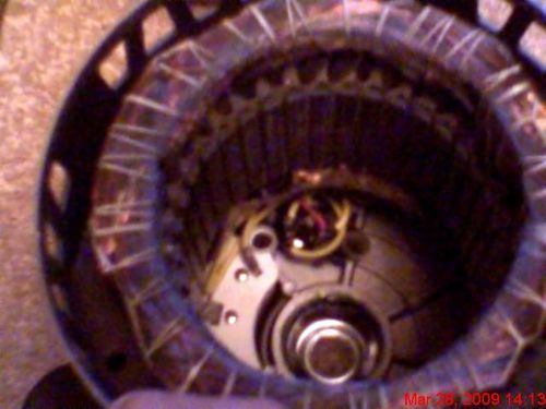

I tend to agree with Gordon on this.Those condenser motors often times have cheap sleeve type bearings and looks like that is what this motor has.
They don't want to make them too tough otherwise we would have more maytag repairmen outthere
There are better fish to fry.Keep divin

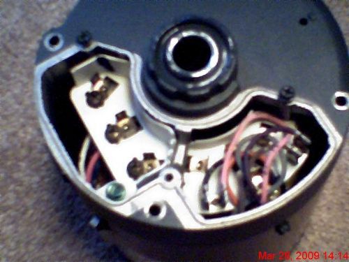

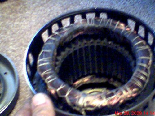

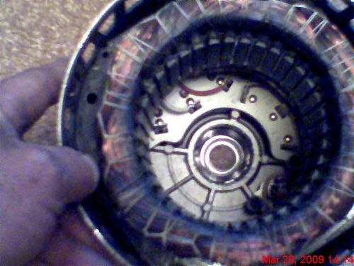

here is a few more.
the shaft is 7/8 ths just inside housing. was thinking of beefing up shaft on out side with sleave up to the tapper at the bearing.
divemaster1963
Joined: 28/01/2009
Posts: 46
Posted: 08:19am 28 Mar 2009
The bearings seal to be pretty good. they are the same sealed bearings i have on commercial mower pullys.

I was thinking of posibly mounting this further back on the mill, use a sleave over shaft supported with a block pillar bearing thats low friction high speed. any sugestions on nuber and size of magnets i should use. hey I got this motor for only 20.oo us. brand new in box.
