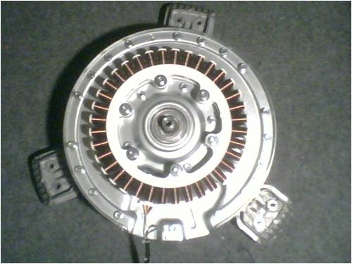

Hi im a new member and have a question hopefully you can help me with this.
I read on the forums that you can use the motor inside of a lg washer to produce power for a windmill and so today I went and found one and now my question is I plugged in a meter and it read about 100 volts as I moved it by hand it powered up a 40 watt light bulb so i was wondering if their was a way to find out what is the max watts that this produces the model of the washer is wm2233h and front loader could anyone tell me how to find out ?

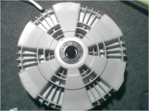

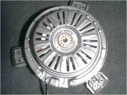

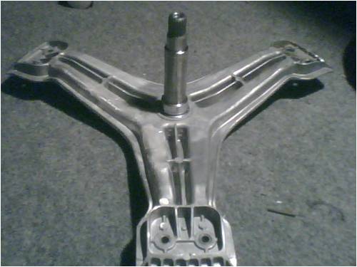

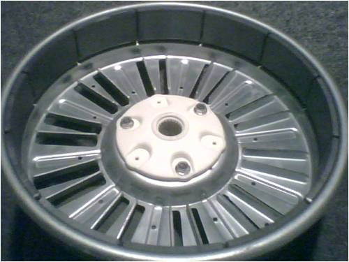

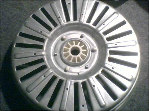

DTV004
Joined: 30/04/2009
Posts: 65
Posted: 05:11am 30 Apr 2009

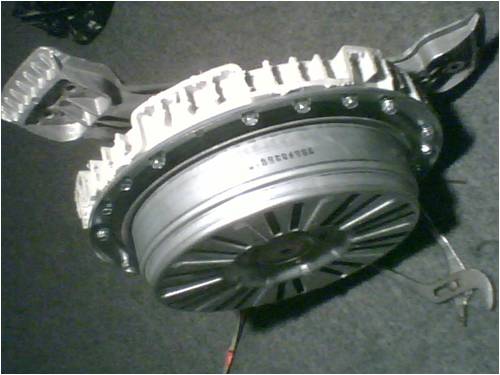

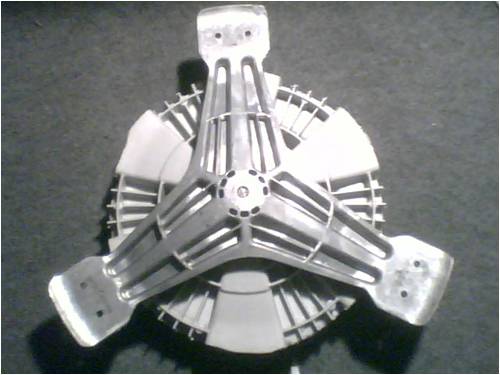

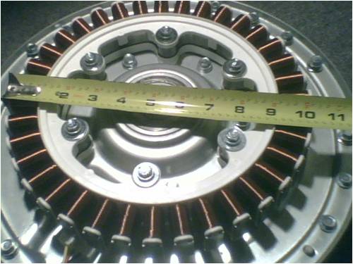

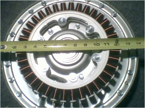

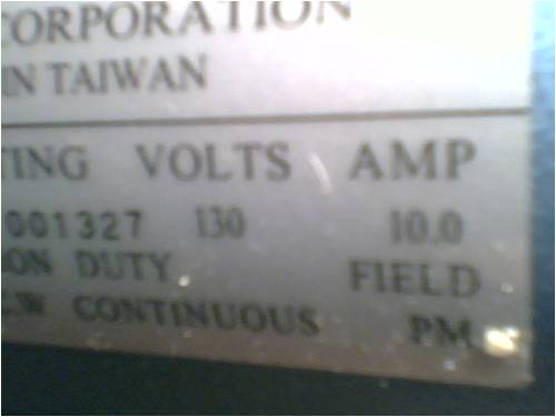

ok this the photos from the lg ..

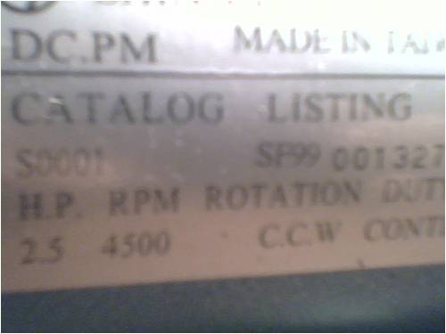

I moved it by hand it powered up a 40 watt light bulb so i was wondering if their was a way to find out what is the max watts that this produces?
If you can find the ID Tag, Motor Data Plate Volts-Amps.
This will tell you what the wiring in the motor can handle without over heating. 120 VOLTS * Full load Current AMPS = Watts. There is Rectifier loss to charge batteries and Dc to Ac converter loss. Most people get about 170 watts in a good wind. Not worth the cost of a windmill and all the equipment.

Posted: 05:47am 30 Apr 2009
I Just now saw your pictures and your post, If you do all the mods. you can upgrade the output , It'l cost ya.

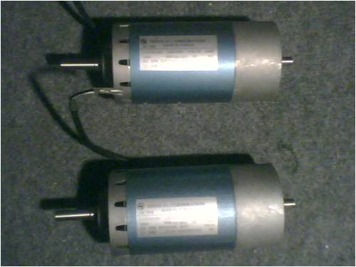

  Greenbelt said   I Just now saw your pictures and your post, If you do all the mods. you can upgrade the output , It'l cost ya.
ok i bought these motors from ebay three weeks ago and i recieved it about a week ago they are 1400 watts 10 amps each and like i said before in the previous post i already ordered the propelar from ebay will this do the job if it does what type of power regulater will you recomend...thank you.

ok do this one will do the job..
