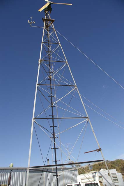

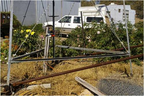

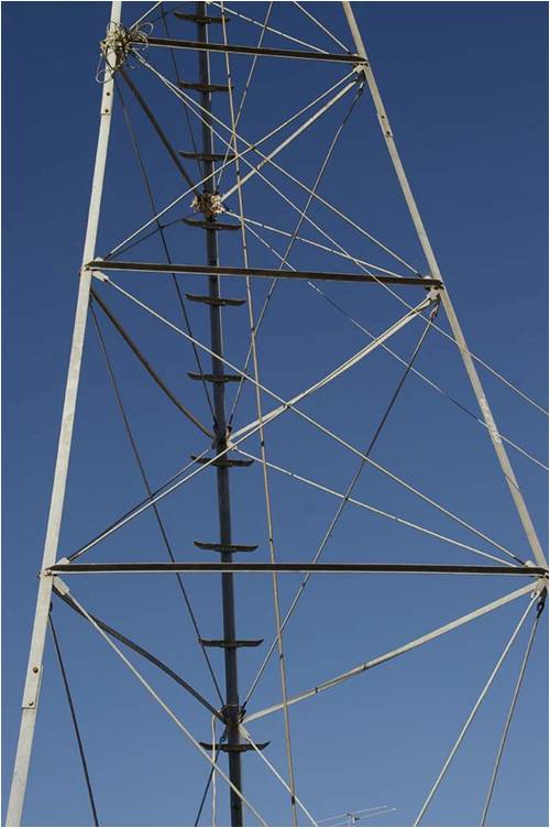

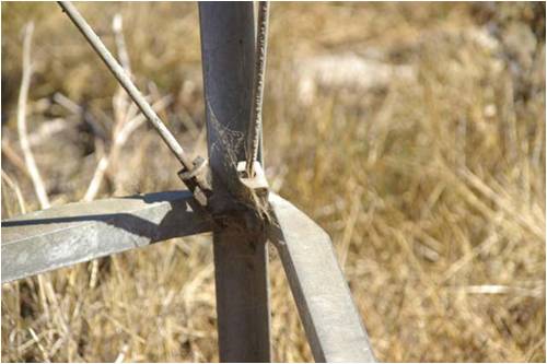

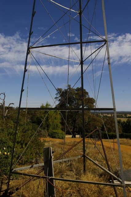

Are these what you are looking for?

These are really helpful. Thanks. Wind energy here in the states is really gaining momentum now that two things have happend. Most states now have net metering laws now so you get fair compensation for the extra electricity you generate. Secondly there are some federal tax insentives which will help get turbine maufacturers early sales which will then allow them to refine their products and lower costs.
My biggest problem is that all the towers that are popular here are massive steel mono poles which require yards of concrete, a crane, and they are really expensive $4K USD. The older lattice towers are soemthing rural people can assemble, and have stood the test of time.
What size turbine is on the top, output and blade size?

Posted: 02:25am 10 May 2009
The tower I show is quite typical of windmill (pumper) towers in OZ this one had a 10' Dunlite on top was around 50 years old when I pulled it down. They were heavily galvanized and stand forever provided you watch for galvitic reaction at the ground points, as many of the old turbines used the tower as the negative return.
It currently has a conversion on it with 10' blades tower is 40' tall.
The restored unit is shown http://www.anotherpower.com/gallery/allans-place
