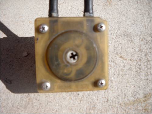

This is a little "peristaltic" pump. Two cams inside "squish" a rubber
tube inside the thing as it turns, pushing a small bolus of air.

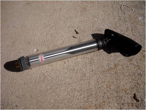

This is the little $10 bicycle pump I destroy making my piston pumps.
It's easier to buy these than to reinvent the wheel (my specialty!).

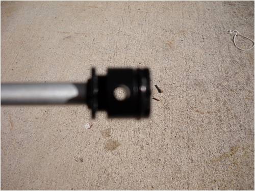

This shows the "missing" o-ring on the business end of the pump plunger.
Sorry it's blurry; close-ups do that with my little camera. Better than nothing!
Removing one o-ring gives the windmill a 180-degree-chance to
catch up to itself after mashing the air pump with a built-in cam.

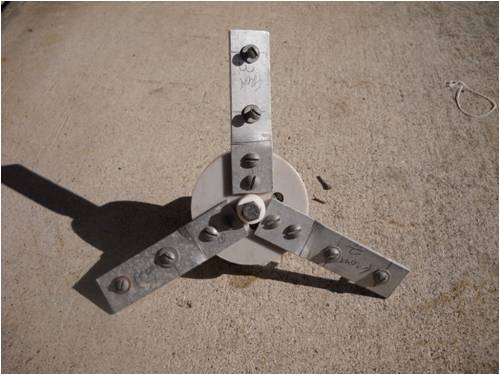

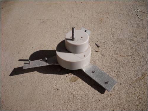

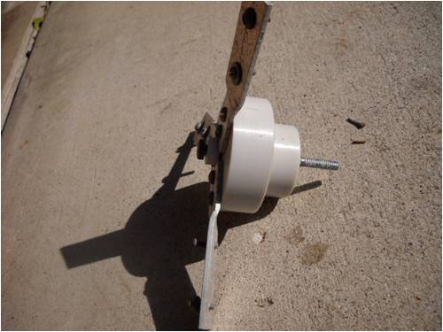

Here's a simple "DYI" hub and blade-mounting system.
Note the little plastic "cam" set off-center. This drives the piston pump
once per revolution. it works like a champ!
This shows an easy way to set the pitch on the blades; just twist the mounts!
