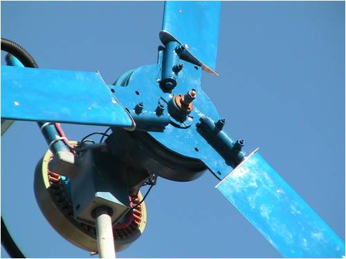

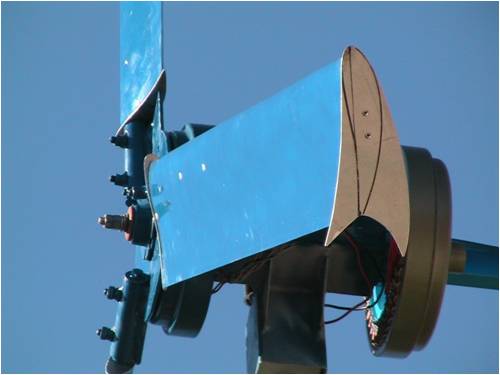

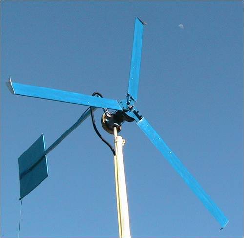

Jim, here are some pics of what have done so far with new blades. Am using 1.5m length which makes overall dia. 3.4m. Have used 1/4"plate and XH pipe for sockets and trust this will hold. If not will go to a 1/2" plate base of an old microphone stand.
Am happy you got your blades together OK.

Pete thanks for all the great photos. That's a fine mill you have there. Just as soon as I get something
that resembles a mill I will post photos.
  RevUpWind said   Jim, here are some pics of what have done so far with new blades. Am using 1.5m length which makes overall dia. 3.4m. Have used 1/4"plate and XH pipe for sockets and trust this will hold. If not will go to a 1/2" plate base of an old microphone stand.

Just a comment on new PVC extruded blades, at 1.7 could not get enough RPM so cut down to 1.4 radius and with a dual stator F&P rewired with 1.2mm wire and one a double Delta and the other a double single phase I got 36 amps right when it went on to dump at 14.6 volts. Slight bit of helicoptering at 9'blade angle but running smoothly.
But generally only sound is one of wind in the trees.
P.S. Do not, I say do not forget to put a locking nut on furling arm.
