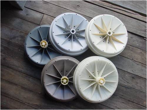

Have been testing different setups and have just noticed
that some rotors perform quite differently on a bench
test using the same wired stator?
So now am checking for best performers.
Does anyone know what is happening here?

the brown rotor seems be produce max. output.

From a manufacturing point of view, its quite possible. Depending on who makes the F&P Smartdrive magnets, there may be batches with more or less magnetism than the norm. As a motor, this isn't really a problem, the controller will adjust the input power as needed to achieve the RPM required. Its designed to do that, adjust to different wash loads. But as a alternator, as you have found, it can make a difference to the power we can get out. Its possible two identical motors used as alternators could have a difference in power output by a few %.
Interesting. Anyone got a gaus meter?

Harold, by brown I think you mean the pale sort of brown
translucent rotors and that is what we used today. It
showed 18amps while a grey one showed 10amps in similar
situation.
Glenn thats very interesting and methinks a gaus meter
measures magnetism? Is that like degaussing your
TV.
More things to think about when putting these things
together.
Peter

I came across the folowing rotor colours:
light creme the first single magnet rotors: ~10% less
creme speckled
common grey
light grey
translucent creme
speckled brown - best output: about 1amp more then grey
I did some test old single mags, creme against grey and the brown one.
Harald

The speckled brown type is more rigid as well. Better all round, but not very common.

here is a picture from different rotor colours
