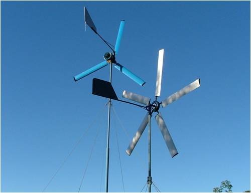

Hi Everyone
Dozens of orders for the PVC extruded blades have been sent out, mostly around Australia but a few oversea's ( freight is the killer ). So I'm wondering how they are going?
Who on the forum has a set up and going? I would really like to see some pictures and overall impressions.
To get the ball rolling, I have a couple of mills using the blades at the moment, a dual stator F&P windmill and a hub motor ( more on that build at a later date ) based windmill. Both windmills are making about the same power.
Phill has a set on his F&P dual stator and his new AxFx windmill based on Gordons excellent design.

Glenn, have two mills up with new PVC Ex blades and very
happy with them. Both x3 blades with dual stators @ 2400
dia. Have set blades both @8 degree angle and seem to do
well there.
Nice thing with these blades is that they are so easy to
balance and put together. A real no-brainer.
And the really nice thing is these blades are quiet. I
like it!
Have no monitoring gear but ammeter is hitting 45-50amps
in good winds, that's both mills together. Am happy and
just need to get myself a decent inverter.
Would be good to hear from some others and what successes
they have had with them.
Cheers for now
Peter

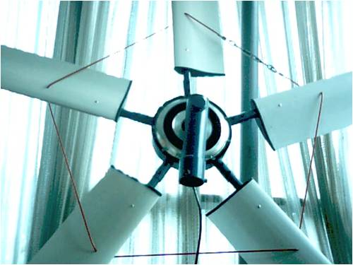

Have two mills up with extruded blades and no problems with movement on SS tubing or the 400mm root 25mm shaft.
One has joined blades and has 5mm x 10mm x5 rivets with x3 tapped screws into the 25mm x 400mm root section.
Other mill is as photo shows with full length blades and only three rivets. All OK so far and have had some reasonably strong winds to test them. But will certainly keep a close eye on it. Think next time have mill down with three rivets will add two more.
On my second mill instead of making the blade shaft adjustable I tapped a screw at approximate 8' and slightly elongated the whole in blade to make small adjustments to blade angle. These three screws have small washers to add more grip to blade.
Peter

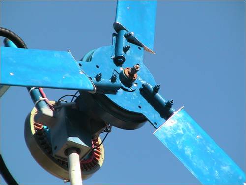

Wow , the subject of rivets or screws has really lit up , I think one thing has been over looked in this debate and being maybe the only person who has had the pvc blades move under extreem conditions 700+ Rpm on 3.1Mtr Dia , the movement that occured was the PVC elongating and not the rivet , if you have a look at the picture at the bottom of my latest post "Ax Fx - & F&P Dual" (sorry cant work out hyper link )
You will notice the bulge in the PVC as the material is trying to push up under pressure , would a screw with its limited bonding surface cope or start to strip the thread , at least with a rivet it is expanded internally and the only way to remove it is to drill it or sheer it with a cold chisel.
The rivet mearly acts as a dowel and weather it has a wide head or not I don't think really is the major concern , basicly it has to stay in the place it was put and stop the pvc from parting arround it so the more you put in the greater the load bearing capability will be . Also bearing in mind that we are securing basicly a flat surface to a small dia tube which only gives a very small contact area between the two mating surfaces really and has very little concern , the load face is approx 45% of the rivet circumfrence , so the bigger the better , the more the better
