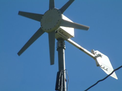

I am about to modify my wind turbine design
by offsetting the pole about 50mm from centre,
if i have rigid tail will this do anything ?
or do i still need to put a pivot point
for the tail aswell ? I only want it to furl in very strong winds.
Thanks.
Cameron.

hi Cameron
unfortunately ...just offsetting the mill wont be enough ...the offset will fight against the tail and the mill will just sit small bit off to one side ...the pivot allows the tail to lift and stay vertical making the whole thing (the machine itself) and gravity do the work
if the machine is your own set up you might have to play about with the angles (usually two) the pivot is set at... it can turn into a welder/hacksaw session for a bit ... but it will do the job ...
i could never (and still cant) get my head around the process untill i welded a few bits of pipe to the back of the mill ..seeing how it works its much easier than reading about it ...
ps...thinking a bit more about this there may be a simpler way ..you might be able to leave your tail rigid and attach the tail vane on a offset hinge...i think some rutland machines use this approach but i,m not sure how its set up , i,ve seen it once but cant rembember... ..., i,ll try to find out ... Edited by niall1 2009-07-18

Thanks, I like the idea putting the vane on a hinge
and leaving the tail rigid.

  niall1 said  ...i think some rutland machines use this approach but i,m not sure how its set up ...
Yes they do. I have one. Will try and remember to get the camera out next week.

Cameron, I did make one mill with a rigid pole and offset tail and it sort of worked in that in strong winds it would swing off the wind a little then quite quickly swing back. I dont think it is really a good idea.

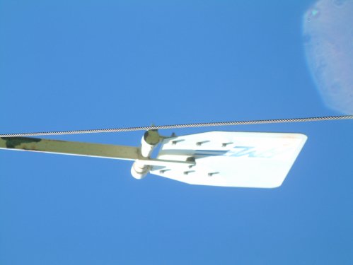

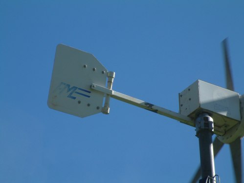

Showing the offset yaw axis, hinged tail and tail stop arm fitted with rubber bump stop.
The tail rests on another rubber bump stop on the small tail positioning arm.
Looking up from the ground. The non vertical hinged tail uses no springs just gravity.

nice Explanatory furling pics .. ...so much for my memory then ...Edited by niall1 2009-07-22
