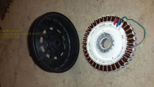

Hi there all,
I am planning to make a dual f and p mill using one of trevs remilled shafts.seems the only way unless anyone has any other suggestions of driving 2 f&p's. I have been looking at a lot of pics of dual stator setups but cant quite figure out how the 2nd rotor is secured onto the shaft without floating along the spline.
1)is there another nut that stops the rotor from sliding or a spacer between the fan and rotor. If anyone has some close up pics I would be appreciative of them.
2)blade daimeter. is a 3 metre 3 blade fan (using extruded blades) too big or over the top in power for this application. should I or could I go smaller. We live on the side of a hill with elevation and we seem to catch a lot of wind.
3) speed ratio. Has anyone out there dabbled in speeding up the mill with say 1:2 gearing for quicker cutin speed in low winds, maybe using camshaft cogged drive belts and pulleys. they seem to run quiet and transfer power well without any major loss.
4) 24 or 48v . which is best. planning in feeding into the grid at a later date and last
5) is using capacitors as voltage doublers. have read about them but not sure how it works.
I appreciate any response to my many questions. my brain is buzzing on overload..... marcus

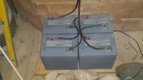

Are 4 car batteries(commodore, falcon) sufficient in size for the job? eeeeh!! possible to go smaller again??

I would think that larger car battries would work OK , they are only acting like a large capacitor and smoothing the dc out for the inverter. The tc48 as I understand does the same but with a large capacitor and when it is fully charged and the inverter has not caught up with the mill it shorts the ac to stop the mill , the problem with the F&P is it will not stop in this situation if the wind is strong with 3+ mtr blades , I would recomend battries, Plasmatronics PL20 and dump load and furling that works , if battries can be sourced cheaply this set up would probably be cheaper and more versitle as you can easily change the voltage set points on the PL20 and it can handle a 20amp dump load directly which is more than enough for two mills for future additions..

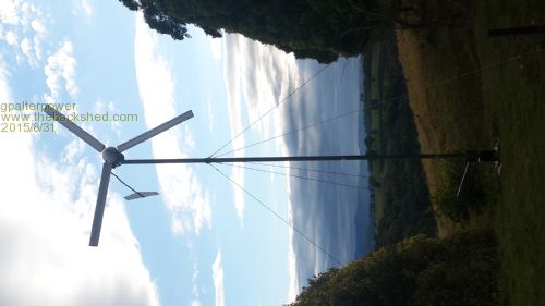

Posted: 07:32am 30 Sep 2009
Well I have finally started on my dual f and p mill. Phill, I really liked the the idea of your setup using the original bearing mount and slipping it into a machined pipe. Very neat! I have been working along the same lines.will post some pics soon. But for now I am requiring some help on my mast. I have 2 X 6.5m lengths of 75 mm thick wall (5 mm) gal pipe. I am planning of placing 1.5 min the ground to make it rigid. The top of the base will be 5 m high. Then Ill swing the other lengths off that making a total of 8.25 metres. what is an appropriate hinge to make or buy? Are 3 guy wire enough for the job ?
Any thoughts....regards Marcus

Marcus, i'd be going for 4 guywires and at that height 2 sets of.
8m doesnt sound much until its up in the air, then its pretty high, particularly with 30KG+ sitting on top.
4guys gives it sideways support as it goes up, three does not, hence less chance of it swinging sideways and killing you.

You' on the right track ,,but do go for the 4 guys.
Now another important point is the levelling at the "Guy Anchors",, the two side anchor points MUST be in line of sight through the base pivot hinge point..and preferably level---otherwise you will require to lossen one side before lowering and raising..
try to set up a lazer level to get this right...an hour here can be very rewarding..

I agree. This is important but not obvious until you try to lower your tower and see it slip to one side. Remember the windmill at the top swings around with a hinged tail chasing the wind. When the tower is part lowered, the windmill will swing and the tail will hinge, not necessarily symetrically. Expect sideways live loads on a part lowered tower.
You must have guys anchored in line with the tower base hinge. If one is slightly lower, it will go floppy when you lower the tower.
I got this wrong and watched my half lowered tower flop to one side and bend itself in a hard landing with the ground.

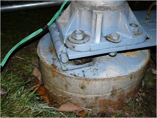

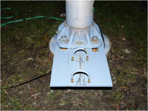

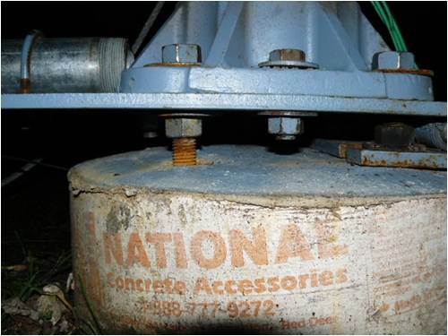

Posted: 01:48pm 22 Dec 2009
Marcus
Here are some photos of the base plate I made. I made this plate because I only use three guys and it will only allow the mast to till North South. (in my case) It did take some doing. You have to be sure the plate is solid. It has to be bolted and or welded in such a way so it will not get lose from the foundation or the tower will fall. (East West) With no side support wires the gine pole has to be very strong and ridge or it will bend and that would not be good.
My mast is 14.2m

Karl
Just trying to help.
I still think that a four wire system is the route to go, safer and easier to work with. I just don't have the space to use four support wires.
The base mount is much easier to fabricate and you can place your mill at almost any height.
