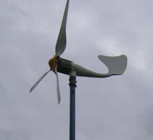

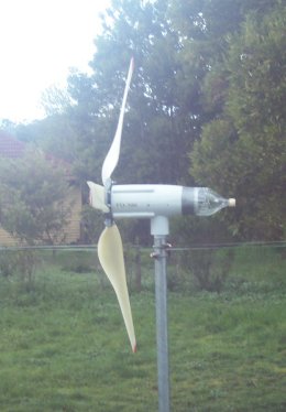

Here's a couple of pics to show what I am trying to do
The Turbine as it came out of the box
As it spent most of its time swinging offwind or recovering from it I researched both tail modifications & running it as a downwind turbine.
Taking a High Tech approach I decided downwind was a more interesting option & potentially more stable.
The tail was removed & a coke bottle sawed in half. The coke bottle cap was carefully torqued down to 5 ft/lbs & the bottle taped onto the body in place of the tail - the blades were then removed & reversed. Voila!! job done
It is now much more stable - I would go as far as to say perfect except it produces no power!!

The tail of that turbine in its original upwind configuration looks smallish and the tailboom looks to be short. Would've been interesting to see how it would have responded to (temporarily) increasing the tail surface area by bolting-on a larger sheet of plywood. Might have made all the difference. Also, the yawing pivot point seems to be pretty much to the rear, with the blades sticking out much in front of the pivot point. This increases the moment that tries to turn it out of the wind, and reduces the moment of the forces on the tail to steer it back into the wind.
The downside of downwind turbines is that the blades pass through the wake of the mast where wind is more turbulent and less strong. This causes cyclic variable loading of the blades, possibly leading to problems (fatigue) in the long run. And higher load on the bearings. I assume this is the main reason that we don't see many downwind turbines, as they certainly do have benefits (no yawing mechanism needed, for one).
I hope the torquewrench was recently calibrated so you can be absolutely sure that the bottlecap was actually tightened at 5 ft.lb?

Your comments mirror my research exactly. I am also working on a tail extension. I will compare the results & run with the system that works best
A point of interest - the downwind configuration actually vibrates less in high winds than the upwind one. I am guessing that the tail is so badly designed that it is contributing to the vibrations.
The torque wrench was recently calibrated by hitting my ex wife on the foot with it with a force of 5 lbs, the results were most gratifying

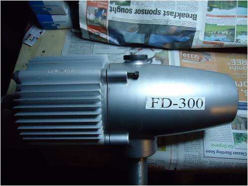

Here's what it looks like before splitting up:
After splitting it into alternator and the "body" (housing sliprings and yaw bearings) we can see the controller bolted up to the alternator:

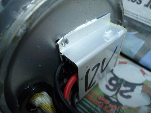

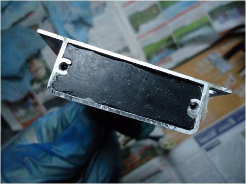

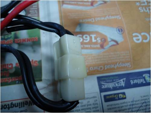

The controller is quite small and sadly it is filled with epoxy:

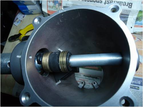

Here's the slipring assembly. Note one of them has 3 narrow shiny rings on it, indicating that the brush is not making full contact with it:

My ones have a similar regulator all potted but have 3 slip rings so I can send three phase down the pole.

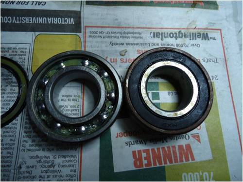

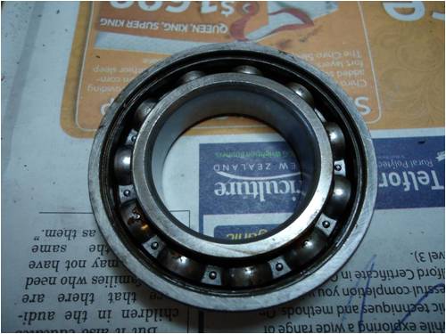

Took the bearings off, here's what they look like:
As Bob mentioned, this is the bearing that was hardly rotating, you can see rust inside and needless to say there was no trace of any grease in it - probably just a drop of oil:
I don't have a shop press so could not open up the alternator, and I don't want to use hammer anywhere near it. The bearings are almost fine on it, I am not sure if they make any noise at all, so probably will leave them as they are...
Will post further updates here, hopefully it will be useful for someone.

You can make up a puller with some threaded rod that will do the job. Not a good idea to put up without greasing the bearings as all the ones I have are dry or slightly oiled, as per the makers assembly lubrication.
The head bearings will last for years with a bit of grease even if a bit rough with rust etc.

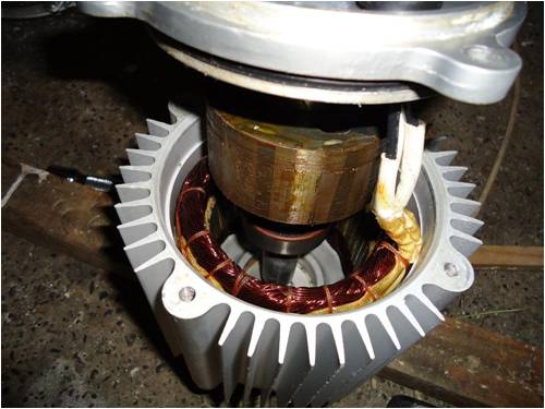

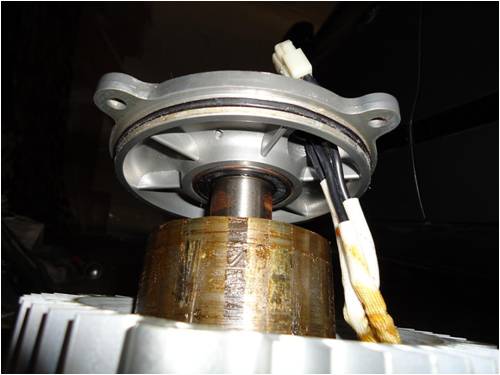

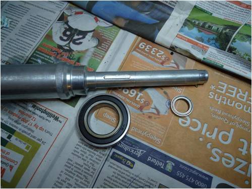

Thanks for your message. I opened up the alternator - actually was not so bad - I tapped the shaft onto a piece of timber on the ground and after a few times it started opening up:
For some reason they did not think having seals is a good idea so now there is a gap between the shaft and body through which the moisture can creep in, and it does:
So they put in a rubber gasket to seal lid to the body, but did not close the hole around the shaft...A proper way to fix this would be to machine holes in the end lids to accept one of the standard sized seals (or just dust lips), but it is beyond my abilities. I will probably glue some welt around the shaft once it is all back in one piece.
Took the bearings out - and behold these ones HAVE some grease in them!
I could have re-used them after re-greasing but I am replacing them with Japanese-made just to do it all properly.
So I guess that concludes the mechanical part of this turbine. I will update this topic once I get electronics done and when I do the actual conversion to the downwind.
