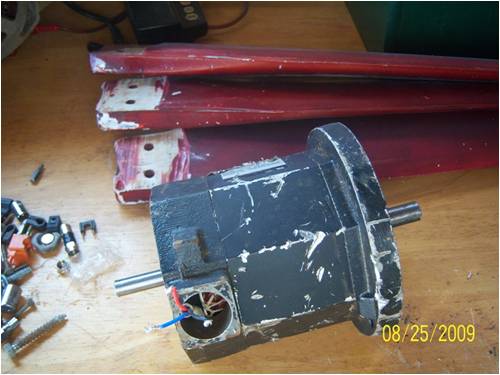

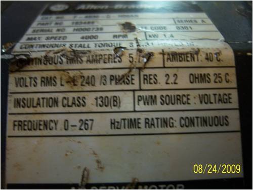

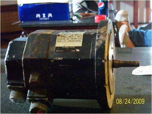

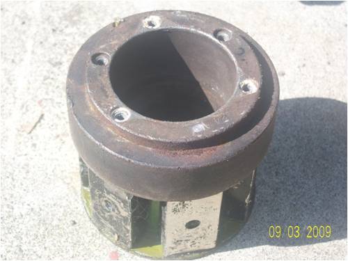

hi to all i buy 3 motors from the local scrap & metal and i like to know if this will be good for wind will, i have the propelers. so i will start today..pic's feel free for opinions...
Posted: 03:48am 15 Sep 2009
That looks like a AC servo motor. The bit at the back is a encoder.
Does the shaft rotate easily? Sometimes these have an internal brake that will need to come out before you can use it.
If it is a AC servo, it could make a good windmill. You would need to connect up a meter and give it a spin to see.

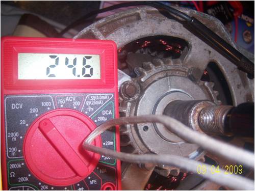

Posted: 04:31am 15 Sep 2009
yes this motor spin very easy i open the motor and the have 3 wires like my old alternator. i test the voltage hand spun results from 6v up to 45v i wil post more tomorrow...thak you
Posted: 08:26am 15 Sep 2009
Well it sounds like it would work just fine on a windmill then. All you need to do is add a 3 phase rectifier to those 3 wires and your ready to go.
Do you have access to a lathe? If you can find out what RPM equals what voltage, then you can make an informed quess about what turbine blades to use.

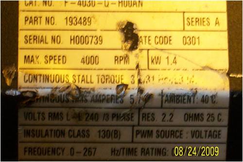

Posted: 10:13am 15 Sep 2009
A quick calc from the nameplate data. 400rpm gives approx 24VAC at approx 140W.

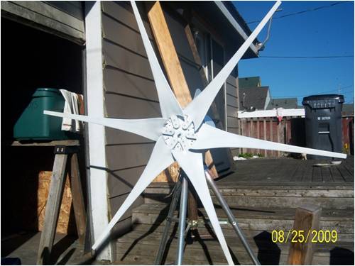

Posted: 01:57am 16 Sep 2009

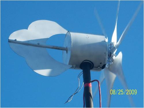

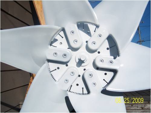

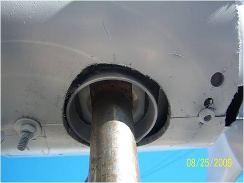

ok up date new pic.of my wind mill now i need wind...

Posted: 05:51am 16 Sep 2009
The winding resistance is 2.2 ohms. This is quite high and will limit the useful power on a 24V system. This was designed for 240VAC at 4000rpm. The wiring is rated for 5A continuous on the nameplate.

GWatPE
Joined: 01/09/2006
Posts: 2127
Posted: 07:50am 16 Sep 2009
  DTV004 said   thanks for the comment but im planning to use it for 12 volt bank so what your telling me is it wont be enought for 24volt system
The useful power is lower at a lower system voltage, without a rewire of the windings.
The maximum continuous winding current is the key, 5A. The 2.2 ohms is very high for a 12V alternator. 400rpm would produce approx 100W output. 100W would be dissipated in the windings as well. at this power level, half the power is lost as heat in the windings. The alternator would probably burn at higher sustained power levels.
I would look for a different alternator.
Gordon.

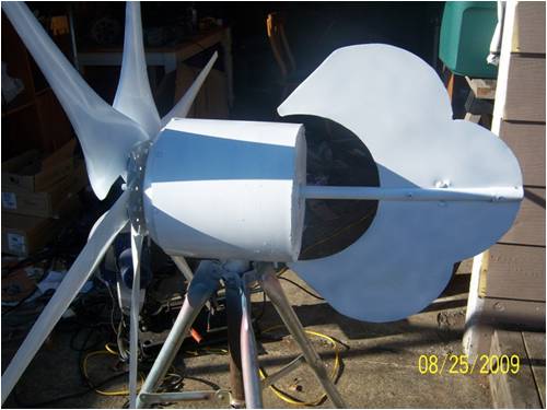

Posted: 01:19pm 16 Sep 2009
Hi DTV004
Thats a interesting looking windmill, it good to see windmills made from so many 2nd hand parts.
Gordons right, its good for only 100 watts or so, but I dont think it will have any problems with over heating. Those servo motors are designed to work very hard and last a long time. And it has a normal rating 1400 watts, so I dont think 100 watts of internal heating will have much effect. I would however take off the cover, let that black aluminum motor casing radiate any heat. If it does run warm, make a heat sink from some scrap aluminum and bolt it to the case to dissipate the heat.
I would also extend the tail further out, I think its a little too close and the turbine will struggle to follow the wind.
But apart from that, its a nice cheap windmill build. Its good to see parts destined for the scrap bin turned into something useful. It may not be efficient, but it will work just fine and could last for years.
Just adding, once you get it going, try it with only 3 blades. I think you'll find it makes near as much power as 6 blades, and you'll end up with 3 spare blades Edited by Gizmo 2009-09-17

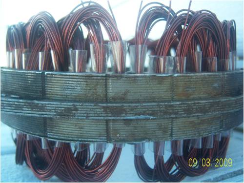

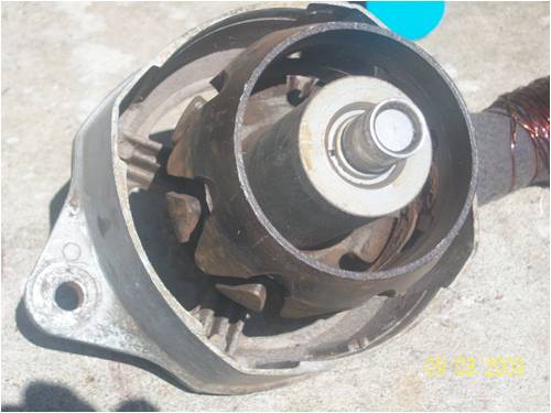

DTV004
Joined: 30/04/2009
Posts: 65

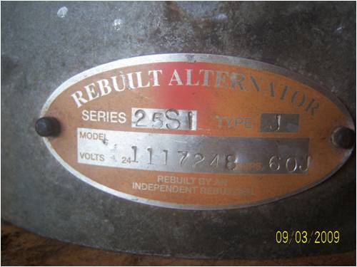

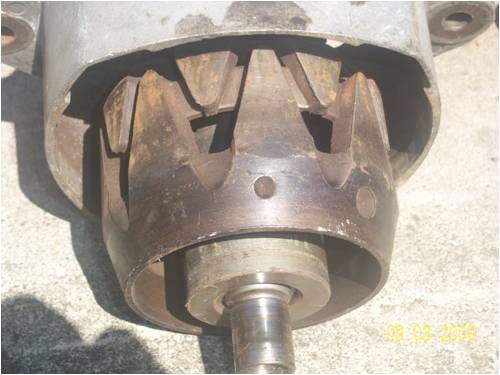

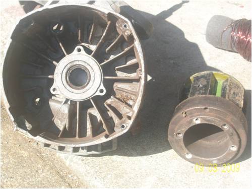

Posted: 06:14am 26 Sep 2009

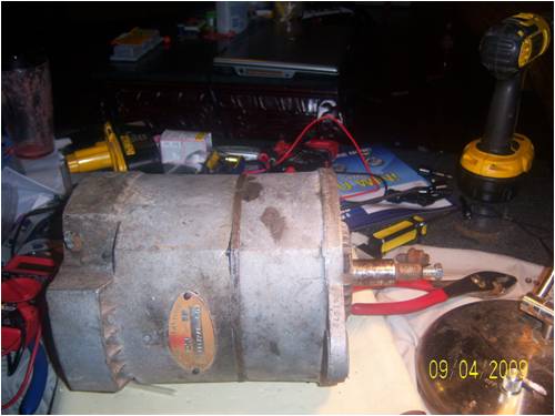

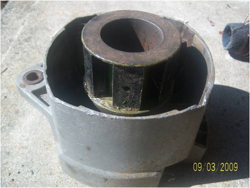

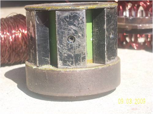

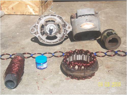

ok today i finish the altenador and works great! with two outputs 12v and 24v im happy ...pic.
nex the modelok i pull the wire and install the magnets
ok photos only to make more ease..
[/IMG]
[/IMG]
tomorow i will star to make the base for..i have blades from windynation i will try with this alternator .....oso sorry for my english
Edited by DTV004 2009-09-27

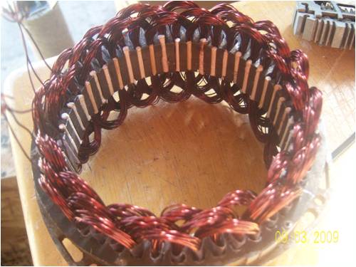

GWatPE
Joined: 01/09/2006
Posts: 2127
Posted: 12:18pm 26 Sep 2009
Hi DTV004,
If you get the chance you will get a better alternator if you make the windings tighter. This will reduce the winding resistance and allow higher output current and lower heating and a higher alternator efficiency.
Gordon.

DTV004
Joined: 30/04/2009
Posts: 65
Posted: 04:01pm 26 Sep 2009
hi i try to make the winding more tighter but no space the wire i use is from the same alternator the magnets are now on place. each winding have 16 turns i know needs to be 40 turns but i dont have small wire. and i dont know the size of this wire. to be my frist time i thing is more then good...super good, this mornig i will fix small details.
GWatPE
Joined: 01/09/2006
Posts: 2127
Posted: 10:12pm 26 Sep 2009
Hi DTV004,
This is not about wire size. There is a lot of excess wire length outside the slots. The layout of the coils in the slots you have, permits a physically smaller coil, with the same turns of the same wire, only a shorter piece of wire would be needed.
