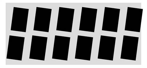

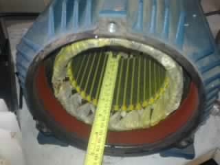

After a lot of procrastinating i have had a friend put my motor on his lathe and take 22mm off the rotor. This left the diamter at 84mm. I wrapped some paper around the rotor and the final measurements are:
267mm x 120mm. The picture is to scale.
The magnets i want to order are 46mm x 30mm x 10mm. I understand that since the stator has 36 slots i should use a 10 degree skew. It appears that i can only fit 12 magnets on the rotor.
Will the way i have set out the magnets create a cancelling effect ? or is there a formula i can use to lay them out ? (maybe another size magnet)
Any input appreciated.
Thanks.
Cameron.

Took me a while to work out what that picture was of, at first I thought the image resizing code was freaking out.
You didn't mention how many poles the motor has, 2 or 4, 6 or even 8. If your not sure you can work it out from the RPM. Is the RPM marked on the tag?

Its in the heading "6 pole conversion".
which is 945rpm i think,.
Thanks.
Cameron.
So this means i put magnets in every 60 degrees on the cylinder.
How wide can my magnet be ? Ans: no wider than 3 slots on the stator (36 slot stator)before you skew it 10 degrees.Edited by Smart Drives 2009-10-24

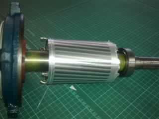

A few pics of the project

I have decided to use 6 large magnets, 75mm x 25mm x 12mm , if i can find them in NeFeB with an epoxy coating for durability. The picture of the magnet layout above will have slightly larger gaps now and only 1 magnet per pole.
Cam.
I found some 75mm x 25mm x 12.5mm mags with 45kg lifting strength , these should do the job nicely.
getting the rotor in and out might be interesting though.Edited by Smart Drives 2009-10-19

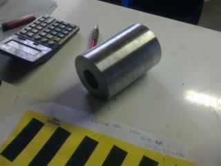

I would guess it weighs about 25 - 30kg, I am doing this project to learn everything that can go wrong in preparation for an 4.5kw 8 pole motor conversion. I am planning to put this motor on a 6m x 100mm dia. pole.
The next project (due to weight) might end up as a VAWT.
I'm getting the steel rotor made this week, so more pics soon. Yes if anyone is wondering why i lathed down the aluminium rotor i wasn't aware at that time it had to be steel. More mistakes to come soon stay tuned.

Magnets still haven't turned up, so here is a photo of the new rotor.
Thanks SparWeb it appears from what you said that i can slot the magnets in as far as i like with no loss of power.

[quote]Thanks SparWeb it appears from what you said that i can slot the magnets in as far as i like with no loss of power. [/quote]
No.. As you sink the magnets down into the rotor steel, you make it easier and easier for the magnet flux to "short" from the front pole top to the back pole.
If you make the air gap very very tiny, it will have much less effect, but with flat magnets in a circular stator, you will have a few more mm of gap in the center of the magnet face
If you sink the magnets in a few mm, it will have very little effect, but the further you sink them, then less flux will jump through the air gap, and instead jump straight to the steel rotor... and so back to the back of the magnet.
In the extreme case:
If you sink them right in, the flux from the edges of the front face of the magnet will go straight to the rotor, and it will be a dash through the door to see how many more can jump from the inner regions of the front face to the rotor until the flux is so thick there, that the rest have to jump to the stator and do the generating task you wanted them to do.
The harder you make it for them to short straight to the rear face from the front face, the more flux lines will be available to jump to the stator and so link the coils.
ie sinking them is a retrograde step if overdone. It's no where near so bad in the induction conversions as in the axial flux, as the axial expects the flux to jump a much much larger gap, so is far more inclined to take shortcuts and leak to the next magnet... or if sunk, then into the rotor steel... or both....but conversions suffer from much lower transition speeds, so needs all the help it can get.... it's never simple
Does that make any sense?

Smart Drives
Joined: 06/07/2009
Posts: 115
Posted: 08:23am 23 Oct 2009
Unfortunately it does make sense....
so would 4mm be to much ?
Thanks.
Cam.

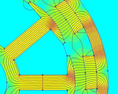

Great animation Sparweb, but not quite descriptive for this application... but excellent for 3ph understanding.
I can't find Dinges Femm of his conversion, so I will use this one from http://www.powercroco.de/magnetkreis.html.
Smartdrives, look at this. It is opposite to a conversion, as it is a motor... but the magnets and rotor steel are on the outside, and the teeth are on the inside, but the same rules apply.
In your case, this motor casing will be your rotor, and this armature teeth (2 of) will be your stator, and the magnets (2 of) will be your magnets.
Note the 2 flux lines linking the magnets to each other, this indicates leakage, and is worse when the magnets are too close together... or the gap is big.... the flux will take the easiest path home.
Note also, all the flux lines leaving the face of the magnet, return to the base of the magnet via a variety of paths... but they all must get there. No flux can go out without returning.... just like an electric circuit.
The small lines jumping from the sides of the magnets back to the casing, are the ones we are interested in with regards to sinking magnets. If you can imagine sinking them, it is easier and easier to return via this short path, rather than jumping the gap and taking the long route. Once again, a skinnier gap will help keep them interested in jumping the gap, a wider one will deter them, and they will cheat.... and jump directly to the case, or the magnet next door.... but they will go somewhere.... follow every flux line to get the idea.
4mm should not change things too radically, as the air gap should be very small at the edges of the magnets... but less depth would be marginally better I think...
Perhaps follow Dinges lead......if anyone knows what is going on inside these things... it is him and Sparweb.
