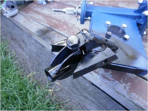

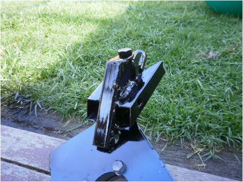

some notes I made of randys "weldment", it has no tail stops so you will need to fashon some up, i have used threaded rod through the tail pivot mount, bent to ballpark angles for rear and fwd stops (which are nyloc nuts), note the FWD stop needs to be further aft than first thought as the axis of the mill has at least 10deg tilt.

Karl any chance you can post some pics of the work you have done to the weldment...Poss

Will post the pics tomorrow, had a few cracks at it now, threaded rod was a looser, bloody tough to bend and when I got the right angles and applied some load, just turned it in the hole that goes through the tail pivot.
Welding some lumps on now to stop the tail moving in the wrong places.

Mods to the "weldment" for tail stops. Cut off some chair legs of an old chair and although I got my mate to plug weld the tube for the blades he insisted I learn to weld on this bit hence a bit rough but probably not going anywhere.

Karl it is a good thing that you are learning how to weld as it is a very handy skill, but I think you have gone overboard with those tail stops by looking at the pics.I'm no expert on mills but I don't think that your mill will be able to furl. I think you have got the shaft in back to front through the weldment too. I have mine set up with the stator on and the tail clears fine with no mods... By the way did you get that thrust bearing from that company I told you about...Poss
