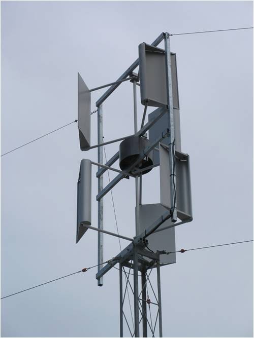

The subject of counter rotating VAWT was discussed on this forum quite some time ago as another way to increase the effective RPM of the alternator. Nothing was seen here since about that idea, perhaps you all had put it into the 'too hard' basket.
Well, not I, there was sufficient challenge in this so that I just had to tackle it .
For the VAWT I chose the Lenz2 design, I used the dimensions shown in the Lenz2 notes but instead of 3 full lenght wings I made 6 half size ones.
The counter rotating alternator was also an interesting project, I used the F&P I already had and it is not too hard to modify by anybody who has a lathe.
I wired it in the 7 phase arrangement with on board Schottky rectifiers and 2 slip rings.
Balancing the stator was not too difficult by using symmetrical wiring & rectifier placement, just a few small blobs of silastic in the deep plastic recesses on the back did the trick.
And did it work you ask? Unfortunately not with the F&P but it could be a goer with an AXFX alternator.
The 7 phase F&P has very little cogging drag but what it has was sufficient to spoil each wing assembly spinning up independently.
What happens is that in light winds the wings just rock back and forth, each preventing the other turning.
With an increase in wind either the upper or lower rotor will start turning, dragging the other one backwards. If the wind increased further still the backward turning unit would slow and stop before starting to counter rotate.
But by this time the wind gust had usually fizzled out
at my location.
Here is a picture of this project:
The plan now is to lower the tower and modify the Lenz2 for simple rotation with the 2 wing assemblies offset by 60 degrees on a common shaft through the F&P.
A single shaft would be easier to keep aligned too, with the counter rotating idea the 2 shafts & 6 bearings used required perfect alignment and a rather sturdy frame.
Now you all can cave a good laugh at my expense
fillm

Hi Klaus , all I can say is Well Done , I can see all the work that has gone into this and in theory it should work , have you tried twisting the poles to reduce the cogging .
At least you are having a go at something different , keep up the good work ..
Posted: 11:56am 20 Oct 2009
Thanks Phil.
No, the pole faces are straight not twisted, I felt the 7 phase conversion F&P should work for that idea as is. Actually, today we had a strong sea breeze and the thing did counter rotate for a short time and made the Amp meter needle move up the scale .
Having the the frame on a tilt up mast makes it easy to experiment with different alternators and building a small AxFx was always on my list. That size Lenz2 makes less than 100W according to its designer so the F&P is over sized for it anyway.

Posted: 03:23pm 31 Oct 2009
Thanks Dave, you were right ,a plan B is included with just about all my projects
Anyway, its up and running now, you can view it at the link below.
It was my first time to use my camera foe a movie, sorry about the poor quality - turn the sound low
Those guy wires are not horizontal BTW, just the camera angle makes them look so. I was glad to include the top guys, they are required when that thing gets hit by a strong wind gust.
